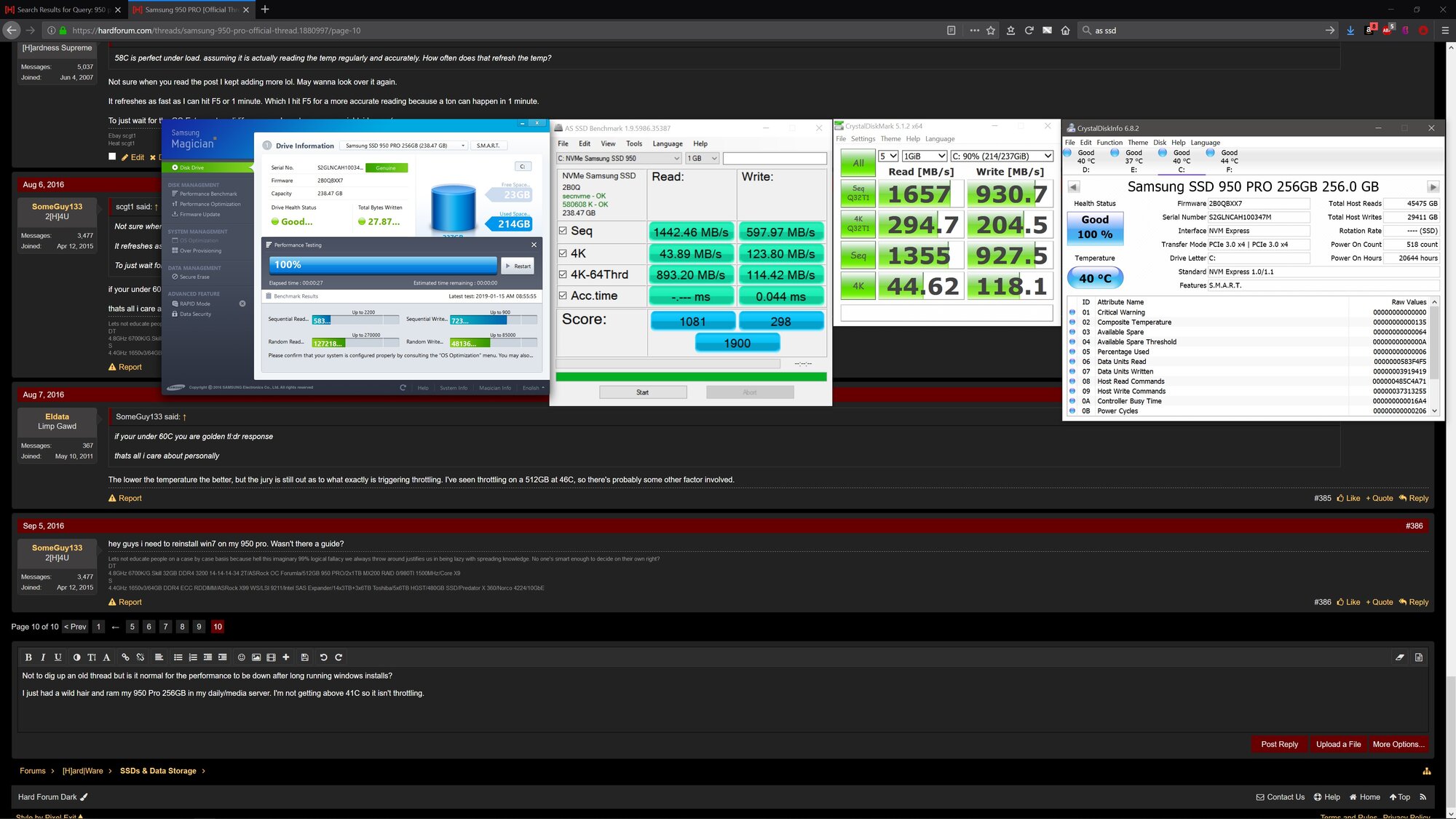

Not to dig up an old thread but is it normal for the performance to be down after long running windows installs or possibly because 25GB of free space?
I just had a wild hair and ran my 950 Pro 256GB in my daily/media server. I'm not getting above 41C so it isn't throttling.

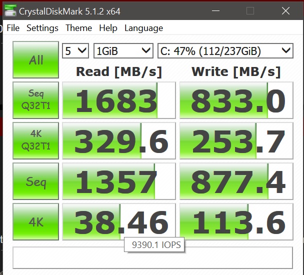

So I'm still stumped as to why my 256gb is not performing properly. I've even cleared space down to only 47% vs only having about 32gb remaining yet still getting about the same results since I tested back in Jan. I'll have an EX920 1TB here by Thursday so I'll be saying adios to the 950 Pro and it's degraded performance. I'm just wondering what is going on with it to be running like it is. LOL. Temps don't break 44C running CDM.
I'll upload my initial test once I got it working right a few years ago where it was pulling the advertised numbers.
Then the test from a few posts up done in Jan 19
and the test I just did which pretty much mirrors the Jan tests when it was nearly full.

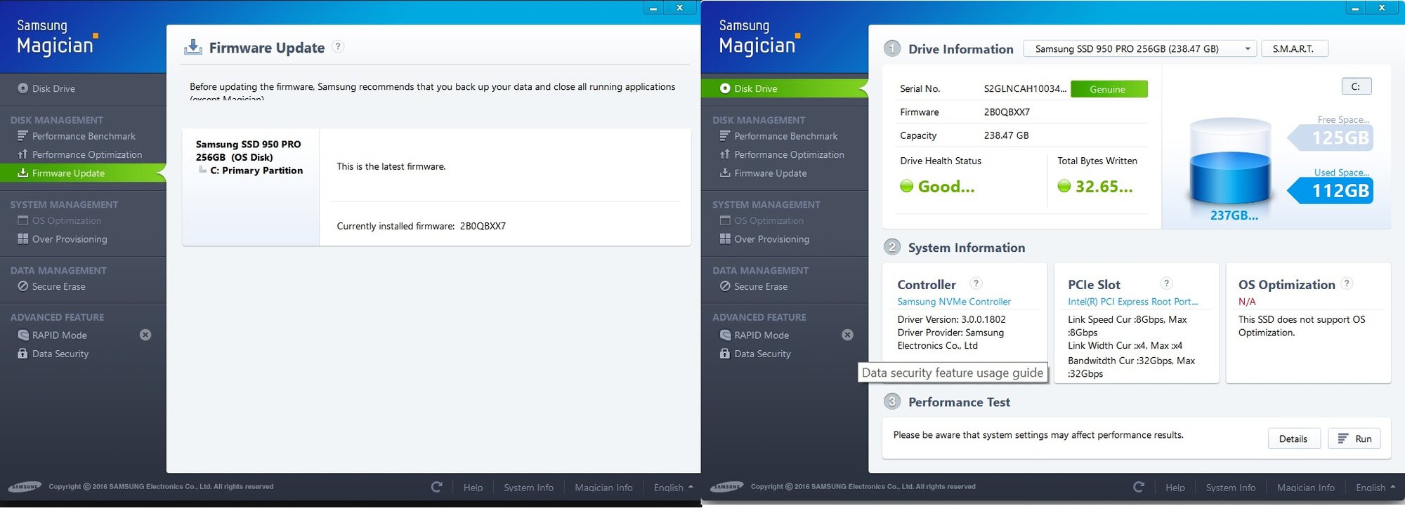

What's Samsung Magician say about driver/firmware/health?
Reactions: scgt1
All updated per Magician anyway and good status
Although looking on Samsung it isn't the newest Magician even though checking for an update says I have the newest so installing the newest now and verifying the fw/driver numbers also since the program lies. LOL
FW is correct. The new Magician doesn't report nvme driver version which is odd so I went digging under devices and it looks like the driver that windows sees for it is the windows one:
Driver provider: Microsoft
Driver Date: 6/21/06
Driver Version: 10.0.17763.1
Digital Signer: Microsoft Windows.
Going to try and replace the driver with the Sammy and see what happens. The old Magician and new one both show the Sammy driver. Little puzzled why windows shows the driver is the windows one.
The Samsung driver made a huge difference for me
Reactions: scgt1
Well it appears the Samsung driver is just an install program which I ran and restarted. Magician still shows sammy is the driver yet device manager shows Microsoft. Looking around I found an article I'm still going through but it mentions this:
"“the performance difference was due to the Microsoft NVMe driver creating FUA (Force Unit Access) I/O write commands. These FUA commands bypass the DRAM cache on the SSD and directly write to the flash, increasing the response time and also lowering bandwidth. For the same access traces, this situation does not happen with the Microsoft AHCI driver.”"
Which sounds like what is going on for me.
Well I don't get it. The post I was reading kinda lead to a dead end and doesn't mention anything or how to force windows itself to see the sammy driver.
Under Device Manager/Disk Drives/950 PRO is where it shows the Microsoft Driver I mentioned above but if I go to Storage Controllers the Samsung NVME driver is listed.
Well got it sorted for my daily with the 256gig it seems the damn thing was using a very old sammy driver 1.something when the new one is 3.1. Why Magician says everything is up to snuff and it wasn't......
Now I've double checked my game rigs 512gb 950 and it was also using the old 1. something driver so updated that and rebooted.
I think it's having issues with one of the numbers but it's hard to tell because the CDM's are different versions from my initial test to the current version.
is the old versions Seq the new versions 4KIB Q8T8? If so those numbers aren't even close from my original run 3 years ago. We are talking about 1,000pts difference between then and now. LOL
Well hell I dunno what's going on with it. Went to run CDM again this morning to snag a new screen shot of the bench for when I sell the drive since my EX920 1TB will be here today and the Following are lower then Tuesday:
Seq Q32 Read is 1410 vs 2070
Seq 1110 vs 1986
Everything else is virtually the same +- a few points. I don't know if the computer being up since making the post above back on Tuesday has anything to do with performance or not. The only thing that writes to this drive is what ever windows does along with browser cache etc. All my media etc is on my spinning drives.
Apparently the drive being up for 2 days was the culprit as it seems a fresh reboot yields an on para bench to Tuesday.
