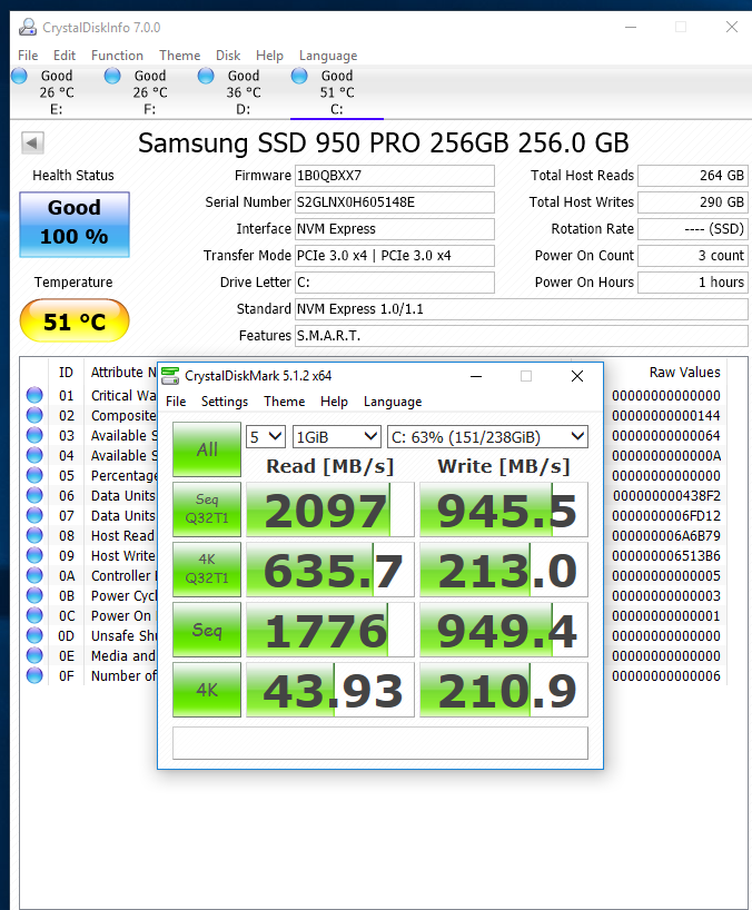

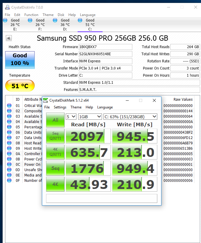

Hows this look? It's slower than a lot of the ones I've seen posted. I suppose that has to do with the drive size (256GB)
View attachment 4862 ?
Looks about right, but someone who knows better might be able to confirm. The 256gb drives are indeed slower than the 512gb drives. Your speeds look a bit better than mine (also 256gb) but I'm using a PCI-e adapter and only have PCI-e 2.0.
