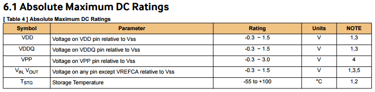

I looked this up and Intel states they won't certify over 1.5V so the assumption is that is the safe max. JDEC stated for certification DDR3 had to be able to handle up to 1.9V. I could not easily find JDEC standards for DDR4, only the comments from Intel for XMP.I don't know what the kits folks are getting from Corsair use for their ICs, or specifically which ones your TridentZs use (if the timings are equal across tCL-tRCD-tRP, probably Samsung), but this is the second review I've seen where they've pumped insane amounts of voltage through them without failure. I tried to find the other review (from a more well known site), it was linked somewhere in my "Buying Ryzen? Share your build" thread, but they are one of those that this guy mentioned, who managed even more.
In that review, he fed his TridentZs (with Sammy B-Dies) with 1.75v and others have used 1.9v on them (mind you, on Intel systems)! That was enough convincing for me to get those kind of modules for my Ryzen lol Glad I did, too, since they are what Ryzen like lol
However, here's straight from the horse's mouth that there B-dies should handle at least 1.5V (Vss = Ground, so all of these are "relative to Ground")
Seems rather unlikely they'd have fried from that voltage. Personally, I'd think it's way more likely that the ASRock board killed it (potential volt spike, or ripple from poor VRM design/components) than 1.35-1.4V being the cause, particularly given G.Skill's vetting process for ICs. Can always investigate the components used on the DIMM's VRM Circuit to determine their quality level. However, something else to ask: How old is your PSU, and what make/model is it?

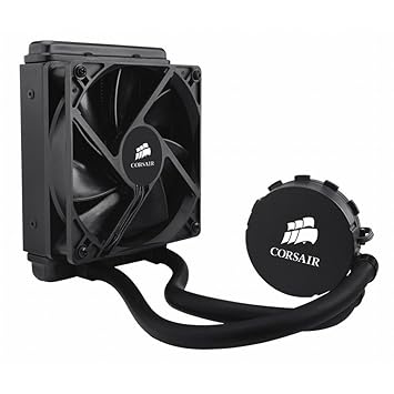

Is the bracket they sent you a square one, or a circular gear-shaped one?Ugh, bought an AM4 bracket for my Corsair H60 cooler from long ago (1st gen). Come to find out they made a 2nd gen H60 cooler and this bracket doesn't fit. Whatever, I'm fine with the stock cooler I guess.
Companies: Call your shit something else if it's incompatible with the old stuff.
If it's like the latter, I'm in need of that style... If you'd be interested in selling it...
I've been waiting, and waiting, and waiting for Asetek to get a shipment out to Thermaltake, but its still marked as "Coming Soon" *sigh*
It's the square one, that's compatible with the H60 2nd gen (top screws?) and not the 1st gen (side screws)
If it'd help you out I'd definitely do it though
Welp, it won't help me any if it's square lol But if CAD4466HK is upgrading to Ryzen....?It's the square one, that's compatible with the H60 2nd gen (top screws?) and not the 1st gen (side screws)

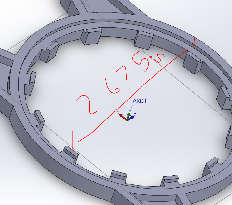

My money is on the Printer!! lolWill Corsair send me the AM4 bracket sooner than I 3D print it?
I have some pretty decent solidwork skills.
That's awesome. Would a 3d print be strong enough to use like this?
Awesome68mm. Should be the same.
*nods* And the adapter. lolAll you need is some 8-32 screws to screw it into the backplate.
That'd be swell, and fine by meI'm willing to make it for free, but I have to calibrate my printer first. Just got the printer yesterday and didn't have time to set it up.
