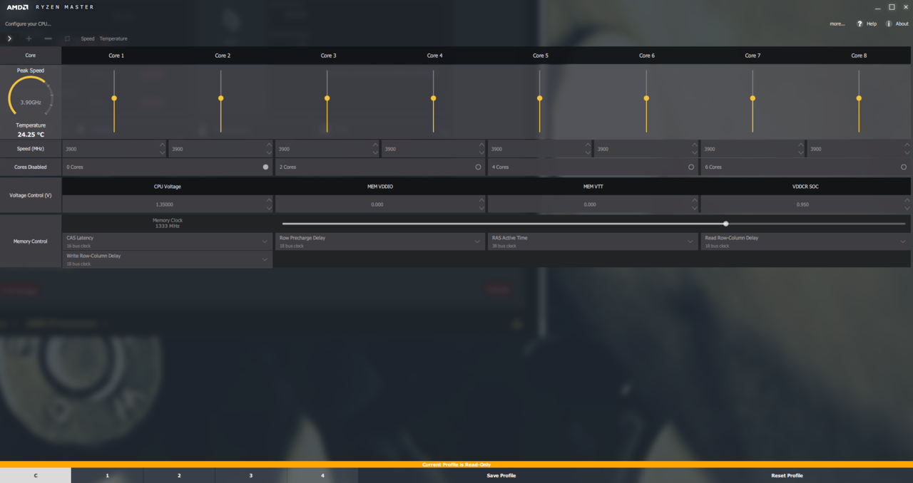

Ryzen master shows an idle temps of 50c and it went to 75 with prime95 stress testing.I use Ryzen Master. I'd expect it to be the most trustworthy considering it's from AMD.
My temps seem low. like way too low to the point where I think its broken.
above was taken a couple minutes after it came out of sleep.
Any thoughts?
What is SenseMi skew set to in BIOS? There is a 20° offset for 1700x and 1800x but it isnt used for the 1700. HWiNFO's tdie seems to be reading temps reliably right now.
