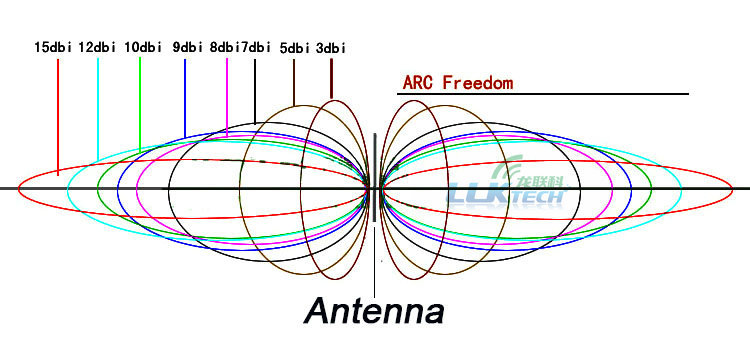

This is a great illustration of what happens when you attach a "high gain" antenna. Higher gain = higher directivity. It will go farther, but in a more focused pattern. So you lose overall coverage footprint but can get more signal at a specific point, if that makes sense.
That illustration is talking about a high gain directional antenna, not a high gain omni-directional antenna.
Borrowed from some other site, but this is probably a better representation of what getting higher gain OMNIDIRECTIONAL antennas does do your coverage:
This can be advantageous if you're wanting a bit more range on a horizontal plane... like a single story house / building.
The RT-AC68U comes with 3dbi gain antennas IIRC, so it could be fun to experiment. And that's if I'm not satisfied with the range of the stock antennas, I still haven't had a chance to test out in the far reaches of the back yard next to the pool. :D
Not to be pedantic, but if you have more gain, your beamwidth decreases, thus "narrowing" your coverage area. I don't think that image really conflicts with what I posted, looks like an elevation pattern as opposed to azimuthal. As you begin to have higher gain, you lose the omnidirectional pattern and become more directed by nature.
