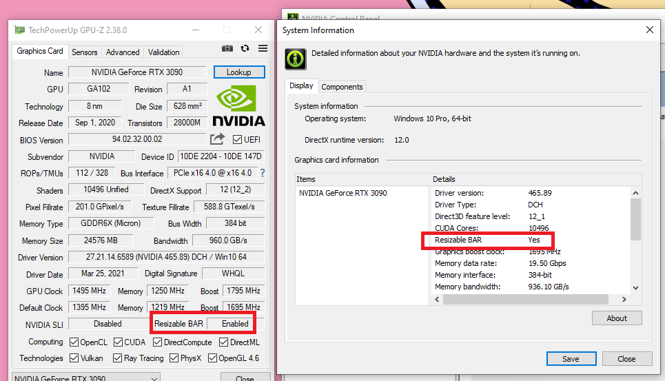

NVIDIA 3000-series Resizable BAR support is out.
Rizen
Jul 16, 2000
9,456
Resizable BAR support is out today for FE cards and a number of other vendors.
FE card firmware update tool is here: https://nvidia.custhelp.com/app/answers/detail/a_id/5165
VBIOS Update by Vendors:
You will also need to update your motherboard BIOS and go into the BIOS and enable Resizable BAR, if you have not done so already.
You also need the latest drivers, available here: https://www.nvidia.com/en-us/driver...&ranSiteID=TnL5HPStwNw-VAp5fczebSQL3GpFJhQKPw
I updated my 3090 FE, installed the drivers, and it's enabled and working:

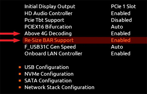

Maybe I'm missing something, but I installed the vBIOS and installed the latest nVidia driver, but it still says BAR support is not enabled. I looked in the motherboard BIOS for it and couldn't find anything.
Rizen
Jul 16, 2000
9,456
Has your motherboard been updated to a BIOS that supports it?
MavericK
Zero Cool
Sep 2, 2004
30,745
Yeah, it was added several iterations ago, and I just updated to the latest BIOS and still says disabled, though I am not sure if there's a setting somewhere in the BIOS that I am missing.
Rizen
Jul 16, 2000
9,456
Check these two settings and make sure they are enabled:
djoye
Aug 31, 2004
2,934
FYI for EVGA cards: There's a Re-BAR tab in PrecisionX1 where you need to update your card's BIOS.
When I installed the new PX1, it updated firmware automatically when launching PX1, or something(?), then I installed the new GPU driver. No ReBAR. Found a post on EVGA's forum showing that Re-BAR tab in PX1 that I ignored and updated again from there, problem solved. Gigabyte Z390 Aorus motherboard with F12l BIOS.
Edited for clarity.
