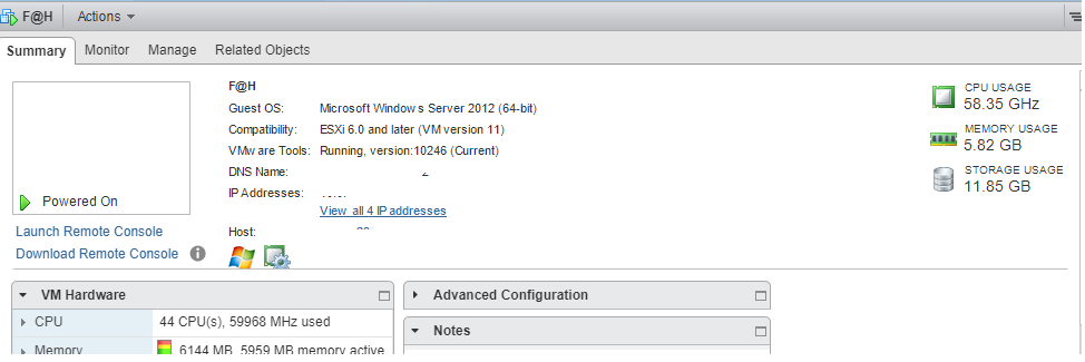

So far it's running. I got my VM moved over to the node. Hopefully, I can get some WU worth more points. Based on the PPD, it's only ~1500points higher than my previous 10core VM on L5638 xeon's

Pushed it with BOINC and F@H.. Was able to hit 58Ghz before it went offline :(
