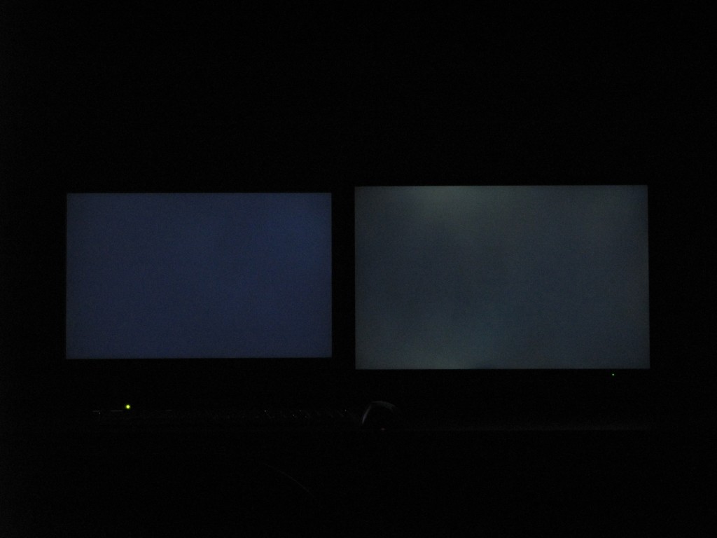

Anyway, I got a 23" Apple Cinema Display. They still have the faint vertical lines on aqua colors, but they're not as strong as they used to be, and it's certainly better than having horizontal lines that affect all colors. I often see horizontal lines used for effect such as the pinstripes in Mac OS X and the background of NewEgg's site. Even the background of BeHardware's site has horizontal lines. The NEC can't display those properly. The Apple can. I rarely see vertical lines used for the same purpose, and the lines on the Apple only affect aqua colors anyway, so it's not as big of a deal. Still, they shouldn't be there at all. I wonder what causes them. I can tell by looking at the screen that the NEC is horizontally polarized while the Apple is vertically polarized, which corresponds to the direction of the lines. I wonder if that has anything to do with it.
As expected, there was cloudy backlight bleeding, but then something unexpected happened. After a week, the backlight bleeding practically disappeared! That didn't happen on the ones I tried before, and it certainly hasn't happened with the NEC.
Here is a comparison of the Apple (left) vs. the NEC (right):
Maybe I'm just not understanding something. Can someone explain to me why that's acceptable on a color-critical monitor? NEC seems to think so.
I also noticed something very interesting. The new ones glow gray at an angle instead of orange and purple. I didn't expect that at all. It's the first time I've seen an IPS panel where black doesn't change hues at an angle. The NEC has better black viewing angles, but black turns red when looking from the right and green from every other angle.
Thats a very good question indeed! Since you have colorcomp for brightness and color uniformity, you can actually test this with less margine of error then other screens.
If a screen is calibrated to 0.3 cdm2 and the area with bleed is at 0.4 cdm2, I wonder if it effects any shade above 0.4 cdm2?
I hope you haven't returned the NEC yet. It would be interesting if you tested the effect your bleed have on the colors. :)
