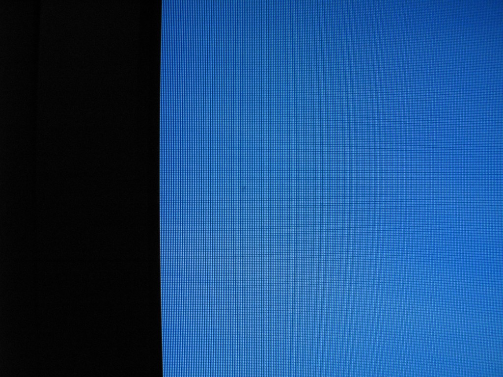

My 24" is defective. :( I keep getting a flickering line in the upper-left or upper-right corner of the screen.
Here are videos of the problem from two different computers:
http://www.toastyx.net/flicker.mp4
http://www.toastyx.net/flicker-pc.mp4
It figures. Right when I find a monitor I like, there has to be something wrong with it. The good news is NEC is sending a brand new replacement since it's still within 30 days, but knowing my luck, the replacement will have some other problem.

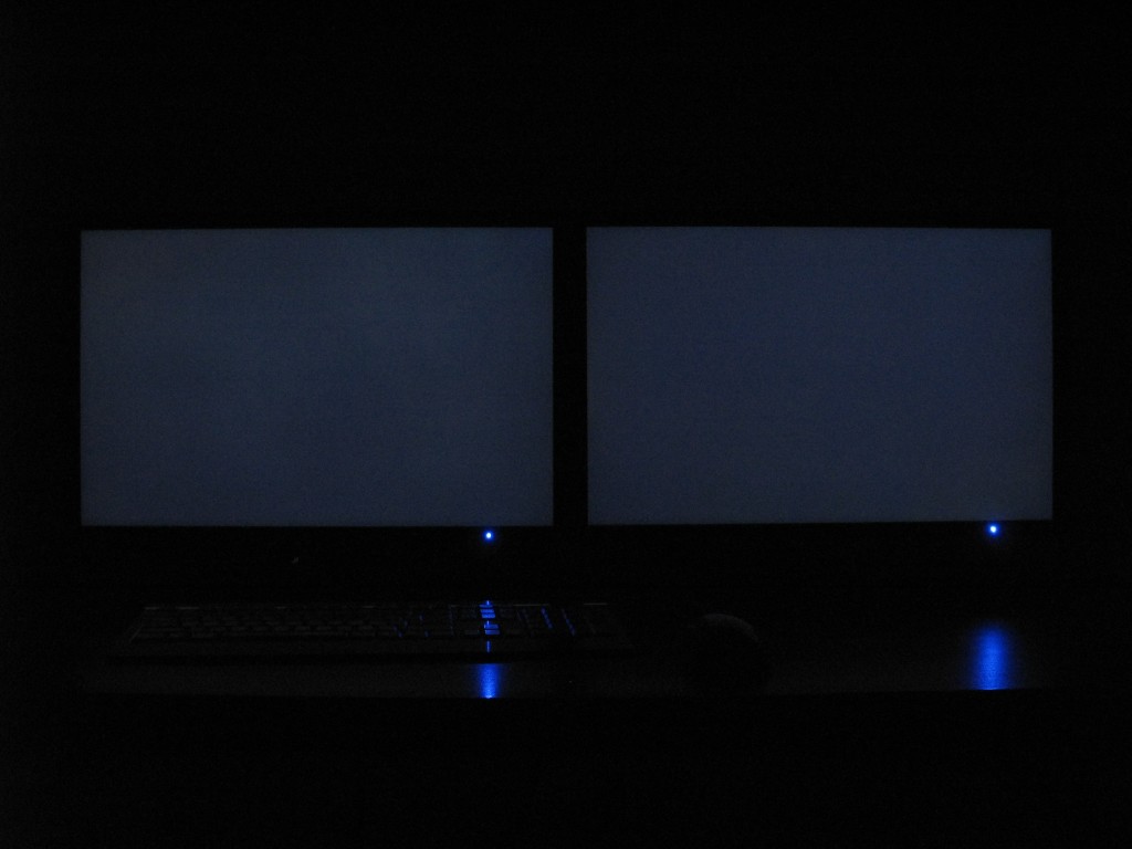

I received the replacement 24", and as expected, it has other problems. :D :D :D :(
The replacement has the same standby mode problem I saw on the 26". The original is revision 2C, serial number starting with 751. The replacement is revision 2B, serial number starting with 731, which is obviously older, so it seems the standby mode problem was fixed in a recent revision.
Now that I have two of these monitors, one with the problem and one without the problem, I can show them side by side.
Here is a video: http://www.toastyx.net/standby.mp4
The original (left) displays a "no signal" message and goes into standby mode a few seconds later. The replacement (right) displays an "out of range" message for 45 seconds and stays on.
That's not all. The replacement also has a small dark spot, like there's a piece of dirt embedded in the panel or something.
I immediately called NEC tech support about both problems. I also mentioned how I reported the standby mode problem on the 26" and sent it in for repair, but nothing was done about it. After speaking with a tech, they agreed to replace both monitors; however, they have no control over which revision I will receive. I'll see what happens when I get the replacements next week.
The good news is other than those problems, the replacement is just as good as the original. There are no faint lines like on the 26", and the colors are great out of the box. Both have good backlight uniformity:
The original is mostly uniform with only slight variations. The replacement is almost perfectly uniform except for the bottom right, but even that's barely visible. Both are better than my 26".
I hope third time's a charm because I'm really getting tired of swapping monitors.

With colorcomp off though, it is really not uniform. I notice people are using black screens to check for uniformity...you should try with a white screen too. What I find is that the top left corner is less bright and slightly bluish white and at the bottom right it is brighter and a yellow white. The colorcomp does a very good job of correcting it, but what I also found is that colorcomp is calibrated assuming the backlight is not dimmed. When the backlight is dimmer, the panel runs cooler and some of the corrects aren't quite right resulting in slightly brighter screen edges.
I think perfection is impossible and I have resigned to the fact I have as good as I am going to get.

It also has every other problem I mentioned before. It has the faint horizontal lines that are stronger on the left side of the screen for some reason, although they're not as strong as my first replacement. After seeing the lines on three different units as well as on a 26" Planar, I can only conclude that most monitors with the 26" LG H-IPS panel have the lines and that most people just don't see them. That seems to be the case with the 23" Apple. It also has a little more backlight bleeding than my first replacement, which is not so bad compared to the original or the 26" Planar I had. It also has the standby mode problem that I've mentioned several times already. That's three units with the same problems.
I just spotted a dead pixel too. This is getting ridiculous. Oh wait, there's a stuck green one too. Hooray!

Here is a backlight picture of my screen btw. The only light source is the leds in different hardware. I used two different ISO settings. These are of the ones that didn't turn blue. Shitty camera... :D Visually, black is totally uniform and as you can see, I've tried to capture digitally any variation of black here.
Click for larger version.
Backlight ISO 100 (exposure 2.72 seconds):
Backlight ISO 400:
Backlight ISO 400:
