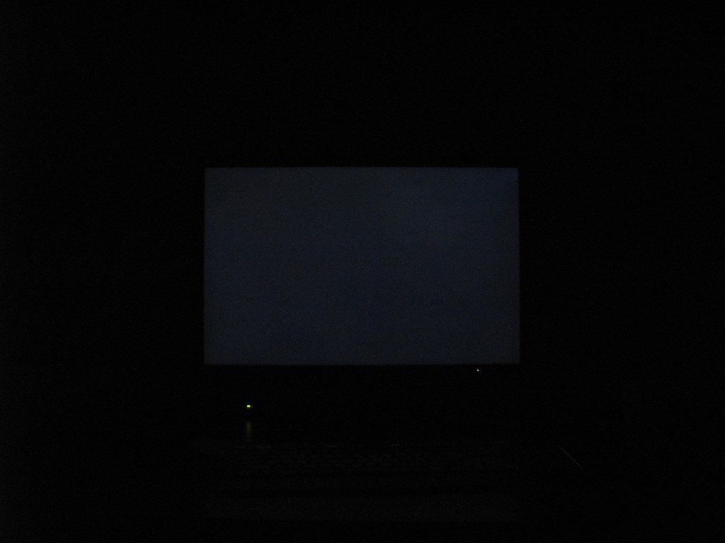

After trying the EIZO HD2441W and being very disappointed with it, I decided I might as well get the 24" NEC LCD2490WUXi and live with whatever problems it has. Well, it turns out I don't have to live with much because the 24" doesn't have most of the problems that the 26" has.
Faint horizontal lines - The 24" does not have any faint lines like the 26" has. The strange thing is I saw the same lines on the 26" Planar, which makes me wonder if this is a problem with the 26" panels.
Backlight bleeding - The 24" is mostly uniform with only slight variations:
Saturation - The 24" is not wide gamut, so the colors are not oversaturated. The 26" does not have an adequate way of reducing saturation. It can't be internally calibrated to sRGB, and the sRGB preset does not look right at all.
Noise - The 24" does not have the continuous cricket-like buzzing noise that I heard on the 26" when I put my ear up to the vents at the top, which makes me wonder if something was changed in a recent revision. I have revision 2C.
Input switching - The 24" does not "miss" the PlayStation 3 when switching inputs with the video detect option enabled, which makes me wonder if this was fixed in a recent firmware update.
Standby mode - The 24" does not have the standby mode problem on Macs like the 26" does, which makes me wonder if this was also fixed in a recent firmware update.
Checkerboard pixel patterns - The 24" does not have problems with checkerboard pixel patterns changing colors like the 26" does. I saw the same problem on the 26" Planar, which makes me wonder if this is a problem with the 26" panels. The pattern bleeding still happens, but that's an extremely minor problem that rarely occurs during normal use.
The only problems left are the tearing at 480p and the lag, which I expected anyway. The 24" exceeded my expectations. This is the kind of image quality I've been looking for. I'm very happy with the the 24".
I have two screens now without backlight bleed. I'll take some pictures before I deliver back the other one.
