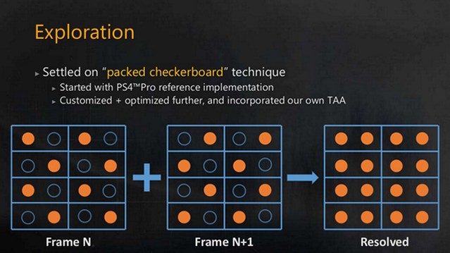

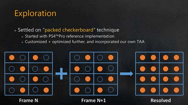

You need a true reconstruction technique like Checkerboard rendering (which is essentially what DLSS 2.0 is doing).
Hopefully people interested in DLSS, watched this excellent DLSS 2.0 video before, or are willing to become a NVidia devleoper to see it now.
https://developer.nvidia.com/gtc/2020/video/s22698
A better scaler can work on creating a cleaner edge, but it can't create detail that isn't there.
DLSS 2.0/Checkerboard rendering can reconstruct those details, as was explained in the DLSS video.
They aren't simply running at lower resolution and scaling. There is a lot of setup, including setting texture resolution to match the final output resolution.
Then you aren't running at a lower resolution with higher resolution textures, because that won't work either.
What you are doing is running a sparse grid of the final output resolution (Where the checkerboard name comes from).
Imagine it this way. I am running at full output resolution, but every second column is empty and unrendered (call these the Left pixels). That way I am only working on half the pixels. In the next frame I switch the columns and work on the Right pixels, and I combine the together, and I have full resolution, build from a sparse grid of the full resolution, and full resolution textures. When I am done everything is at full resolution.
That's the basic idea, but the implementation and sampling of sparse grid is much more complex...
Even with a better algorithm, scaling a low resolution image, can't compete with true reconstruction based on full resolution textures.
