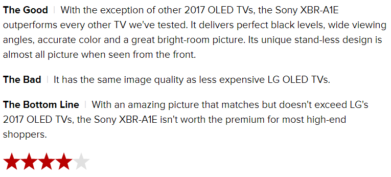

Comparing my 48CX to my 65A1e side by side, some pretty stark differences. The LG processing, while very good, starts to look bad when compared to the Sony. There's a punchy pop with images on the sony and colors look brighter. The highlights are brighter on the 48CX but the overall pop on the A1e is insane compared to 48cx. I have both calibrated with the i1display pro using pc. The tone-mapping and overall processing of the 3 year old Sony is insane. The nice thing about the sony is that its also gets regular updates, so youtube app supports HDR and whatnot. I still like the 48CX though, sit closer to it and use it as regular PC. Might switch to Sony 48" if that's ever released but for now going to play around with the settings to get the 48cx looking right.
I would be highly surprised if it wasn't the settings as those can obviously have a significant impact on "pop" and overall image quality.
When CNET reviewed the A1E, they didn't even find that it exceeded other OLEDs and that was 3 years ago...and panel tech has progressed since then. I'm sure the Sony has an amazing picture (like all OLEDs) but there shouldn't be a stark difference between two OLED panels and if anything I would expect the newer LG to surpass the older Sony.

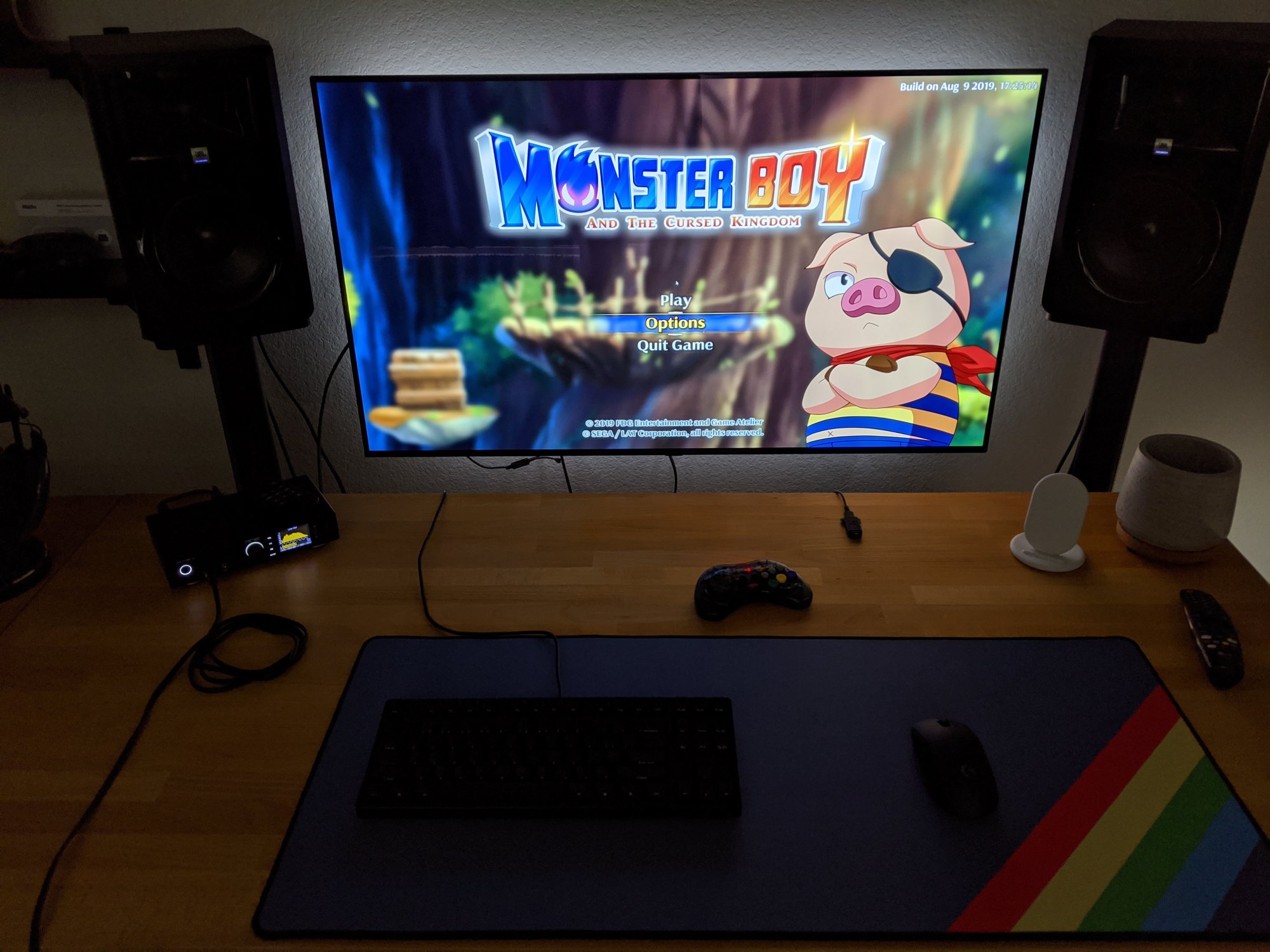

I thought I'd share how I set it up as a monitor as well.
There are two main problems to address with a monitor this size: viewing distance and display height. I already had my desk pushed away from the wall for my speakers, and here it serves me again. My eyes are ~48 inches/122 cm away from the display. As for the height, I have the display wall-mounted so the bottom edge is actually below my desk height. Maybe 3 inches or so below. This is key so that I don't have to move my head up, which causes strain. All in all this is so the display fits within a comfortable field of view.
I've mostly been using 1440p120Hz for now (until HDMI 2.1 GPUs), but 4K 100% scaling (GNOME/Windows) seems fine. I haven't messed too much with font rendering yet.
The picture quality is just incredible. OLED alone is such a significant improvement from the IPS/TN monitors I've used before.
I'm keeping SDR content (which is most of I'll be using it for) at 100 nits. I'll have to do some cable management later.
The A1e has received quite a bit of updates over the 3 years. In my first year of owning it, I absolutely hated it. Now its almost perfect imo, the only dislike is the mid 30s input lag, but I don't game on it so whatever. I calibrated both again and the A1e picture just has that little bit extra quality to it. It's by no means leagues apart, just better. I still like the 48CX but LG still has catching up to do in terms of processing. Also CNETs reviews are absolute useless trash.

Very nice setup, and the ambient lighting probably helps a lot. I don't have much space in my office so when I'm gaming I have to sit back with a lap keyboard and mouse tray, lol btw, you really don't find using Windows at 100 nits too dim?
I recently had a chance to look at a Sony LCD TV and was blown away by how washed out things appeared in evening now that I'm so used to OLED.
I keep my office pretty dark, which is the main reason for the bias lighting. It seems to make it more comfortable for viewing.
I used to do 120 nits on my previous monitors, but ~100 seems good to me. What do you use? I don't have a way to properly calibrate it yet, so I'm going off of other people's settings. I've been testing something similar to RTINGS' settings for now. On PC Mode + Game Mode I have the OLED Light at 28.
Gotcha. You own them both, so I'll take your word for it. LG has been great about pumping out updates, so there is probably a lot more to come there over the next couple of years.
I agree that CNET is hardly my first choice for tech reviews - it just happened to be near the top when I searched. Maybe a better link would be this one from rtings showing them to be neck and neck with minor point advantages to each. They really only dinged the C7 for not having BFI (which LG now does offer) and dinged the A1E on input lag. The C7 actually scored a higher rating for post-calibration and TV use with movie use being equal but they don't go into detail on that page about things like "pop" and vibrancy so I'll take your word that Sony has a slight edge when it comes to their image processing post-updates. But in my case it's a moot point because there is no equivalent 48" Sony and even if there was, it probably wouldn't match the LG as a BFGD. But I'm sure the A1E is awesome - it's an OLED, after all. I'm really surprised to hear that you hated it at first, though, and that updates could have such a profound impact. I know when I got my first OLED, I was absolutely blown away (and I came from a flagship Samsung quantum dot LCD set, so it wasn't a slouch but there was absolutely no comparison to anything I'd seen before).
