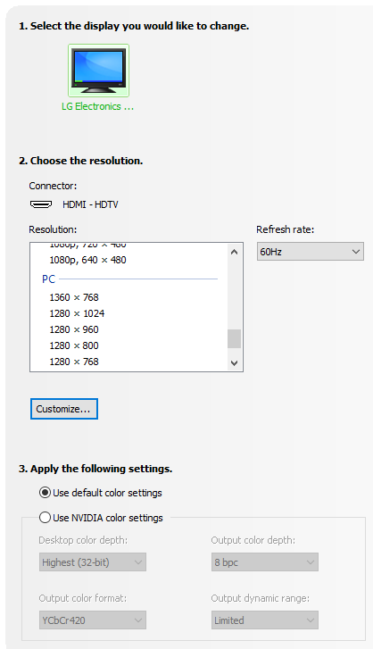

So, with HDMI HD Ultra Deep Color disabled, it only goes up to 1360x768:
I tried re-enabling HDMI HD UDC and - no green screen this time - and I was able to select higher resolutions and refresh rates, like you said.
I still seem to be unable to select 4:4:4 under 60Hz, though. Going to reboot and continue playing with it. 4:2:0 is definitely not as nice on the desktop as 4:4:4 was on my B7, but I can live with that until the 3080 Ti. Would be nice to be able to revert to 4:4:4 @ 60Hz in the meantime as an option. edit: fixed, thank you!

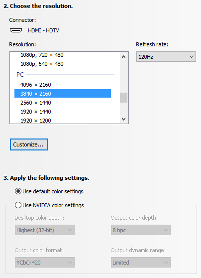

Is it just the screenshot, or have you not changed the #3 radio button to "Use NVIDIA color settings" to try change the color format yet?
I did, but the drop-down boxes only contained a single item (what you see there). But after playing with some more settings, I now have the additional options (only after going back up and selecting the other, native 3840x2160 resolution near the top <the one that only supports 60Hz>). Typical setup issues...it's been over 2.5 years since I've done this, so I'm a little rusty. :)
You need to go into the Home screen on the LG, select the setup icon (top right) and then on the HDMI port that you are connected to your PC, select it and you should get a drop down list of input types - scroll down until you see "PC". Select that. Then make sure in your Nvidia control panel that you have 3840-2160 selected, 60hz in the box to the right. Pull up this page and see if the bottom 2 lines of text are clear (this will tell you if you are indeed at 4:4:4 color space): https://www.rtings.com/images/test-materials/2017/chroma-444.png
Good luck!

Ok - just received and tested stuff for an hour with the CAC-1085 DP1.4 to HDMI2.1 adapter. At this point I CANNOT recommend this product. It's flawed running on my 2080TI and CX48. This is what i send to Club3d Support:
  • Everytime I change resolution or HDR on/off or change the color profile (bits, chroma or RGC) – the adapter looses signal. Only way to recover is pull the USB Power and put it back in;
  • Even when moving from in game back to windows (disabling HDR) e.g. in RDR2 – it looses signal;
  • When login into windows (switching from lock screen to desktop) it looses signal;
  • HDR increases the brightness of the entire panel;
  • I’m not able to run 4:4:4. Only 4:2:2 or RGB;
  • GSync is NOT supported;
  • Custom Resolution (36840x1600) is NOT supported. Black screen like before;
  • Custom Resolution (3440x1440) at 120 hz 1:1 is supported but only at 8-bit - and NO G-Sync.
Just switched back to HDMI - Text is better readable... there is something wrong with the full RGB / HDR that causes text to be fuzzy.

Seems you figured most of it out but here's for reference to others.
  1. Press the Home button, select the Home dashboard, click the gear icon, choose Edit, select PC icon for your chosen input. All the inputs are the same except HDMI 2 has eARC support so if you plan to use that, use the other inputs. HDMI 4 is poking out the back just so you will have a hard time using all the inputs when wall mounting. Thanks LG!
  2. Make sure Instant Game Response is enabled in the settings for your chosen HDMI input. If it is not enabled, G-Sync option goes missing at least for me.
  3. Select picture preset Game mode.
  4. Configure Game mode according to Rtings recommended settings.
  5. Open Windows display settings and make sure scaling is desired level (probably 100% or 125%) and HDR is off. Turn HDR on only when needed if a game cannot enable it on its own. Doom Eternal and Hitman 2 manage fine by themselves, others tend to need enabling HDR first in Display settings.
  6. Open NVCP and select either 3840x2160 (native) 60 Hz or in the PC resolutions section 3840x2160 120 Hz 4:2:0.
  7. Make sure you are using RGB and full dynamic range if you use the 60 Hz option.
