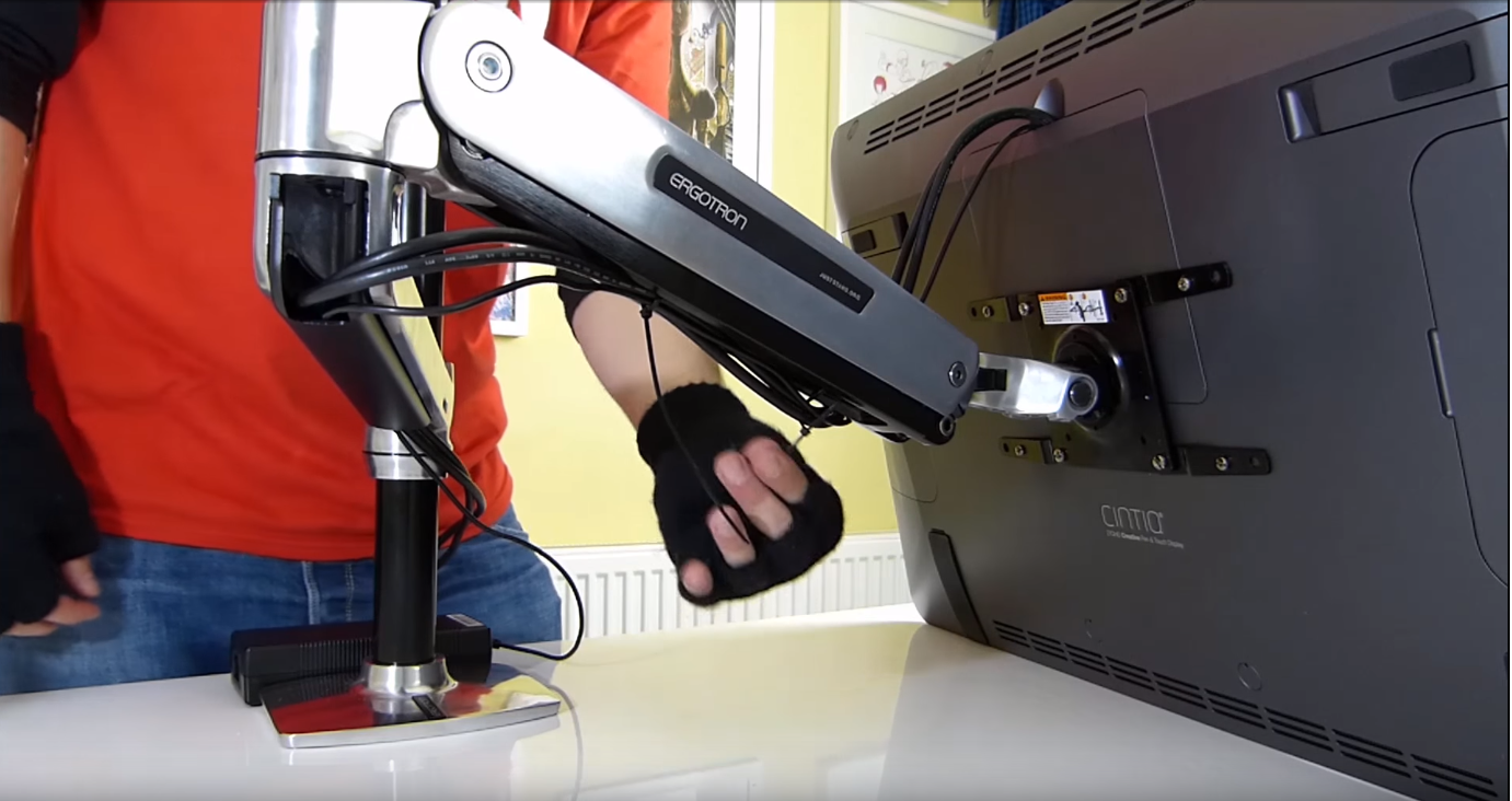

Another question for LG 48CX owners... are you using a custom mount on a desk - for height, swivel or aspect ratio adjustment? If so, what model are you using?
I was thinking about getting a Humanscale M8 or Ergotron HX as an arm for my sit/stand desk, but I'm still up in the air on what I should do as well. The arms should technically support it due to the lower weight of the 48".
kasakka
Aug 25, 2008
2,100
The KS8000 was a beast for its time. I still have my 55inch version in my loft. It was main TV till this week when it got replaced with a hisense 75h8g
Yeah it was good for its time and still works fine as my bedroom TV. It has plenty of flaws and the LG OLEDs are so much better on every metric except burn-in and stand.

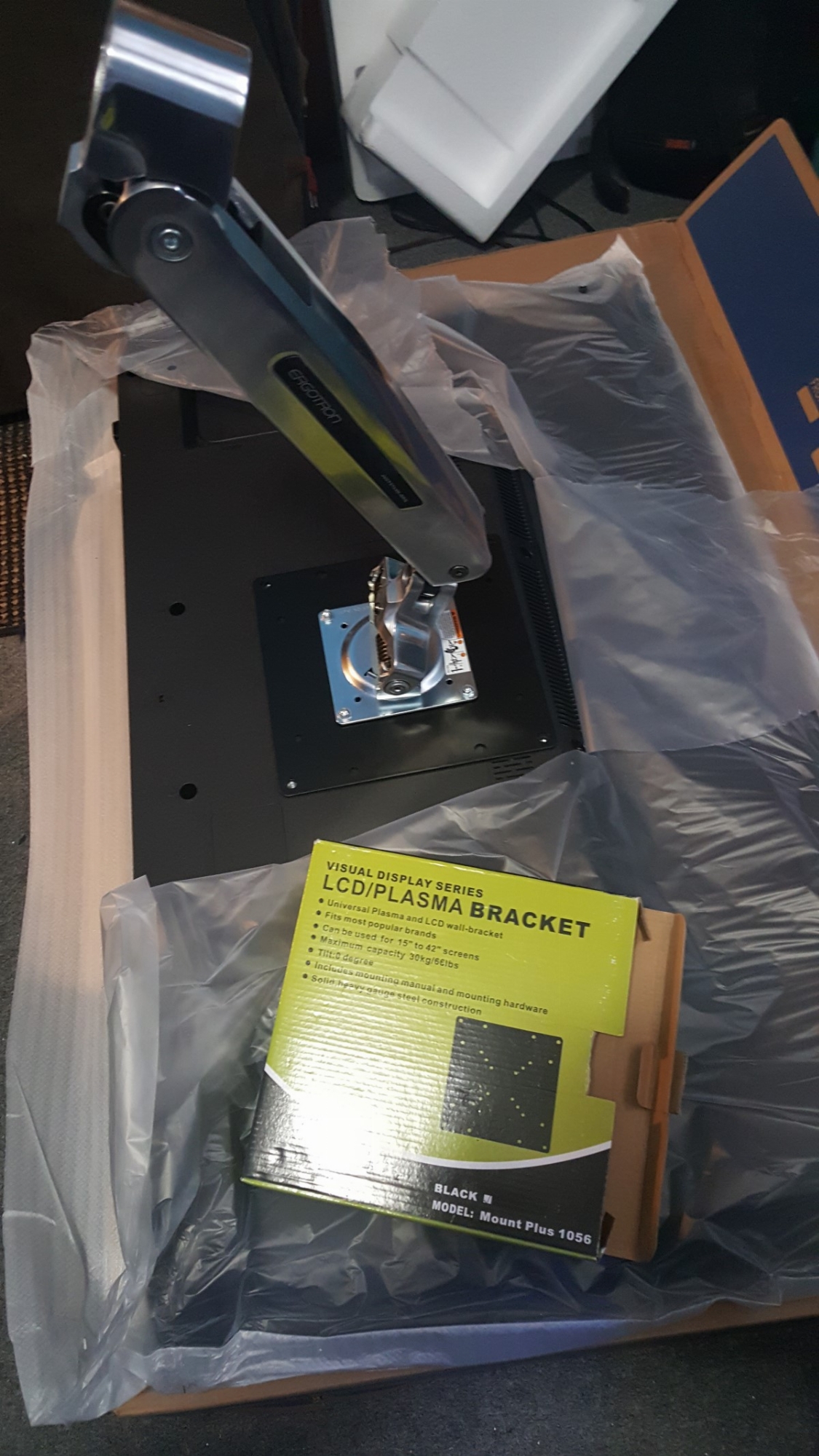

Hopefully getting my LG CX 48" in about 10 days. I have a Multibrackets HD arm that I was supposed to return but the small company where I bought it from is apparently bankrupt so I think I might be stuck with the monitor arm. So I am going to try to make it work with the LG CX instead as it's well within the weight limit. If I can fix the tilt portion to stay put it should be fine. I have a VESA 100x100 to 300x200 adapter plate ready as well as some HDMI 2.1 cables.
elvn
May 5, 2006
4,013

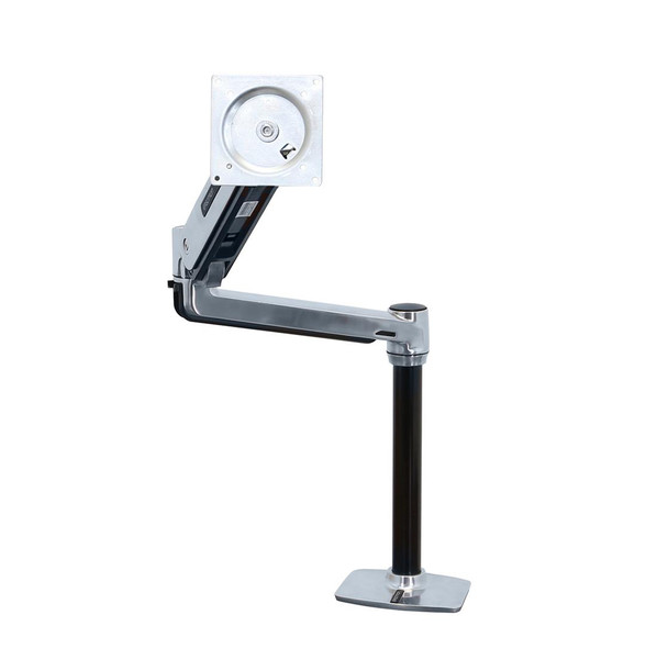

The ergotron LX HD should be able to. I have those on my 43" tvs. I still recommend you put it on a separate desk/bench to increase distance. So for some people a pillar style TV stand with a slim back would probably work out just as well. I'm not a fan of wall mounting because I like modularity in case I want to move things or change things, or use it somewhere else later on.
There are a few options from ergotron kasakka and I were talking about a little earlier in this thread same thread:

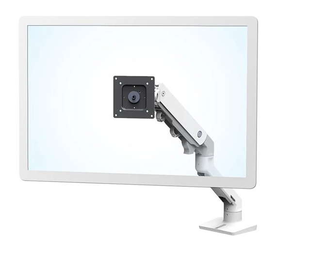

The HX arm seems smaller they do say they support up to 41 Lbs so would be a more sure bet weight wise. They go for around $265 + tax so are in the same ballpark as the ergotron LX HD ones. I think they are smaller but made a lot stronger to 41 LB probably so that they're capable of having a dual LCD bracket on them to support two smaller lcds from what I've seen in some of the pictures/models of the ergotron HX.
The ergotron LX HD I have are only spec'd to 30 LB but I'm pretty confident that they would be able to hold the LG 48" CX 's 14.9 kg ~ 32.84888 Lbs.without stand once I tighten all the fittings with the allen wrench. Will have to see to be certain of course. Otherwise one of those flat belt post floor stands for my scenario. For a standing desk you'd have to make sure of the max weight and what ease the lifting mechanism has under heavy weight.
48" CX is 32.8 LB.
ergotron LX HD is 17.5 LB.
ergotron HX's shipping weight is around the same ~ 17.6 LB.
So the standing desk would have around 50 LB on it just counting the TV~ monitor and one of the heavy duty arms. That doesn't take into consideration any other peripherals on the desk and your own hands/arms weight resting and pushing peripherals around on it.
The ergotron LX HD on a cintiq 27" art/drawing screen showcased in an install video from lawrencecandraw on youtube:
Me installing the arm on one of my 43" 4k VA tvs-as-monitors. It came with some vesa extension "wing" arms that connected from the main arm's vesa holes to make a metal "X" but I had that plasma adapter plate so I used that instead.
Example showing the ergotron LX HD which uses a pole style arm for greater height options:
Example showing the ergotron HX's shorter arm style since it doesn't use a pole. You would have to make certain of the clearance and if it fit it probably wouldn't be much above the top of desk and wouldn't allow much vertical wiggle room.

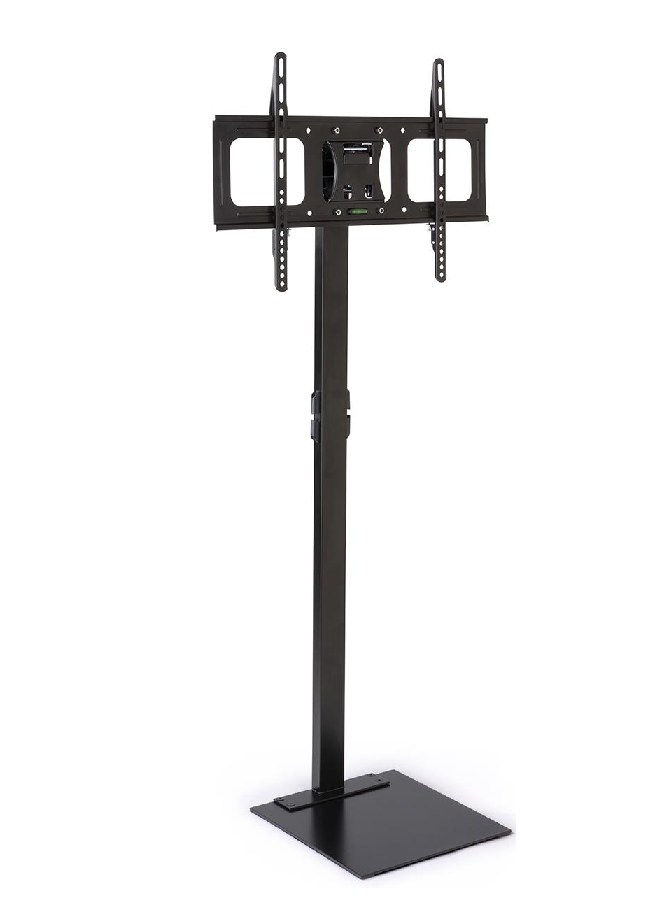

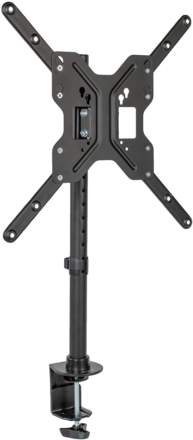

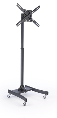

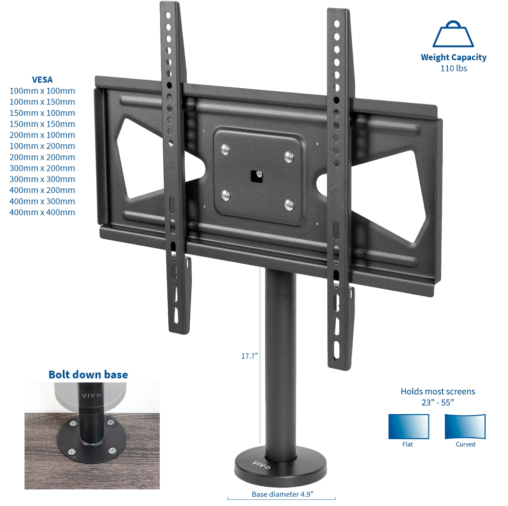

Some examples of floor TV stands with flat belt style pillars that would keep the monitor height and adjustments separate from a desk. I think these kinds of stand require hands on for loosening and re-tightening of the extension pole when adjusting the height.
For a standing desk you might be better off just mounting a short 3rd party TV stand with some tilt and swivel capability directly to the desk surface.
Thanks for the details. Yea, that's why I've been hesitating for a long time on this. Do you think a normal stand that isn't fixed would be too unstable when lowering or raising the desk? Something similar to this.
