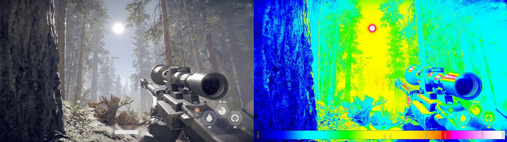

HDR Color temperature map based on HDR 10,000 in a game.
You can see that the brighter parts of the scene are mostly 100nit, 150nit until you get to the sun (10,000nit), the sun's corona and the glint of the sun off of the rifle's scope and barrel which are in the 1,000nit range and a little higher on the brightest part of the scope's glint to 4000nit. I'd expect everything above the SDR range in the scene would be tone mapped down in relation to the peak colors (peak color brightnesses or luminances) the OLED or FALD LCD are capable of. That is, rather than scaling the whole scene down in direct ratio and making the SDR range darker which would look horrible.

Most of the highest brightness HDR content is highlights in dynamic scenes but there can also be very bright light sources in a scene(the sun, the energy from a sci-fi ship's propulsion system or a reactor, etc). Those are usually moving as well though. ABL is worst when you are moving closer to a light source so that it is gradually filling the screen larger with it's bright area as if you are zooming in on it, to the point where the ABL kicks on (and off depending how you or the camera are moving). From what I've seen it's a worthwhile trade-off... almost like you are wearing instantaneous photochromic prescription lenses (aka "transition" lenses, the kind that darken). It's not optimal but if it prevents permanent burn-in it's a welcome feature and trade-off to me until something better comes along.
