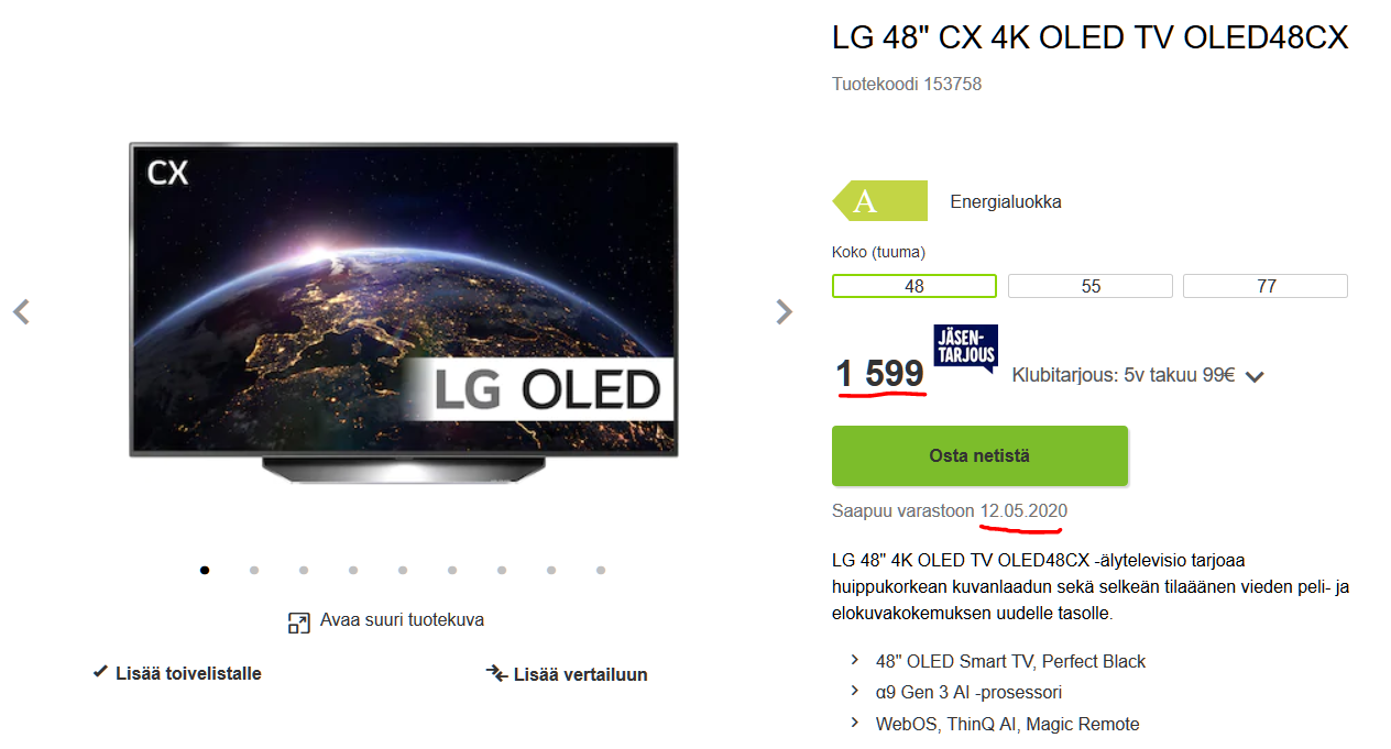

kasakka
Aug 25, 2008
1,446
Starting prices in Finland: 1599€ (including 24% VAT)
Available 12.5.2020
Dang, that's lower than I expected. Very tempted to order one now.

MaZa
Sep 21, 2008
2,855
Available 12.5.2020
Damn, that is expensive, especially considering we can get last year models for less than that, at 55" size mind you.
But as of this moment my plans for desktop OLED are on hold because I got a good deal on Samsung S34J550 ultrawide, which was overclockable to 96hz. Slow as molasses pixel response time but picture quality is good and this was one of the few PC VA panel monitors with contrast ratio above 4000:1. Maybe 48" OLED will find its way on my desktop but now the actual living room TV is a priority, that will be changed into OLED the next Black friday.

Nordlands
Apr 3, 2020
1
Available 12.5.2020
Found it at the same chain website in Norway, and have put in my order to receive it by mid-May.
A bit more reasonable here at 15990 NOK = 1397 EUR at present exchange (incl. 25% VAT). It seems like LG set the prices in different currencies before the most recent fluctuations, as in January 15990 NOK was worth more than 1599 EUR.
