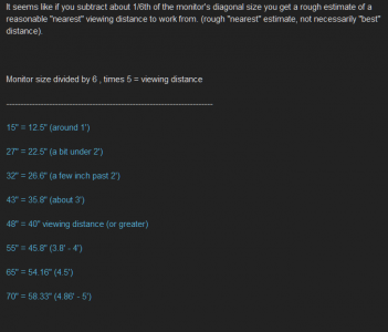

55"? Man you'd have to sit like atleast 5' back...
My eyes are 3.5 feet from this 55" q80 that I'm using until my cx 48 comes in.
I have to lean back and look up to see the top of the screen. It would be a little better if I wall mounted it and dropped it to keyboard level.
With a wall mount and scooting the desk back a bit. It would be fine.
I don't think I will have to scoot my desk back with the cx48 after I wall mount it.
I would definitely recommend the 48". The height difference is almost 3.5" less.
