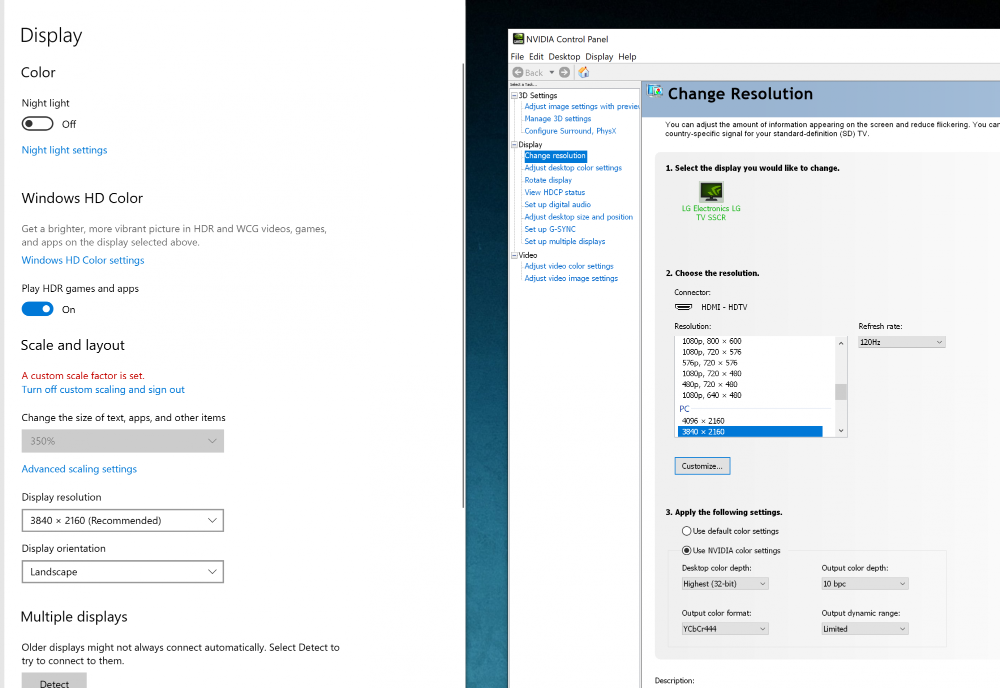

Just go my CX48 and it's defaulting to 350% in the "change the size of text, apps, and other items." At this scaling, txt is super sharp but way too big. However, if I drop it down to anything less, I can start to notices some fuzziness around the txt. What is everyone running at?
1. Make sure you are running 444/RGB chroma with the latest firmware update. Older firmware downsampled to 422 (At 120Hz, 60Hz is fine).
2. Make sure you have screenshift disabled.
3. Make sure you have the input labeled as PC in order for text to display properly.
Done all that. Why is it so huge?
EDIT - Turning off quickmode fixed it.
You'll have to sign out of windows after changing the scaling value for it to take effect. If you still have fuzzy text after doing all the above then I'm not sure what to do after that. You could try toggling screenshift on and then back off as it's been bugged for a while now.

I still don't understand why it keeps going from clean no scaling factor to red txt saying I'm using a custom scaling factor and the txt starts to get blurry. Something in the startup causes that - nvcp?

What font size scale are you running? 100%?150%?

I've calculated the formula for the HDR / SDR brightness balance slider in Windows.
Code:
Slider Value = ((Target Nits * 1000 / 80 ) - 1000) * 100 / 5000
A slider value of 10 is 120 nits. From the TFTCentral review, an OLED Light value of 36 on the TV in SDR mode is approximately 120 nits.
