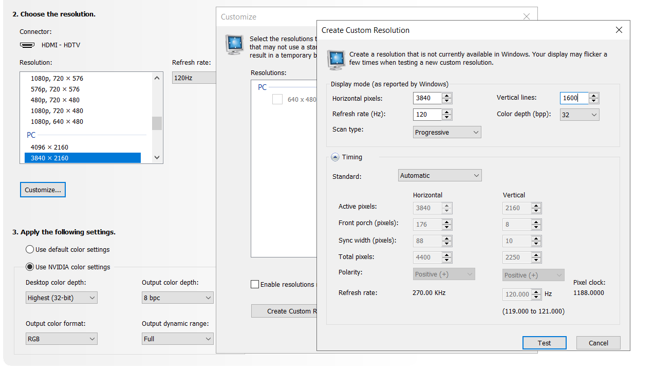

Anyone got 3840x1600 resolution working with 120Hz? If so what settings are you using? I want to run it for some specific games but I just get no signal when clicking Test.
For me these exact settings work perfectly fine for adding 3840x1600 @ 120 Hz using the Club3D adapter. I would wait for firmware or driver fixes. Setting the desktop to that resolution tends to drop it out of HDR though but you can get 3840x1600 and HDR working together in games just fine.
[/QUOT
Then it should work with HDMI 2.1 also? I'm running 8bit(chroma subsampling issue with 10bit) and without HDR.
Yes it should, no idea why you get a blank screen. Also chroma subsampling issue exists at 8-bit too. Basically any 100-120 Hz resolution except 1440p has the problem. 8 vs 10 bit does not matter.
Guess I'll wait for the new firmware and new Nvidia drivers then. When running with 8bit instead of 10 text does look better for me in Windows right now.
This is the exact same thing I am fighting. Not interested in running the display at 3840x2160 until PS5 comes. I want 3840x1600@120hz full time during PC gaming. I ordered a Club3D adapter to test with my 2080 Ti and 3080 but I am sure things will change (hopefully for the better) when the CX firmware fixes start hitting!
