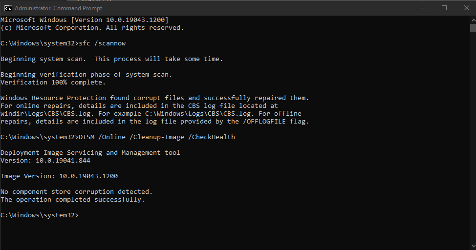

I ran both commands:
OK well TBH that first command says you did seem to have some corruption issues. This could be caused by a corrupted installer, or some sort of hardware error that caused issues during installation. Reboot and run SFC again, see if it still says it found problems. If it doesnt, go ahead and install the regular nvidia driver and try setting the HPET setting to false again, and get any other changes you made set back to "normal". Otherwise you may have an issue with some piece of hardware, can you try a different USB stick/ISO for installation? As far as ubuntu goes, its just a different OS to try, it would completely rule out any windows nonsense, and it would give you the oppurtunity to test a completely different driver (Nouveau vs official nvidia), you would install it just to test things out with, afterwards you can switch back to windows.
Running the sfc command after rebooting, showed nothing

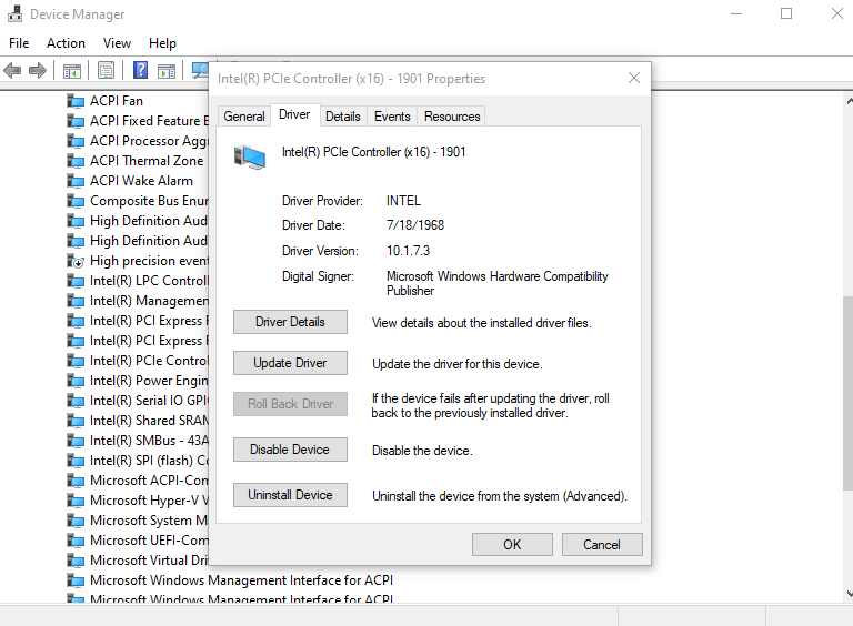

Why is this driver so old? are these even downloadable? I couldn't find it on the internet

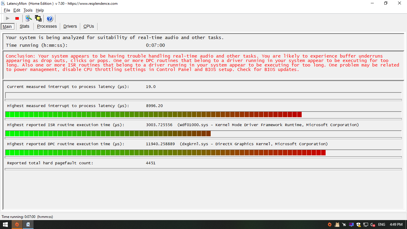

I completely disabled the sound and ran battlefield V, here's what LatencyMon shows:
That wdf01000.sys wouldn't spike like this while windows was idle, I thought that it has no problem
but after a game, it also spiked

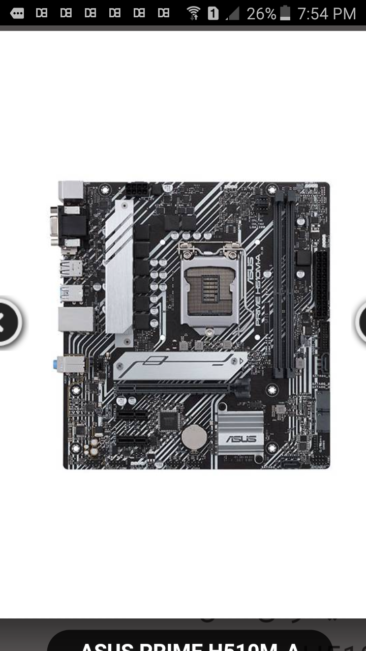

What motherboard do you suggest from Asus? you were saying that Asus is better right, so I think I should be thinking about changing my mobo if I can, I'm not sure though, I can't buy the top ones, but I've seen boards like PRIME H510M-A or M-E, M-D
is that model good? what do M-A and M-E and M-D mean?

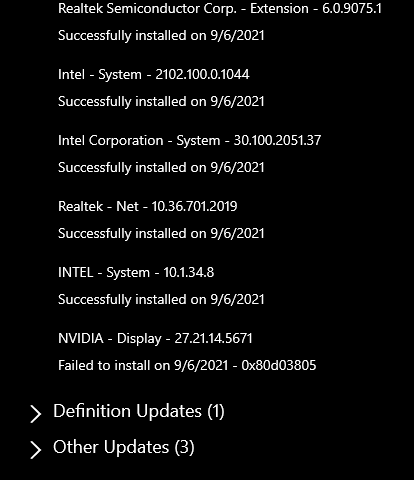

ok I'm now in the normal state, I've installed gpu driver, then updated windows, then installed LAN and INF drivers though windows has also installed a bunch of other drivers as well, then I remembered to run sfc /scannow 😬
The latency is exactly as before and I didn't run any commands yet, I didn't touch the power plan and power management in 3D settings as well

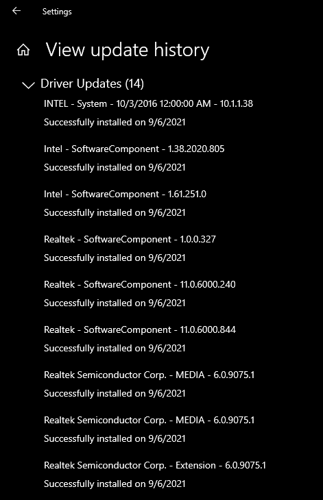

the installed drivers with windows update:
OK, thats fine. Basically everything you did should have worked, we can pretty much prove that because you re-did everything and confirmed the software was working as it should be (no corruption, windows updates, good drivers etc.) that your issues lie with your specific motherboard. Did you purchase this used or from a store? If you bought it from a store, I would contact them and ask to have the board replaced. Alternatively if you have a local PC repair shop around, call them and explain the situation, they may let you come in and use one of their boards, or let you put your CPU in one of their LGA1200 machines (also a good option) to confirm it isnt an issue with the CPU. As far as brands/boards go, I would say ASUS/ASrock are the best options on the market. Basically any board that ASUS offers is going to be really well made and stable, and ASRock typically has good quality/features for a good price.

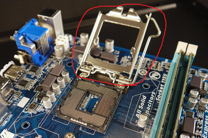

One last thing that I can think to try is simply taking your CPU out, very gently blowing on the motherboard socket/CPU underside (its for luck, think N64 cartridge) and then re-installing the CPU. Maybe you had a bad seat on it the first time, maybe a bit of dust got on the contact pads, maybe youll notice a single bent pin in the socket (which would 100% be your problem).
Reseating the CPU would be a good idea. While you're at it, take a picture of the socket.
The date on the Intel drivers is stored in a different format that Windows is not converting.
I would overwrite the drivers Windows installed with the drivers on your motherboard's support page. Install all the newest drivers that are listed here. The Intel INF and serial I/O drivers are extremely important. Don't worry about the VGA driver if you disabled the iGPU, or any of the utilities. Some of the version numbers may look the same, but trust me that it could make a difference.

One thing that I should mention is that when I placed the CPU in its socket, then when I wanted to bring down this thing (I don't know what to call it due to my poor English)
it fell down and hit the top of the CPU 😬
then I booted up and I didn't have any picture on my screen, no signal, then I opened the case and reseat the CPU again, but I didn't have any picture again, it wasn't the CPU, it was my poor HDMI cable, I unintentionally touched it and the screen was back for 1 second and then went to no signal, that's how I found it's the cable, and I bought a better one as well, so yeah I just wanted to say that I've reseated the CPU before, but I guess I'm going to do it one more time :s
That bit that you circled is called a "retention bracket", essentially just a square metal bracket that retains the CPU in the correct spot. You wont be able to find anyone who can repair the board (aside from gigabyte), no shop is going to diagnose/fix this down to the SMD level, or worse if the issue is in the traces on the internal layers of the PCB. The problem with your motherboard isnt DPC latency, or low FPS, those are just symptoms. The problem is some component on your motherboard itself that is malfunctioning, and you would need some specialty tools and experience to be able to diagnose the issue, almost no shop would have that, and if they did, they certainly dont let people walk in and use it :D
The benefit of going to a shop/repair place is in using their known-working equipment to test yours with. If you swap all of your components onto one of their boards, and you dont have a problem, then you can safely assume the issue is with your specific motherboard. If you know of a friendly shop, try asking when theyre least busy times are, maybe ask if they need any boxes of stuff gone through/organized (maybe ask if they like coffee, and what kind!). Lots of places in my area have back rooms filled to the brim with "stuff" but no time/people to even do a quick inventory, maybe you can spend an hour or two seperating USB and ethernet cables in exchange for them letting you use their space/gear. Though at this point even if you do run the tests and confirm it is your board, you are still in exactly the same spot you are in now, hoping for an RMA.

Asus H510M A seems kinda nice "if I'd have the money for it", I might not be able to buy another mobo, I'm not sure, I should see how it goes
but I just want to know which mobo should I consider next
The ASUS H510M-A seems a bit pricey to me, though ASUS boards are on the expensive side to begin with, it would be a good board if its within your budget. The ASRock B560M Pro4 sems to be a little cheaper and has a 2nd PCIe X16 slot which would have been nice to have on the gigabyte board for troubleshooting purposes. The 460 chipset appears to support 10th gen CPUs, so i think you could also look into an older gen of board (I could be wrong, im still on 3rd gen) but you may lose out on the ability to upgrade to 11th gen CPUs unless you get the 500 series board.
