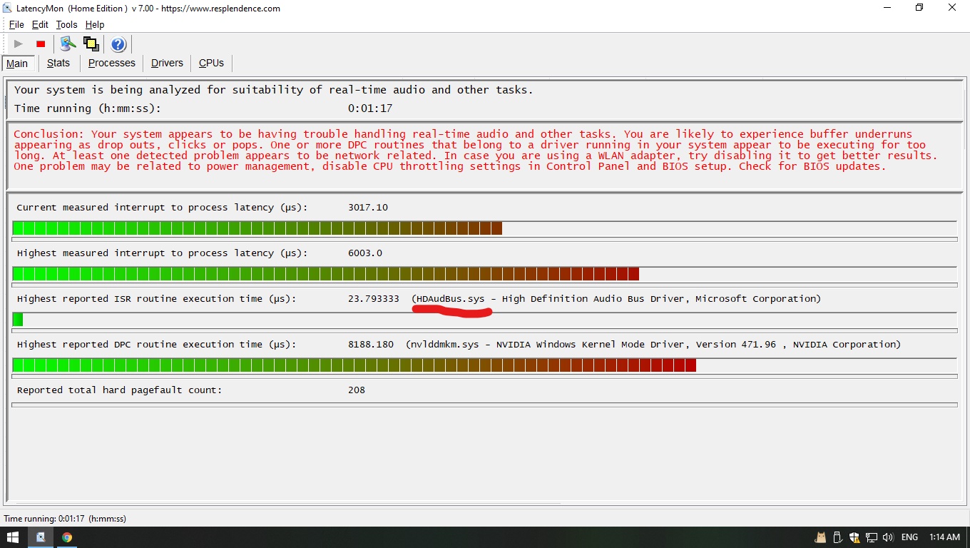

Welcome to Nvidia driver audio latency hell. You mentioned the audio crackling doesn't happen with headphones-try entirely disabling the Nvidia HDMI Audio in Device Manager and check DPC latency and performance again.
I disabled the Nvidia High Definition Audio and tested the game again, but no the FPS was still low

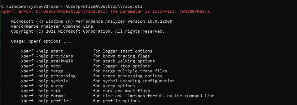

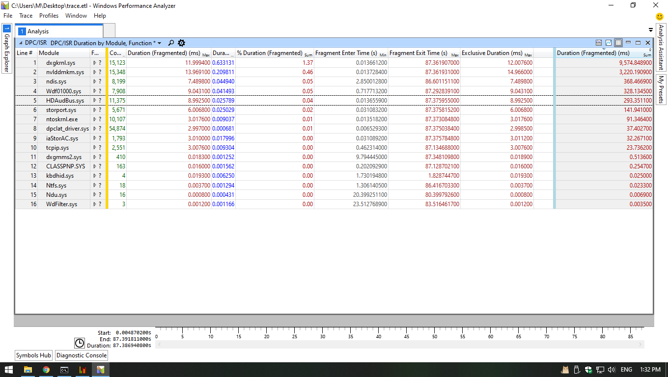

I'm doing the steps, but I get an error when I reach the cmd part, for the third command:
The stats when I run Stronghold Warlords:
Replace xperf with wpa for that command.

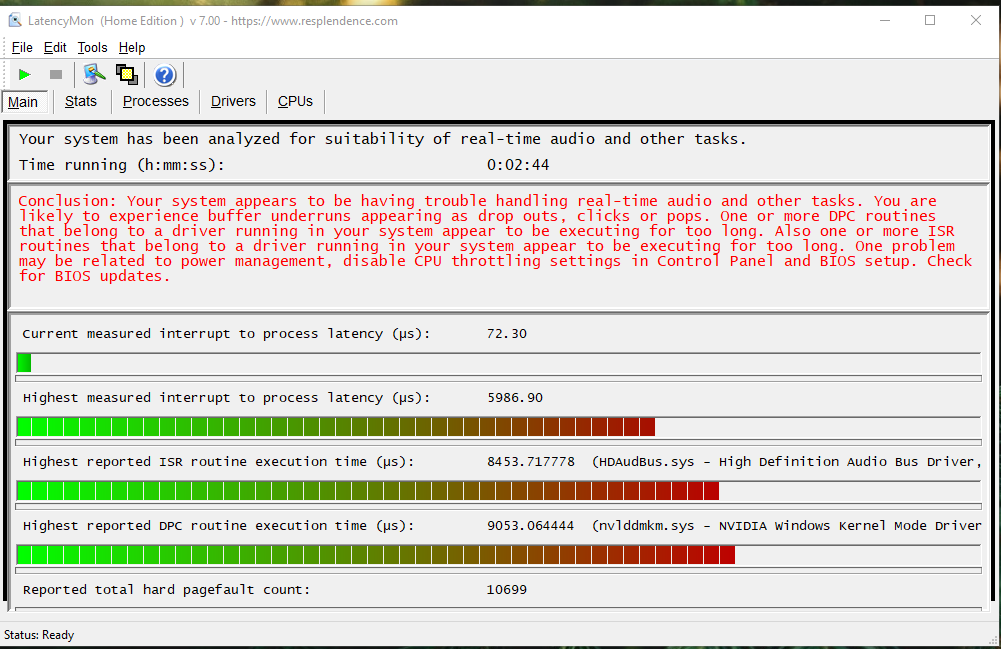

So the software issue might be the DPC Latency issue that I have, based on the image that I replied above, it shows that some of those .sys files have high latencies, and I did some research on them, and I did some of their suggestions like rolling back to windows 10 1703 build which is very old, and I even tried that, also rolling back the graphics driver to something below version 390, and that one didn't fix it either, I would open dpc latency app and there were always yellow and red bars, yellow bars when pc was idle, and red when I was running games

The main issue is this DPC latency issue, I'm 95% sure it is, because it is really similar to those who have DPC latency issues, I saw this post, which he says that he would get 100 fps in COD Warzone, but after this latency issue, he's getting 10~15 fps, he fixed it by CMOS resetting, because his RAM speed was misconfigured:
https://linustechtips.com/topic/122...krnlsys/page/2/?tab=comments#comment-14970086
I tried that as well but it didn't work for me, and there's also another suggestion to check the IRQ to see if the GPU is being shared with a USB or something, but mine is OK I think:

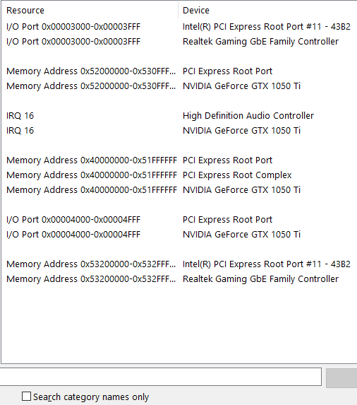

If we are getting down to IRQ assignments, we may as well explore some other "out there" ideas. Is it possible to move this card to a different PCIe slot? Does your BIOS have the option for "shared memory" or somthing related to reserving system RAM for the iGPU? If so, disable that. I dont think this is the issue, but you could look into your IOMMU groupings and see if your card is sharing space with somthing like a USB controller. Can you disable all the onboard hardware in BIOS? Im talking:

I have H510M S2H rev 1
and i3 10100F
I think my bios is so limited, it doesn't have any options related to GPU, even in advanced mode, there's really nothing related to GPU in there, I can't even test most of the BIOS configurations which are suggested on the internet because I don't even have those in my BIOS
I found some of the onboard harwares as well, I couldn't disable SATA because I think I would not be able to boot, because I have my windows installed on it, disabling LAN, audio, and other stuff didn't help either
I think the devices of the motherboard are ok, since the LatencyMon is not showing things related to network adapter etc, there are two .sys files that are both related to the graphics driver

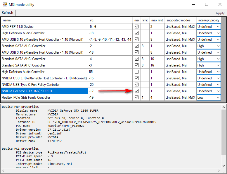

I found this post:
https://vi-control.net/community/threads/dpc-latency-spikes-due-to-nvidea-drivers-solutions.98845/
which there's a guy suggesting to do these steps:
- Disable Windows 10 Hibernate
- Disable HPET
- Use NVSlimmer to create a less bloated NVidia DRIVER
- Use DDU to uninstall the current driver
- Install the less bloated DRIVE trimmed by NVSlimmer
- Adjust BOTH NVIDIA and Windows power settings
- Make sure NVidia driver is using MSI utility tool
MSI(Message Signaled-Based Interrupts) utility V3
https://forums.guru3d.com/threads/w...terrupts-msi-tool.378044/page-71#post-5826955

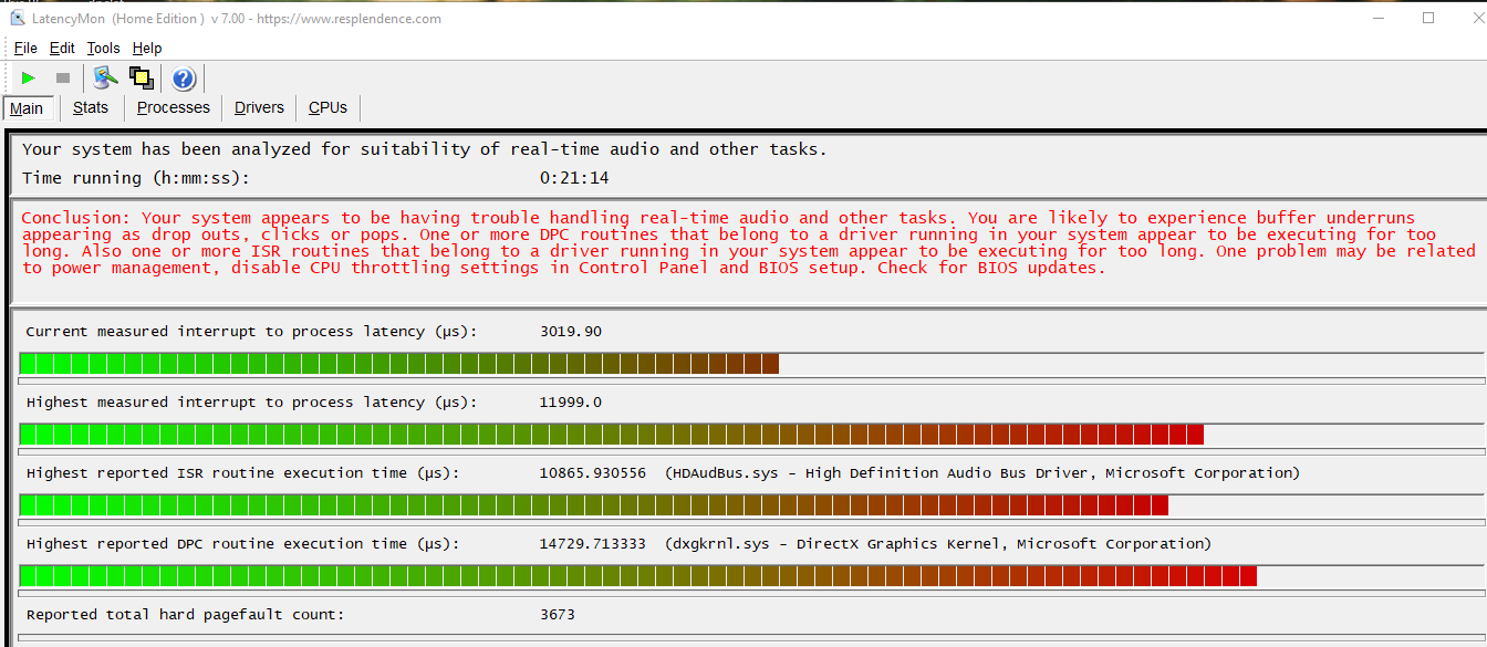

This picture is from that website, my gpu is 1050 ti
and I think doing these steps did make a change in LatencyMon, I mean it didn't lower the latencies, but I think that the dxgkrnl.sys doesn't appear as often as before, in fact, it's not there anymore after doing those steps, it's now replaced by the HDAudBus.sys or the wdf01000.sys, which they don't go that high at first, but do a sudden spike after a few seconds
so yeah I think the dxgkrnl.sys might be "fixed" somehow I guess??... I don't know...
EDIT: nevermind, the dxgkrnl.sys is BACK, lol:

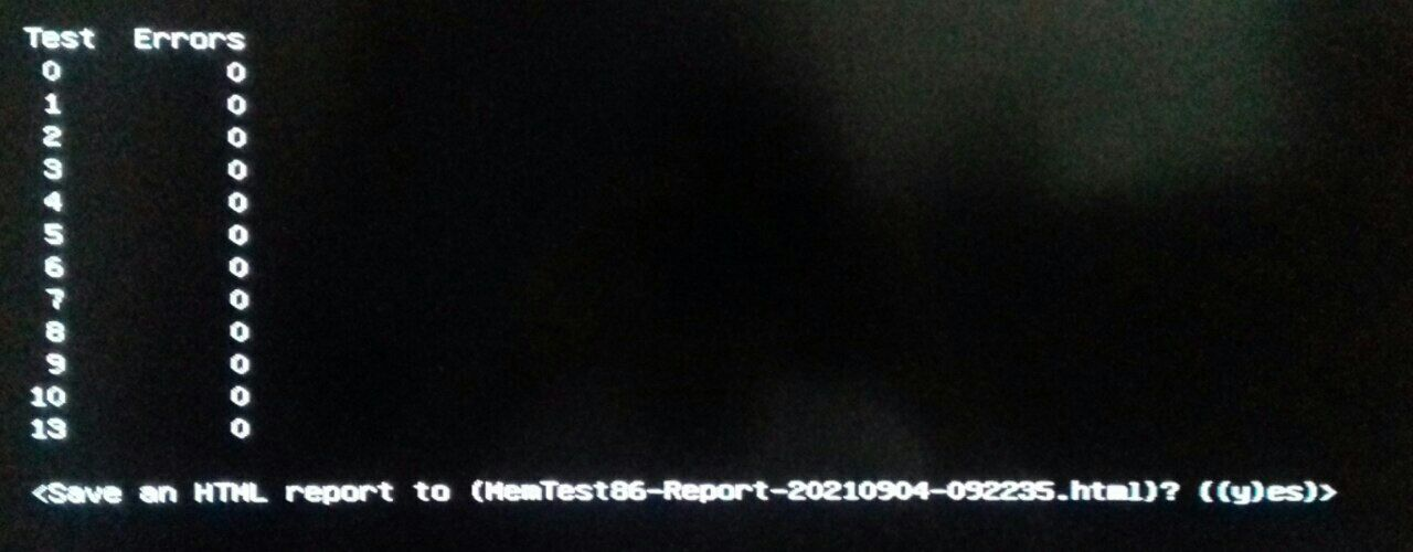

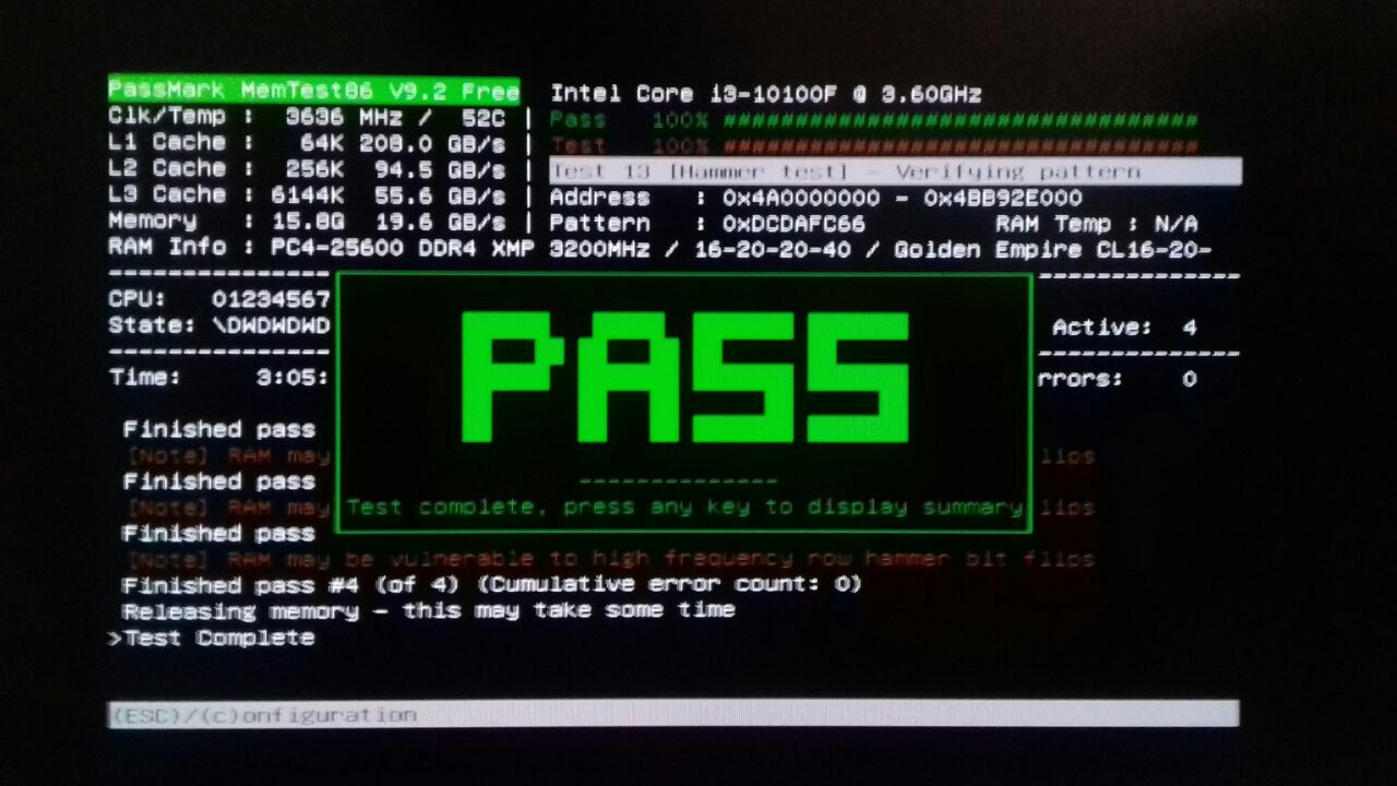

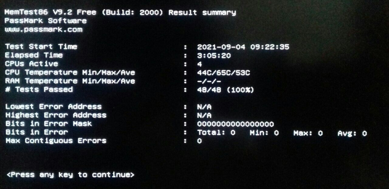

Did you run mem test ever? It's very possible that it's your ram, not the GPU.
So realistically, the only "new" thing you tried was installing the specially trimmed driver? Because I believe youve done all of the other steps already at one point or another, including a total re-OS of the system. This may sound strange, but im pretty much out of ideas, can you follow this guide to enable "stereo mix" on your system:
https://ccm.net/forum/affich-125400-cod-4-multiplayer-doesn-t-start
Its a fix for COD4, the steam version fails to load on anything windows 7 or newer (which is how I know about it), but given that it works perfectly and I dont know why, it might be good to try here too.
Yeah, installing the trimmed driver and also checking my GPU as msi in that msi utility tool
I've enabled stereo mix, no fix
No, not yet, I'll do it right now, and I think that you might be right, but again, I've reset my BIOS to defaults, all the RAM settings are now reset but that didn't solve anything
Even slightly faulty ram can cause all sorts of issues including this. Definitely worth checking :).

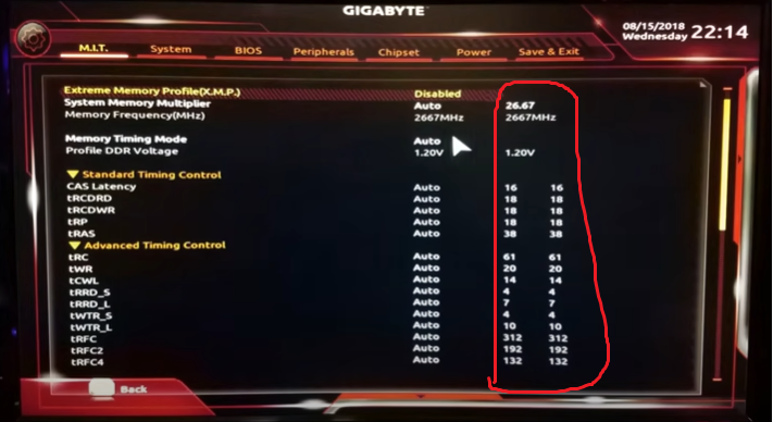

Another thing to mention is that there are multiple columns in the RAM timings section of the BIOS as shown below
THIS IS NOT MY BIOS, it's a random video on youtube, but mine is really similar to this one except the color theme is yellow instead of red:
but only the left column is selectable, and I've set the first 5 values to specific timings relative to my 2666 RAM speed, and when I reset my BIOS, the left column always resets to auto, but the right columns won't get reset, they always have the last values that I've set to the left column, what are those two columns on the right? what do they show, I'm concerned because they don't get reset, and I've done so many tweaks on my RAM

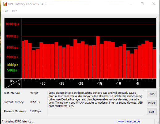

New results!
When I disable the High Definition Audio Controller under the Device Manager > system devices
the HDAudBus goes away from the LatencyMon! there are two High Definition Audio Controller, only one of them fixes the issue, and it's the one related to my headset, unfortunately, so if I disable it, I don't have any sound anymore, because both of these HD Audio controller devices cause this issue, so basically I can't use any sound, I uninstalled these two devices and then installed the Realtek, but after restarting they're installed again
in LatencyMon, the HDAudBus gets replaced by the wdf01000.sys, but it doesn't spike
I will reinstall the graphics driver right now but the studio version not the game ready, to see if anything changes
I installed the studio version of the graphic driver, it was also the trimmed version and only installed the graphics driver not anything else, and it got worse!
the dxgkrnl.sys is back again
One important thing that I noticed
after I removed the graphic driver, I ran latencyMon with the HD audio controllers both enabled, and they had NO SPIKES!
I think the main culprit is the graphic driver, both dxgkrnl.sys and nvlddmkm.sys, without them, everything is fine
