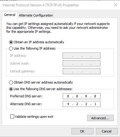

Change your DNS in your Windows ethernet adapter directly. Something like this (random example but this should work):
Keep using DHCP for the address (top half of the box), just manually put in DNS servers. See if that works better or not and report back. Can use 1.1.1.1 (cloudflare) instead of 8.8.8.8 (google) too.
Ok I did that. I'll play a game or two and see how it goes.
