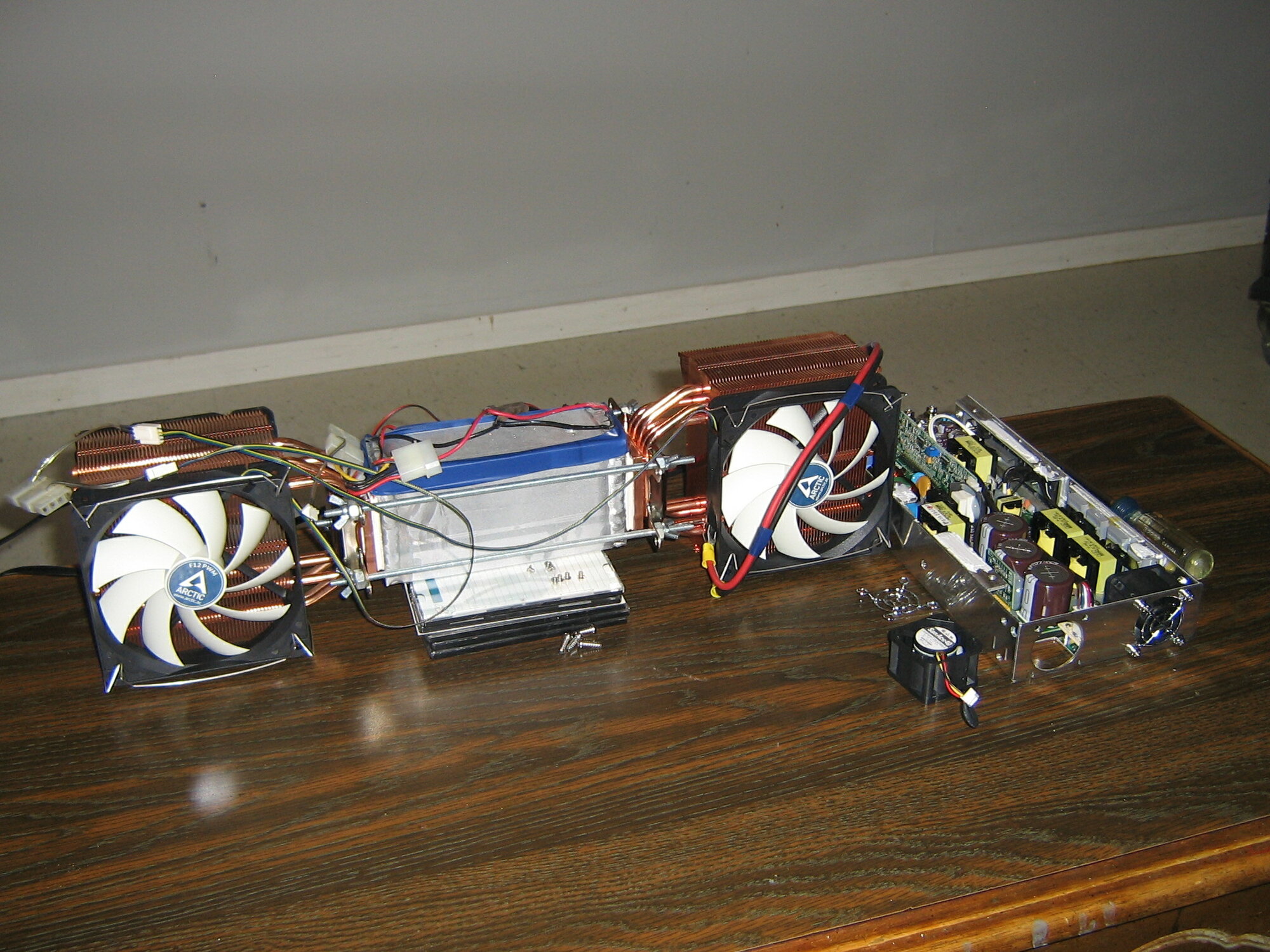

Why not use one of the non-metallic, inexpensive, commercially available reservoirs built specifically for watercooling?
It's a custom reservoir, designed to be a peltier chiller.I made it from scratch,to use up a bunch of my crap from my workshop.
Here's a pic ;
I had intended to fabricate the reservoir from quarter inch copper , but I could not find a 400 amp TIG machine.I ended up having to use the next best heat conductor , aluminum.
There is nothing cheap about it, just the parts in that picture are worth about $ 1200 US , not including my time.
The PSU shown is a meanwell RSP-1000-27 .It's controllable from about 13volts to 30.5 volts (the pelts are 31 volts, 17 amps max, each).
