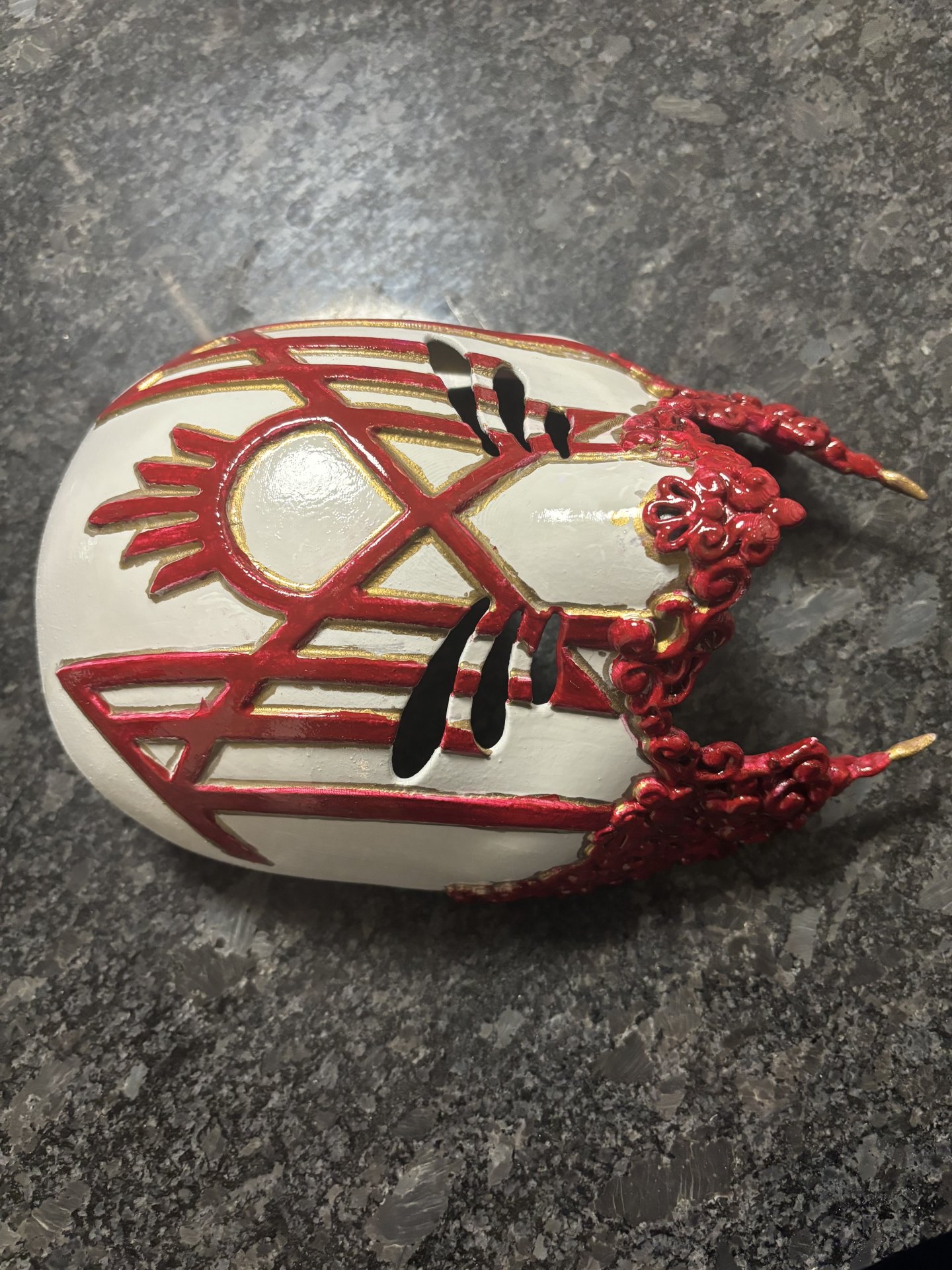

I need to post a few pictures at some point of how great these prints are. Had 2 failed prints likely my fault. Here is a compiled mask from Sleep Token Vessel mask:
