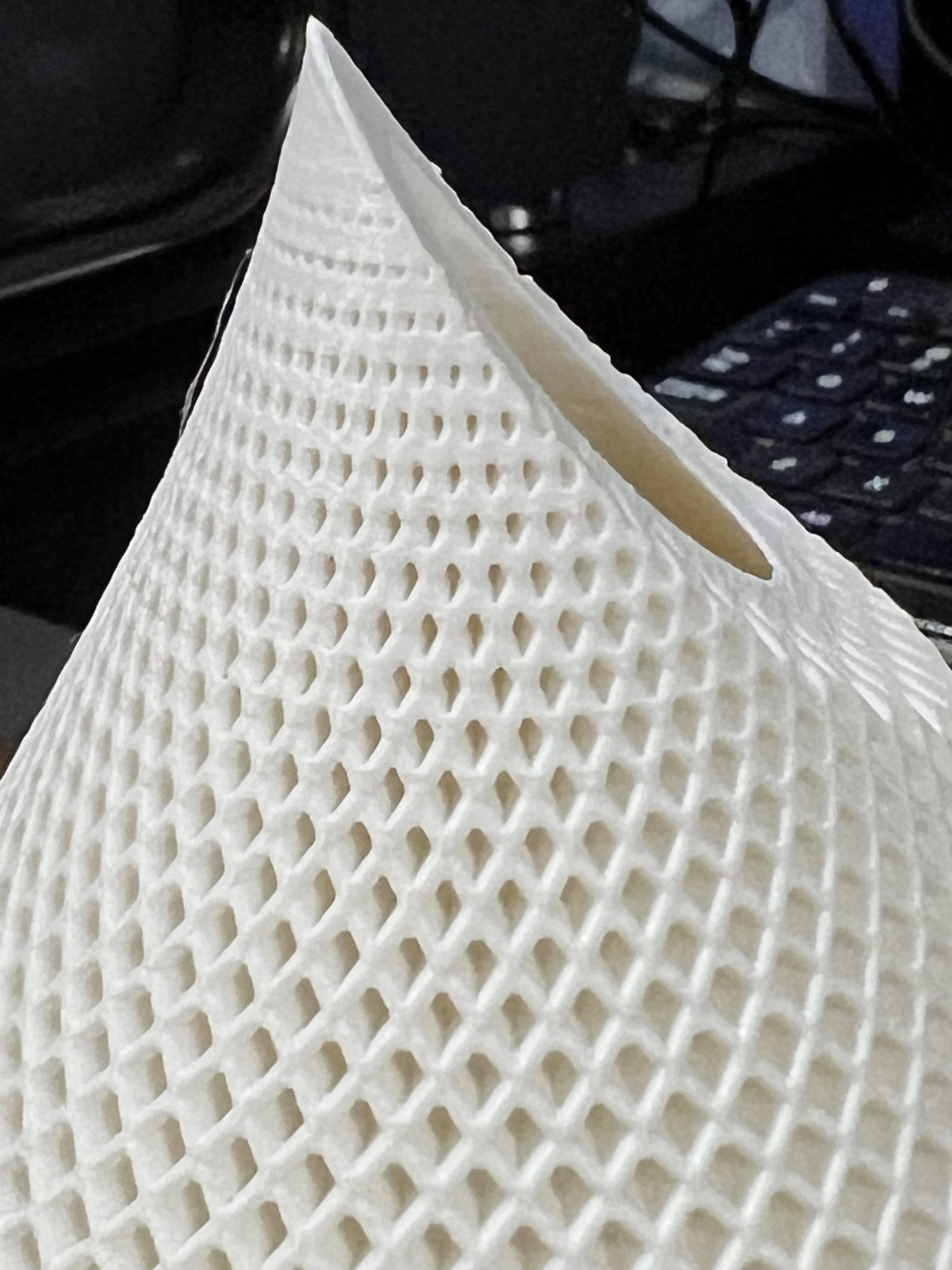

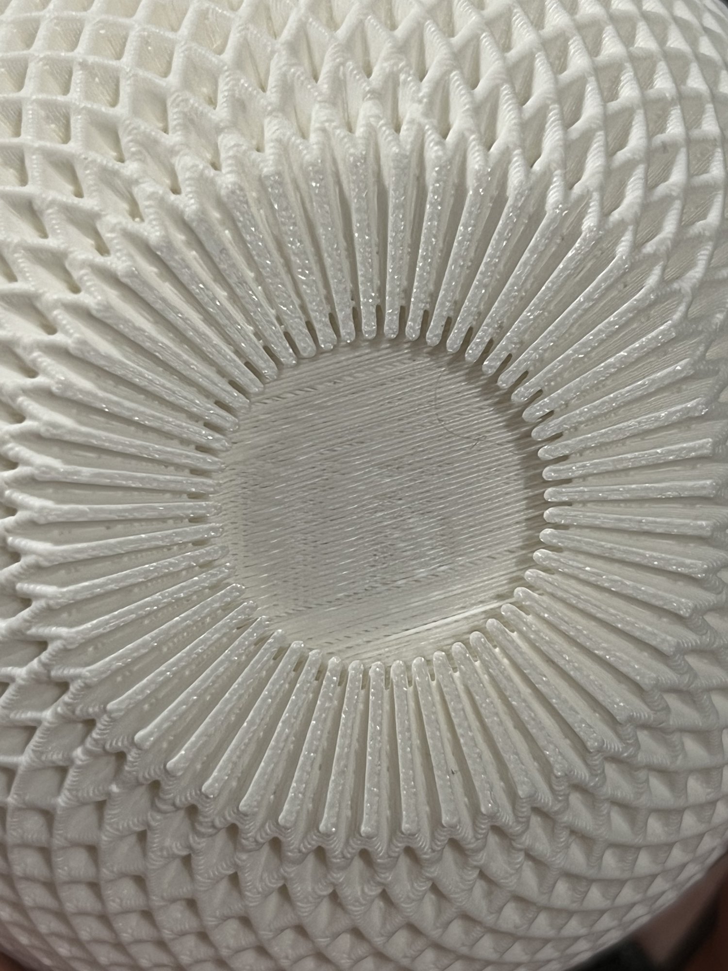

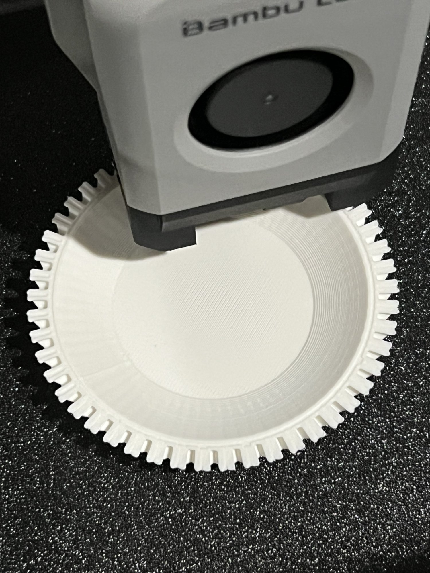

2722DA81-1090-4D91-BA98-9B2449221574.jpegBAB0AF0C-1E9B-404C-A8E3-D616FFC6C117.jpeg7DED1C27-827B-456B-9B42-9FBE3C353722.jpeg
I had an ender 5, then a neptune 2s, was sick of manually leveling the bed and inconsistent print results. Was looking at getting a voron, but didnt want to deal with 30+ hours of assemble and tuning
Vase included on the SD Card. Took 8hours. This would have easily been a 24hr print on my Ender and wouldn't have looked anywhere near this good. 😲
