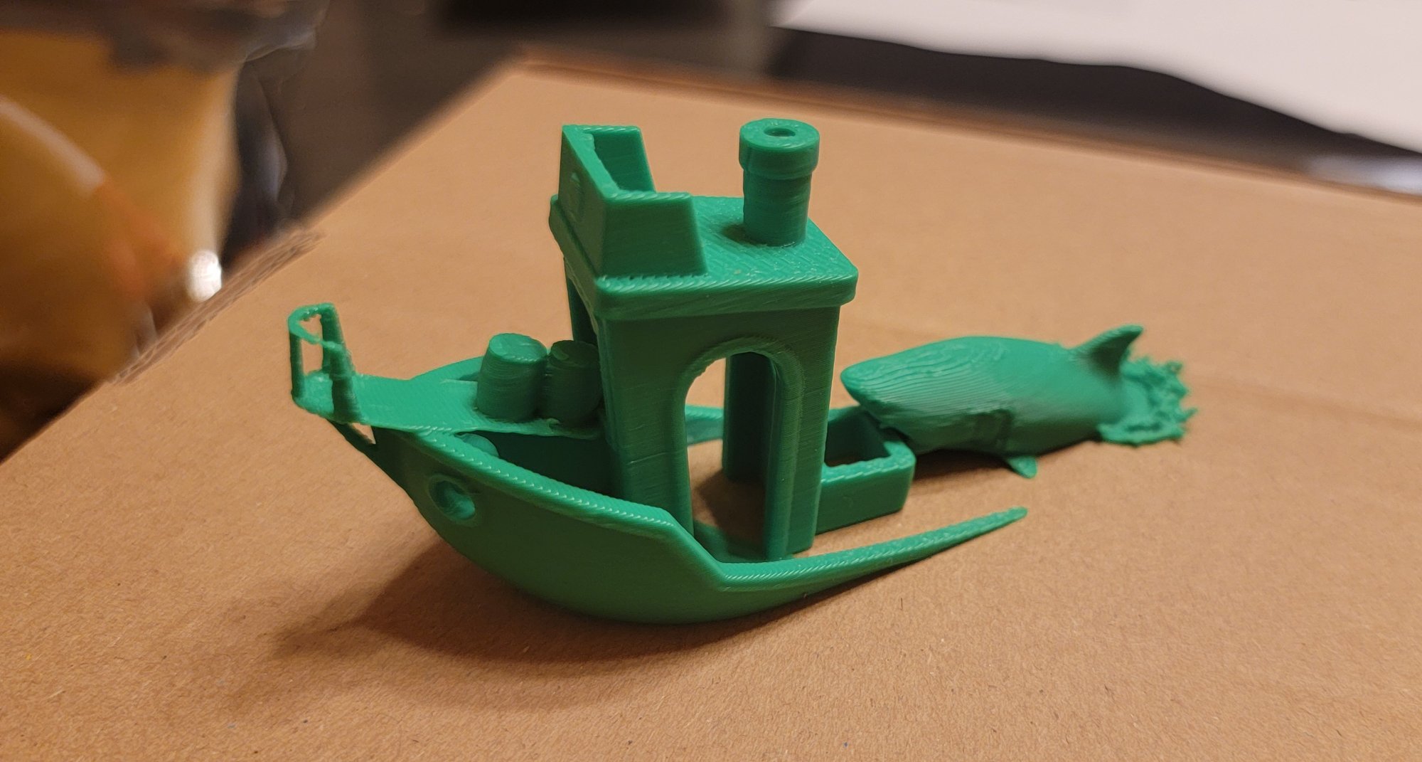

Tested the new nozzle out with this "benchy". It's sitting on a dime. It is far from perfect but perfect from afar.

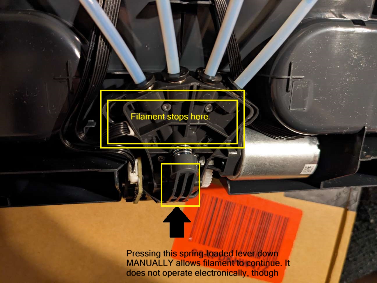

Received my 3rd AMS. It arrived broken. Not happy. Spent 2hrs disassembling it to identify why filament will not feed past a certain point in the AMS. It makes it to the 4-into-1 tube "hub", then stops. Manually depressing the spring loaded lever allows filament to continue feeding out of the AMS but that lever is supposed to be operated electronically. It doesn't operate.
Have checked all electronic connectors and all are seated properly. There are no torn wire sleeves or anything that would indicate a ribbon wire somehow "broke" a strand.
To me, this is something that can be easily quality tested so I am not even a little happy about it.
Just opened a support ticket so I will see what they say (IF they ever get back to me)

Yep. So much dumb stuff passes right through QC when it comes to 3d printers. Regardless of brand.
Hope it gets resolved soon.

As you can see from my previous post on 3-1-24 about receiving the dead AMS I had to place a support ticket with BL.
I received email today from them telling me that the research I did did indicate that the internal hub and motor were defective, so they asked for my address so they could send me a new internal hub and motor.
Not ideal, but not horrible either.
