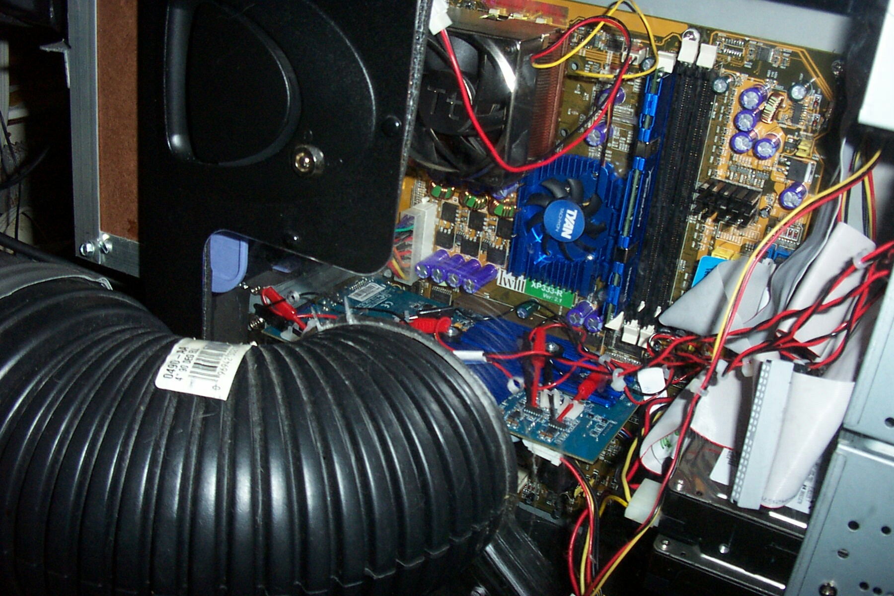

    no, enclosed loop means just that, moisture is not going to come in to form ice. A heat up period of over 0c can also be used periodically, to melt any ice off of the evaporator coils in the A/C unit. Yes, some A/C units are more noisy then others, while that noise is being directed/muffled in this situation your right, some may not like the noise and it would not be for them. There are also options where you can have a remote A/C unit and duct the air to the pc. I did not have an issue with noise since where I live, I hear not only my own A/C unit but neighbors as well. Also note this is a period of time or tail end of it where folks were using delta fans (I was one of them) that was louder than any A/C unit I've own so for me it was a noise reduction.
    For a period of time, very short actually, I was below 0c, that temperature is not too friendly with mechanical moving devices like fans and hard drives, fans would make noise, hard drives would fail. Reason why I ended up above 5c range which seems to alleviate issues with hard drives and fans.

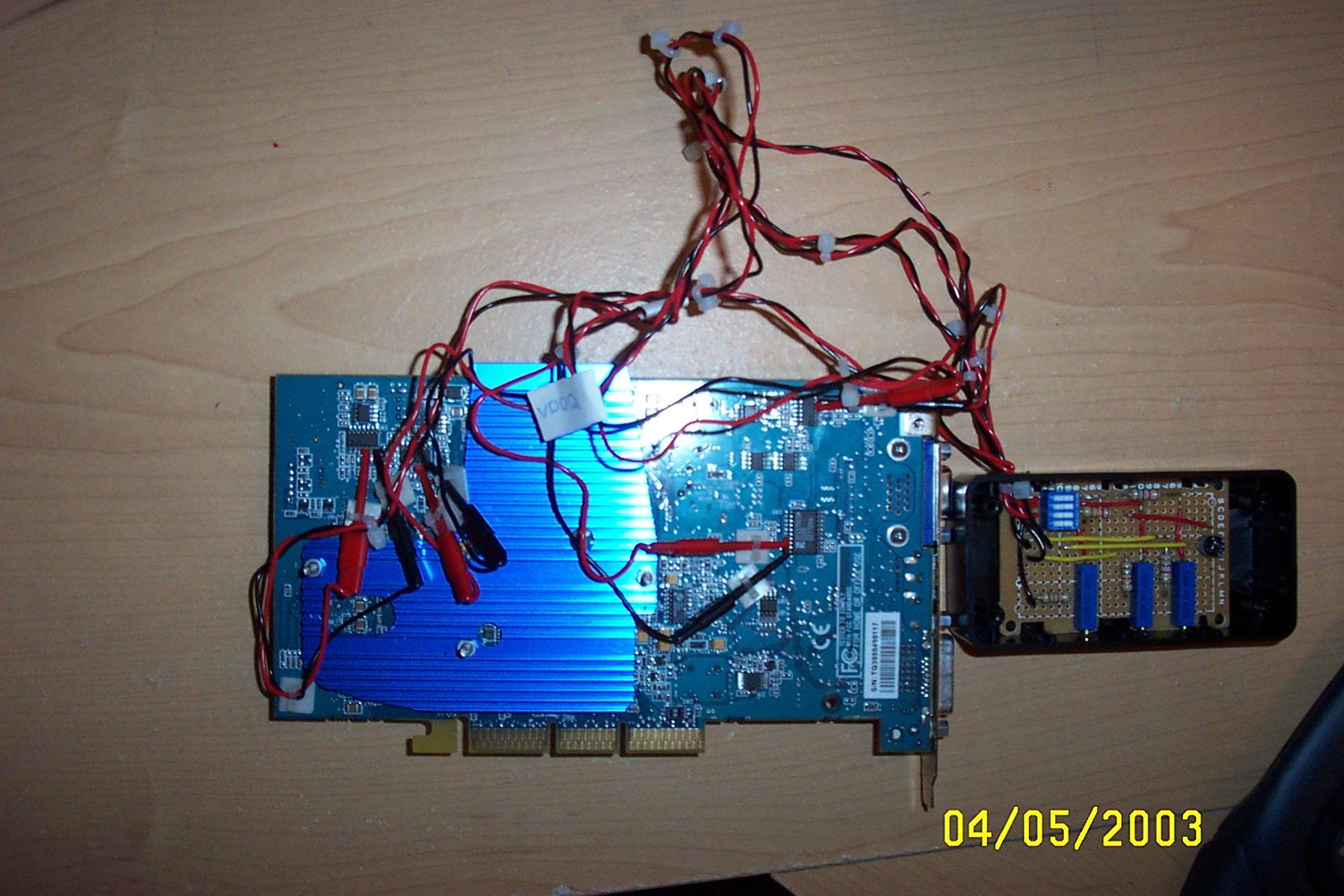

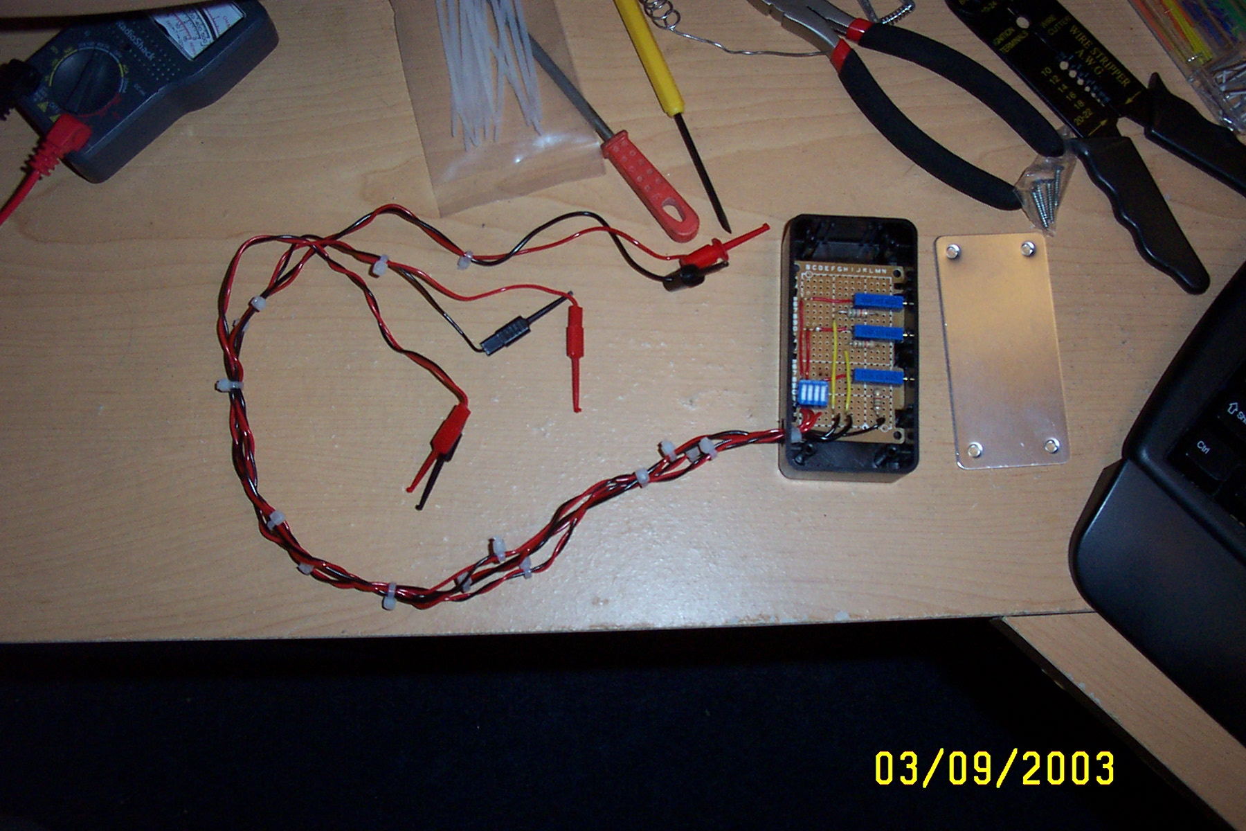

    That is how I got my Radeon 9700 Pro from 325mhz all the way up to 425mhz, normally I kept it around 410mhz. Not only the card was way beyond it's time, the OC made it even more awesome. It was a Tyan 9700 Pro, probably the first card that had sensors and software that showed the different voltages, which was key for the hardware volt mod I did. Made a circuit with three pots to hook up to the different voltage controllers and used the Tyan software to adjust the voltages to optimize the OC using PowerStrip (was first program that could OC ATi cards) I also modified the HSF on the card. The image shows how the cold air which could be below freezing, blew right over the card as well as the CPU, motherboard, ram etc. This was some 16 years ago lol. Used that case setup for around 10 years or so with different motherboards, GPUs and worked wonders for OCing over and over again. PC cases back then were not as opened as they are now. Today I have different ideas. Some old timer nostalgia in the end.

    Your looking at it. I don’t have pictures of the A/C unit plenum, remember these are some old ass pictures. Anyways the black corrugated plastic pipe is mounted to the case window which pivots, the fitting snaps on and off with ducting going to it. You can actually see the exhaust plenum in the back. All other holes were sealed. Today cases makes this method impractical in my opinion. Case was insulated throughout, rubber insulation.
    This cooled everything, GPU CPU, ram motherboard power supply etc. I believe in the above picture the CPU was an Athlon 1700 OC to 2.1 ghz +
