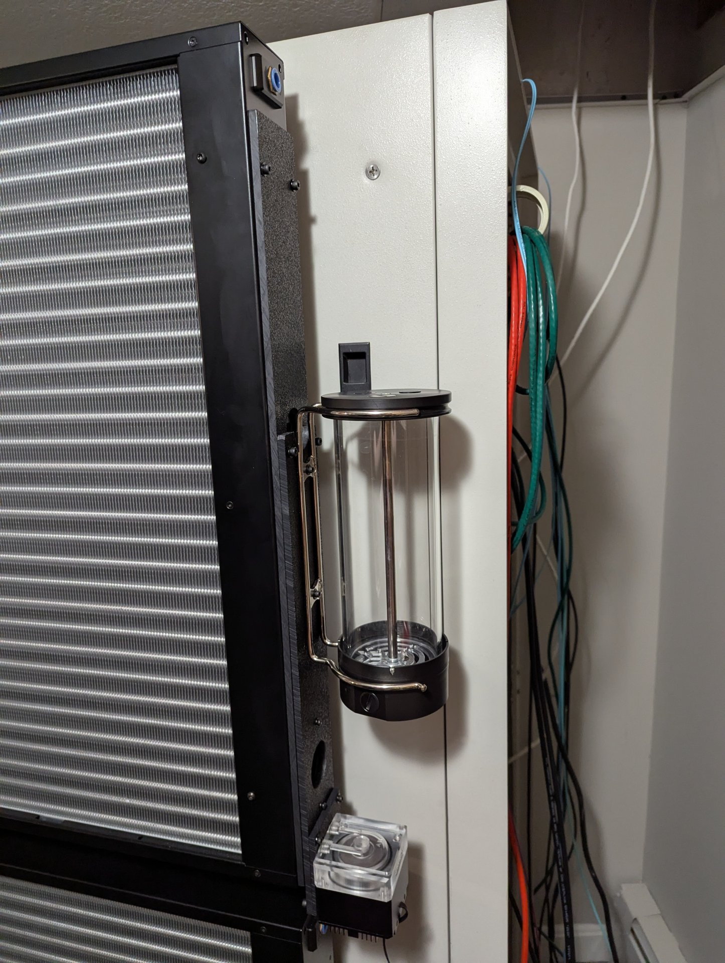

Alright, the second path has been working out how to mount the reservoirs and pumps to the sides of the radiators.
After initially deciding to make my own bracket, and then later changing my mind and ordering Watercool's reservoir brackets, I am now back to making my own, because of the issue I previously mentioned where they sat a bit too high for my tastes.
I bought a 24" long 1/4" sheet of ABS, that I had planned on cutting into strips (70mm wide) to run the length of the side of the radiators, for me to cut custom holes in and mount my stuff.
I didn't want to make a mess indoors cutting though, so the plan was to do it outside, but we had a slushy messy ice storm followed by a week during which the temperatures never climbed above freezing, and I didn't want to work outside in 10°F weather, so I waited.
Today it was a balmy 30°F out, so I decided it was time.
One thing I have learned over the years of tinkering and trying to make stuff, is that even if you have steady hands, it can be surprisingly difficult to cut straight lines linger than what you can do with a single move of a miter saw blade.
If I had a band saw with a backstop, that would be amazing, but sadly middle school shop class lied to me about the tools I was likely to have at my ready disposal in my life.
If you use a jigsaw hand or powered, it becomes squiggly and uneven no matter what you do.
I was going to have to make do with my circular saw. Just for good measure, I went to Harbor Freight and picked up a blade intended for cutting plastics, as I wasn't convinced my wood blade was going to make a clean cut. (something to do with rotational speeds and number of teeth)
To get a straight cut, I decided to do it like I would ripping a plank along the grain, and clamped down a known straight piece of wood, and measured my cut distance to that, with the plan of running the side of the circular saw along it.
It was a pain in the but to get both sides precisely aligned, as I would first align one, and then move to the other side, and my adjustments on the other side caused the first side to move, etc. etc.
Eventually I got it dialed in, and it was time to cut:
View attachment 712502 View attachment 712503
I was dreading this a little, but it actually wound up turning out pretty good.
The width of the two pieces wound up being more repeatable than it had any right to be (within a millimeter).
While I was having some success, I decided to also cut a third piece, and then chop it into 8 squares to use as spacers or something, when I go to assemble it all, if I need them.
At least that is a little bit of progress :p
Alrighty, here's a little bit of progress.
I'm actually a little embarrassed how much time this took me, but it has been a game of trial and error, and then one of repeated assembly and disassembly to see if the hole I just made lines up and everything fits, only to do this over and over and over again
So I used the strips of ABS I cut last week to put together my first reservoir/pump bracket.
Now, these were supposed to be enough for both of them, but it didn't turn out that way.
The original plan was to attach one strip to each radiator using the screw holes present in them (four M4's, one M3 and and another M3 for a little alignment feature, which is quite nice. At least I think those are the measurements on the screws. Not 100% on that. I just pulled my screws out of my metric machine screw kit, and used the ones that fit.
But I ran into a little issue. (Or at least a refinement of my plan in my head as the project is underway.
The pumps I am using have the ability to use an inlet on top, and an outlet 90 degrees to the side (or both inlet and outlet on the side). In the interest of making each radiator loop as short and limited in bends as possible, I thought it would be best to use the top inlet, and the side outlet going straight into the radiator using a rotary male-to-male fitting.
Only one issue. That makes the pump stick out too much. (seen here with my first failed pump spacer bracket experiment. My smallest hole saw - 1" - was too big)
And seeing that the G1/4 threads are straight into the plexi, I didn't feel comfortable having all of the weight hanging on that lever arm. It just seems like a crack risk waiting to happen.
Additionally, the big hole is there to allow for cable routing. I plan on attaching a 1" liquid-tight conduit there. (It doesn't need to be waterproof. I just want to use it for cable management.) But there really isn't much space between the bracket and those pipes. Not even sure the threads of the liquid-tight fitting could be able to mount there without interfering with them, so I wanted to add another layer there too.
So I decided to go fro a three layer design. Base layer attaches to the radiator, and also gets some pressed in threaded inserts to help attach the radiator and pump. Second layer is smaller than the base layer, and sits on top of it, acting as a lid for some of the larger holes, gets a hole designed for the liquid-tight fitting, and acts as a spacer for the pump bracket.
For threaded inserts, I tried these in a 6-32, UNC size. They are specifically designed for plastic. No heat or ultrasonic necessary. You just drill a 3/16ths hole, and press them in. First time you put a screw in them, they expand to sit extremely tight in the hole.
Here is a test piece I inserted one in to make sure it worked well before possibly butchering my main bracket pieces.
I get the impression there is a specialty tool to press them in, but I don't have it. I tried a few methods to press them in, including my benchtop vise on my workbench (worked, but overkill) a screw style wood clamp with pieces of wood on either side (annoying, too many loose pieces) and finally, just pressing it in with a channel lock. This was easy, and just worked.
The first time you screw a screw into one of these to expand it, it is really tight. The friction actually makes both the screw and the insert very hot. So I just grabbed the longest 6-32 UNC screw I could find (only like 2") and screwed it all the way in and out several times in a row. The parts got nice and hot. My thought process is that this softens the plastic and re-hardens it around the insert. No idea if that is actually true or not, but I figured it was worth trying.
Here are the three layers attached to the radiator:
For what it is worth, this is a work in progress. I'm not even bothering wiping down figerprints or smudges until it is all done, and I take the final pics. I'm going to touch these things a million times, and that is going to happen.
While installing the pump is a real pain (I'm sure auto mechanics would call it a real engineers special) It does work, and everything fits. Time to drill holes for the reservoir, and press in some more inserts.
Here are the thee finished layers:
They are full of classic "early prototype jank", but most of that is hidden when installed, so who cares? :p
Here is a closeup on the pump mount.
Here we have the reservoir attached:
Here's where the tubes from the res to the pump will go. I hope they don't interfere with the conduit too much...
There is more space up top in this configuration than what was originally planned. I might even fit the QDC's now, but I am not sure I want to anymore. I'm not sure how much flow restriction the Koolance QD4's actually add, and I don't want to slow down the flow...
Oh, and here is the conduit fitting. We will have to see how much interference between the tubing and the conduit there winds up being.
I am not attaching any tubing yet, as I wound up having to order more ABS to make the second bracket, and when it gets here, I am going to disassemble the whole thing again, and use the existing parts as templates for the second bracket, so it is going to need to be completely disassembled yet again...
Anyway, I was happy to finally get through the design of the bracket.

Regarding loop maintenance- my system with only distilled water and silver killcoil was taken apart 2 years ago after at least 6 years in service without changing the coolant and at least 10 years with only changes of the GPU block (I use QDCs so I don't have to drain the system when changing components, I don't even remember doing a coolant flush but probably did at one point when replacing my motherboard). The Heatkiller 3.0 I took apart only had a little bit of gunk in it, less than 10% of the fin area, everything else was fine.
