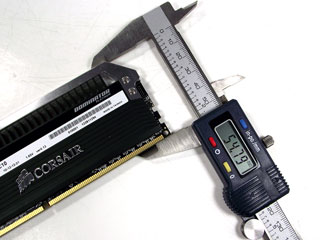

I received the cooler today. Waiting for the fan and tim. I can confirm that CoolJag Falcon fits. Can't wait to test it. Hopefully by next Monday I will bet testing it.
Nope, it won't fit. As far as I remember, total max height for the ram sticks when you take out the HDD support bracket is ~51 mm. We've ben asked specifically about those sticks few times in the campaign comments.
Ok I stick to my GSkill.. Just remove the red trim and boom.. All silver and black.. Lol..

Make sure if precisely those ram sticks you are going to buy are on the QVL list of the board. It's important for Ryzen if you want XMP running properly.

And thanks for the heads up regarding the ram. I checked my board QVL and changed to a ram that is compatible with XMP :)
