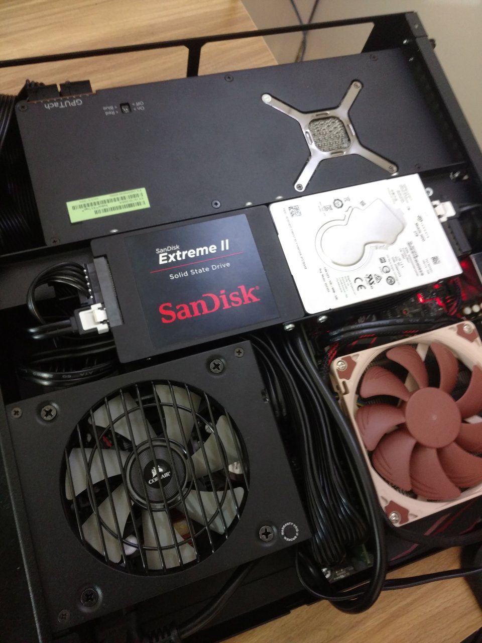

I've almost wrapped up my Sentry build. I've got a few thoughts to share.
I bought an open-air cooled EVGA 1070 without a backplate or blower. I wish I'd picked up one with a backplate because it looks way cleaner. I'm also curious to see if I could have fit a bigger card in there. It looks like there is room. I'm impressed someone got an Asus Strix to fit.
The hottest thing in my Sentry seems to the m.2 card on the back of the motherboard. I'd like to try attaching thermal tape to it like someone else did here.
I also picked up a Silverstone SFX-L powersupply. The fan sits too close to the side panel and is noisier when the cover is on. I imagine this is similar to what SaberPL described for Cryorig C7.

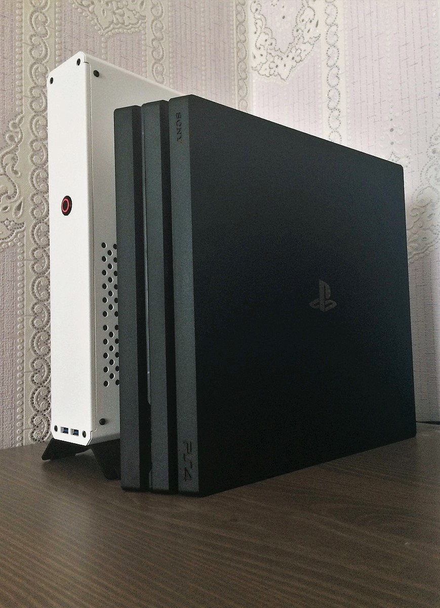

Thank you from Russia for the wonderful case, guys!
MSI Z270I Gaming Pro Carbon AC
Corsair 450W Gold
I7-7700K (undervolt, and clock like simlpe 7700)
MSI 1080Ti FE
16GB DDR4 2133
SSD 960 Pro (512) + SSD 850 Evo (500)

I do not have any problems with heating (but it should be noted that I'm talking about real heavy applications and heavy games, unfortunately in normal life I do not play extreme synthetic tests)
I had many mini-itx cases, and each had its own nuances and complexities, but there was nothing extraordinary in this case, and the assembly in it could even be even simpler than in other small systems that actually have even larger internal volume
I can confidently say that my ps4 pro in games is working louder than this system )

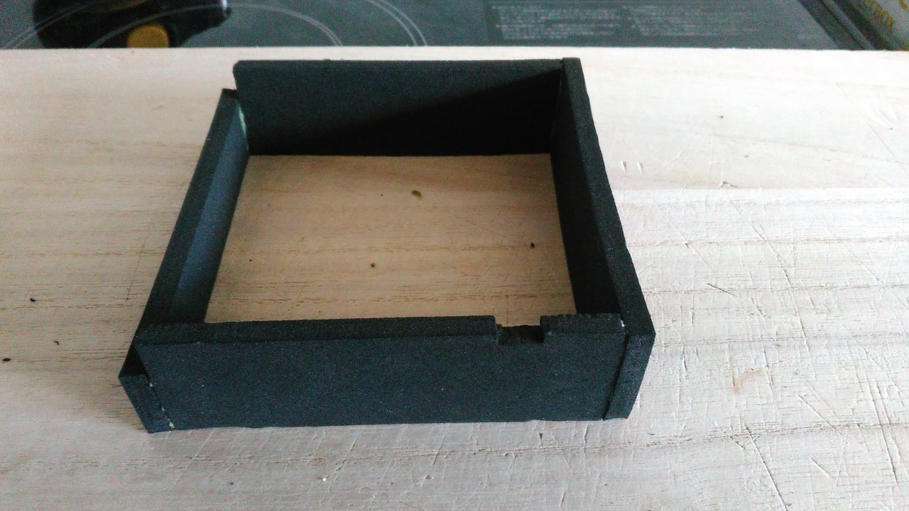

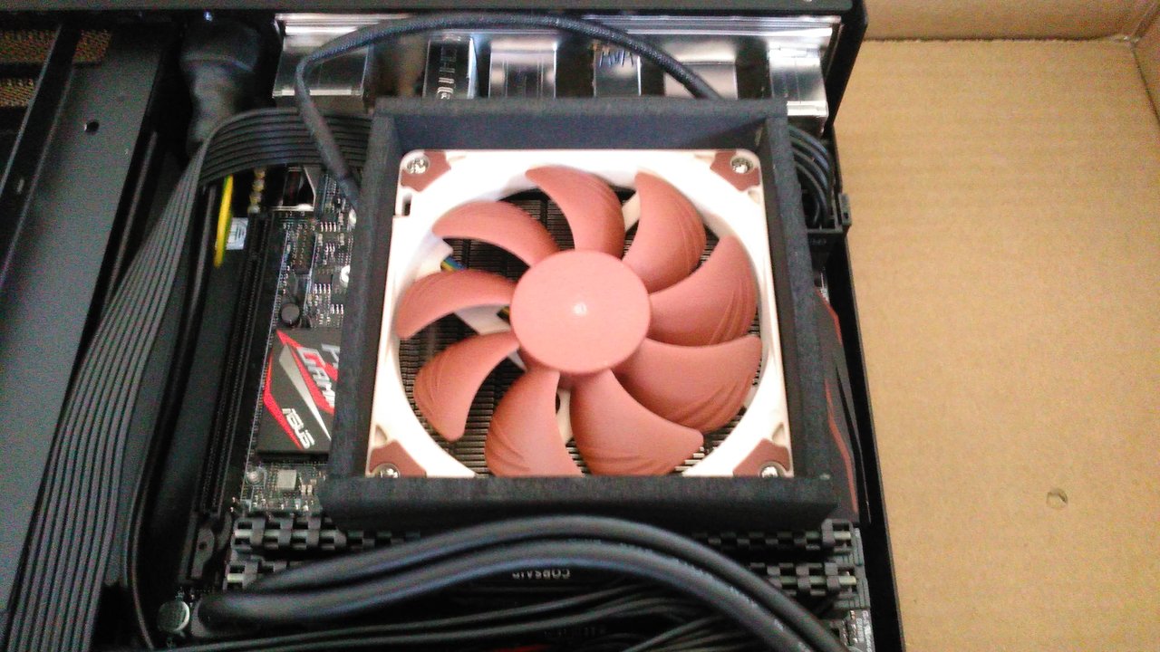

So I made up a shroud for the NH-L9i out of some 30x5mm foam and did a couple of tests.
i5-6600k @ 4GHz, Prime95 v26.6 small FFTs 5min, 30°C ambient.
Without shroud: 70°C 2420rpm
With shroud: 68°C 2180rpm
Note: There was no GPU because it died.

Alright, I'm biting. Did you buy the foam, or were you able to use something you just found laying around? I'm getting the same Cooler and this looks like a great idea. Thanks!
I bought the foam and stuck it together with contact glue. There is a small notch for the fan cable and I cut one side down to sit on top of the ram.
So in my experience when the foam is sealed right up against the fan it can make a bit extra noise. I've found it works best to adhere a strip of foam to the perimeter of the fan going out horizontal from the fan and then have a foam square adhered to the lid of the case come down around the perimeter of the foam sticking out from the fan. Basically using a foam strip around the fan to increase its diameter and then seal that larger diameter to the case. Anything is better than nothing, I've just found this is slightly quieter, probably makes a negligible difference in performance. My Sentry computer is at home in Texas so I can't take a picture at the moment.
I read your post several pages back. The reason I went this way was simplicity and I didn't want to use adhesive foam. Ideally I'd like to make a plastic shroud that extends toward the pcie riser and rear I/O, but that can wait.
Yeah I'm working on designing a proper shroud in FreeCAD for when ever I get a 3d printer in the future haha I keep trying to come up with ways to justify it.
