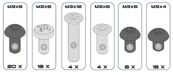

Anyone knows what is the size of the hex screwdriver bit for the Sentry screws ?
and the the type/size of the Philips screwdriver also
I want to avoid damaging the screws with a smaller/larger screwdriver
Thanks

Anyone knows what is the size of the Torx screwdriver bit for the Sentry screws ?
Thanks

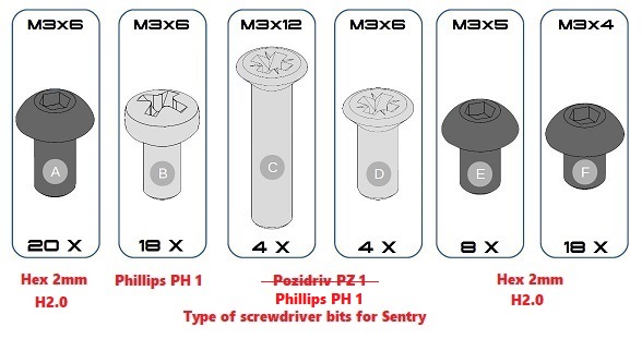

The screw socket is 2 mm hex but be careful because some online sellers are not properly measuring those - it has to be a 2 mm in "diameter" of the hex socket, it's for a M3 screw.

Is this correct ? Thanks SaperPL ZombiPL
The screws C and D are also Phillips screws - we've used those type of screws for the prototypes and thus those models were shown in the manual, but the ones included in the package are standard Phillips screws.
Sorry for the confusion and thanks for noticing this. Apart from that the rest looks okay :)
