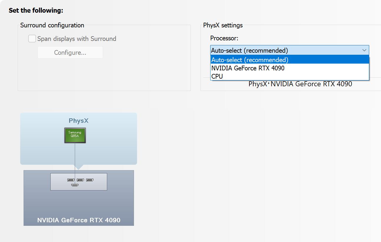

Does nvidia still have the Graphics GPU check to where you can't use ATI/AMD for Graphics and nvidia for PhysX?
Yes. NV Control Panel shows CPU or NV card. You may be able to use AMD on some games/software if the developer added the ability. I don't know if there are any settings in AMD drivers for physx.
AMD CPU:
So, run amd cpu or apu for physx support on 5xxx with old games?
What? Are you trying to say to use the CPU for hardware level physx? Have you not bothered to pay any attention at all? In the vast majority of those old games, the CPU cannot run those effects at a proper frame rate and that's clearly shown in all the benchmarks that have been posted about this. Plus there's some games where those effects don't even run on the CPU at all and you have to have an Nvidia GPU.
Isn't AMDs physx support through the cpu and isn't hardware accelerated? While it won't be to nvidias level, the 5xxx series doesn't support it hardware side anymore anyways. Just wondering if it would be practical, considering itx doesn't have an extra slot for older cards to run in conjunction with the 5xxx just for physx.
