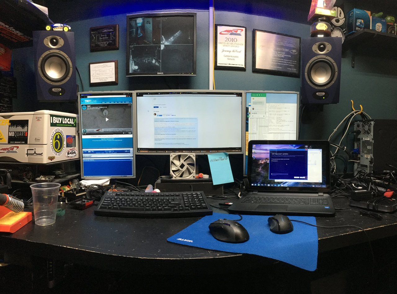

Finished this end of 2016.
Monitor on the right is hooked up to a work laptop above. Monitor on the left is the gaming Dell 144Hz. PC is the Thermaltake P3, 6700K @ 4.7Ghz, Evga FE 1080. Surround sound gaming is done by the Nakamichi soundbar in the back and sub underneath the desk. The 2 pre-sonus speakers are for the Numark. I ran power behind the PC for now. I'm considering running all cables behind the PC when I can locate a right-angle DisplayPort cable.
Here is my messy corner.
And here is my work bench.

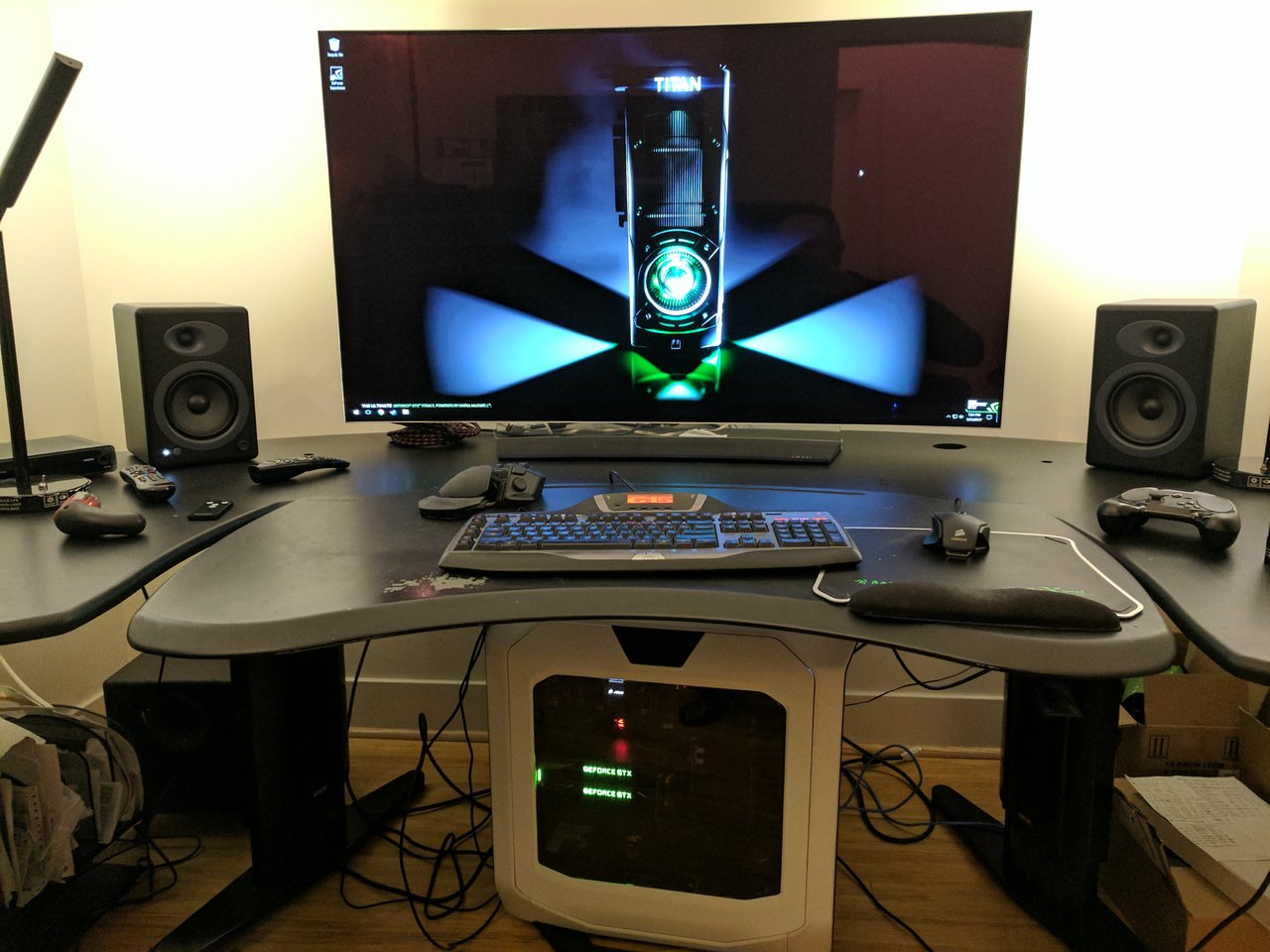

This is my current workstation updated recently, minus a small desk to the side with my laptop. Will be some more modifications coming soon though. Just for reference, it is a motorized sit/stand desk.
Which desk is it?
It is a Biomorph Maxo Series desk. Quite expensive. I am not sure how much I would recommend it. I love my desk, but if I have to move, it will be a problem taking it apart and putting back together. The motors work great though, you can set the levels you want for your sitting and standing position and it will remember them and automatically adjust to them when you click their setting. It holds a lot of weight. I got adjustable monitor mounts for it too that can hold up to 55" monitors on it. It also has some options for cable management with it too. I just am not using all of them at the moment since I just redid that system before that I took the pictures.

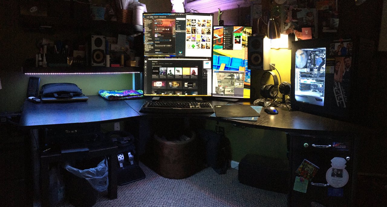

I just moved into my GFs apartment with her, so I haven't finished setting anything up yet. (Will need to be /completely/ different than my old apartment.)
Phanteks Enthoo Evolv Tempered Glass
6700k, Corsair H115i, SLI GTX970
Apple Cinema Display
Front 3 speakers from Logitech X-530 (don't have anywhere to put the rears, yet)
The router on top is an AC1900 running DDWRT as a Wireless Bridge, since I can't get CAT6 over to the main router from here.
I am planning to build a hutch for this later this week / next and make things a little better.
