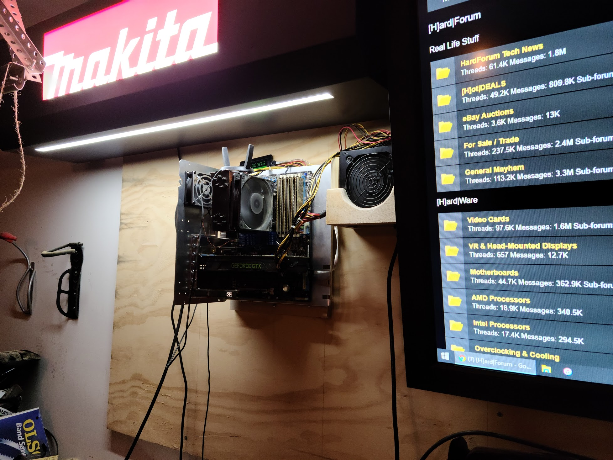

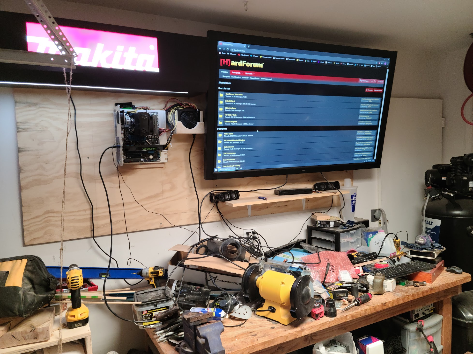

Garage PC finally got stuck on the wall after 2.5 years of sitting on its' box on my horribly cluttered workbench. I'm in the middle of a pretty hardcore garage clean up and now this is out of the way :D
Xeon w3690 @ 4.4ghz
24gb DDR3 1800mhz
GTX 680 4gb

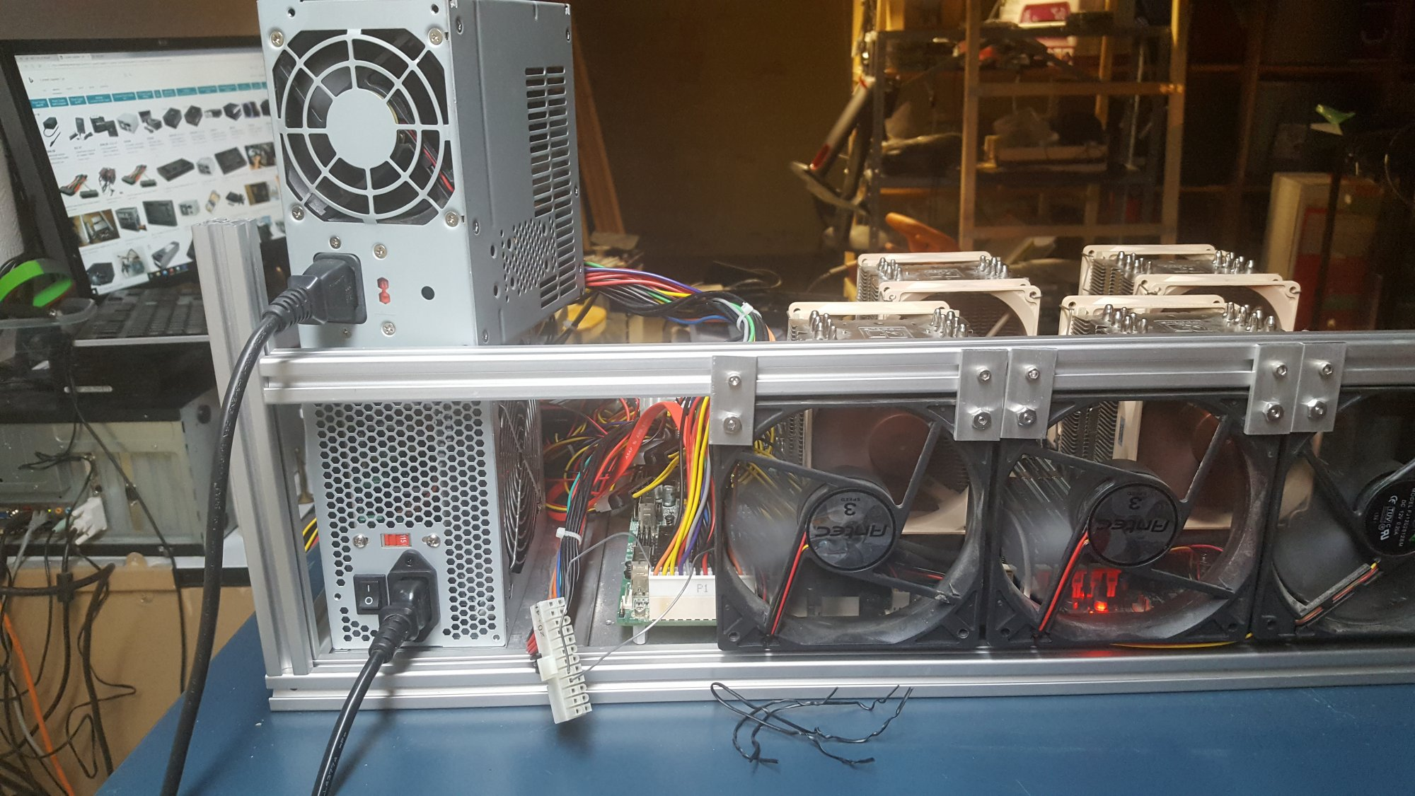

Was running 2 PSUs with paper clips because I didn't have the adapter and the local shop didn't have a replacement PSU for the DOA they sold me. Did this so I could try running it ~50% until I got a good PSU.. Ended up breaking this one too when I tried loading it up with RAM. It wouldn't even complete a boot up before shutting down. The OS SSD and one of the PSUs eventually stopped working in "Dual Mode".. Shocker, it was a 300W and a 400W.

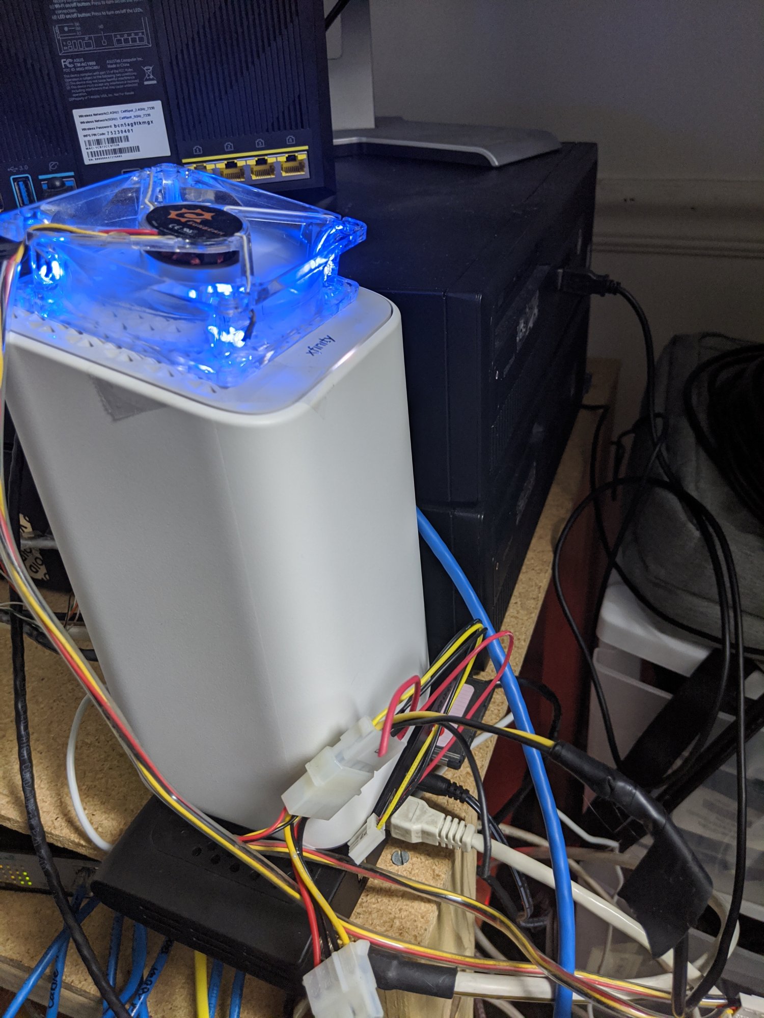

I have that modem/router, but use it bridge mode. Does it run hot?
I have it in bridge mode as well, it gets pretty toasty. Maybe it's defective in some way because even with the fan it's really toasty on the sides.
what do you have it sitting on? its venting heat into it.
Cable card tuner, it doesn't really put off much heat. It's fine by itself, but they don't make them anymore and my mom uses it every day so I put the cable modem on top to suck the air through it to hopefully make it last a little longer. Cable modem is hot no matter where it is. The fan is on suck not blow.
stick some taller feet on the bottom of the router, should help.

1. Old 80mm fan to cool the cable modem.
2. Modem placed on top of cable tuner to pull heat out of it. Don't have to have two fans now.
3. Molex connector is soldered into a usb cable and plugged in front of the computer.
4. Scotch tape holding the fan on.

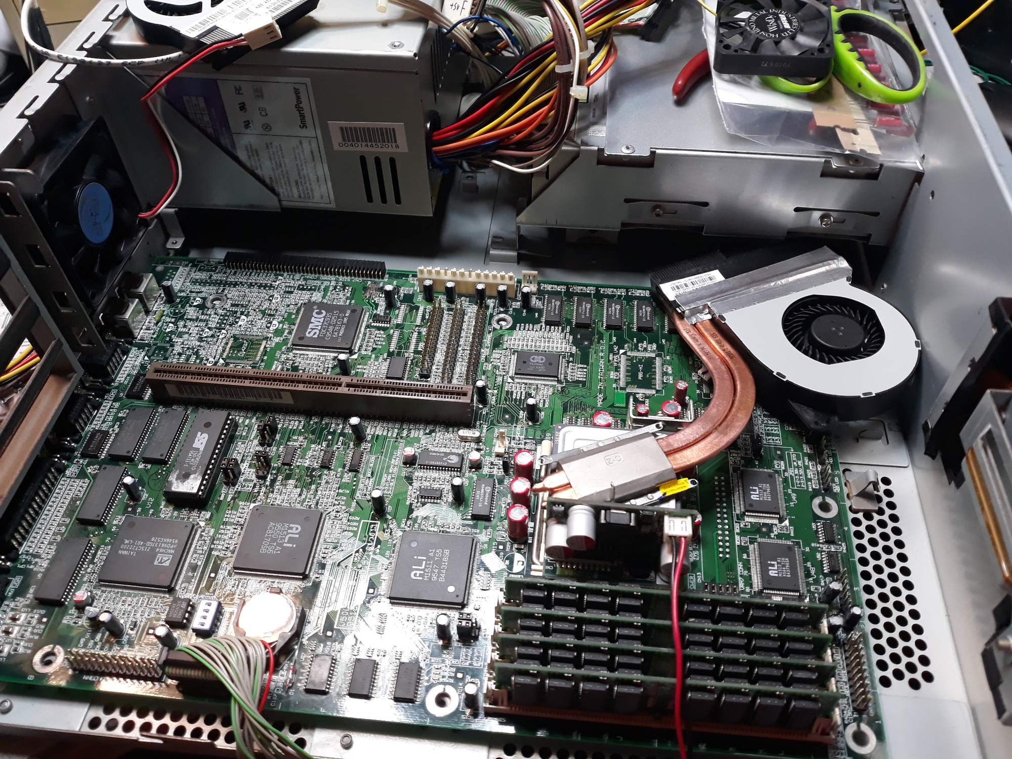

Using a laptop heatpipe cooler to remotely cool an AMD K6/2 400 on an interposer that's too tall to let the fan breathe. Since there's obviously no way of clamping it down, it was epoxied to the top of the IHS and the blower was hot glued to the case. The heatpipe assembly came from some ASUS gaming laptop designed to cool an i7, so it's more than enough for this CPU. I had to carefully bend the heatpipes to sweep down and go under the drive cage. It also required relocating a capacitor to the backside of the board folded at a 90 degree angle to fit in that location.
Here's the original cooling:
The card above it is a 12-13" PCI compatibility board with a video/audio daughterboard sandwiched to it. Because of the layout inside the case, it can only go in the slot it's installed in.

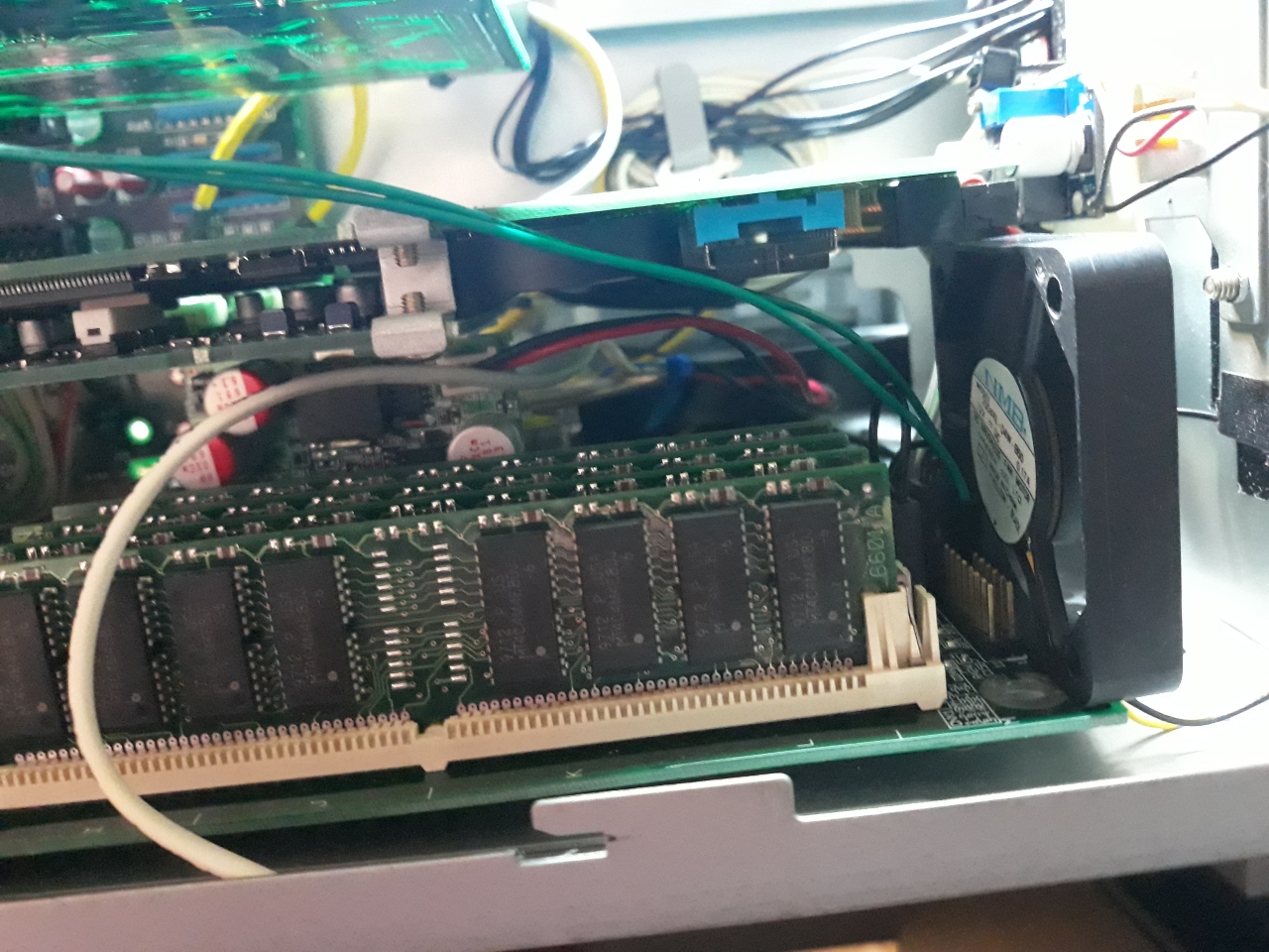

View with everything installed again. The old blow down fan was repurposed as a RAM/VRM cooler and a support for the long PCI card.

Pfft, that was easy. Backporting the Antec SL-350 ATX power supply to AT with a P8/P9 harness and a soft start header was the bigger headache.
The 60mm ASUS fan is also an addition, I had to dremel a hole in the case for it.

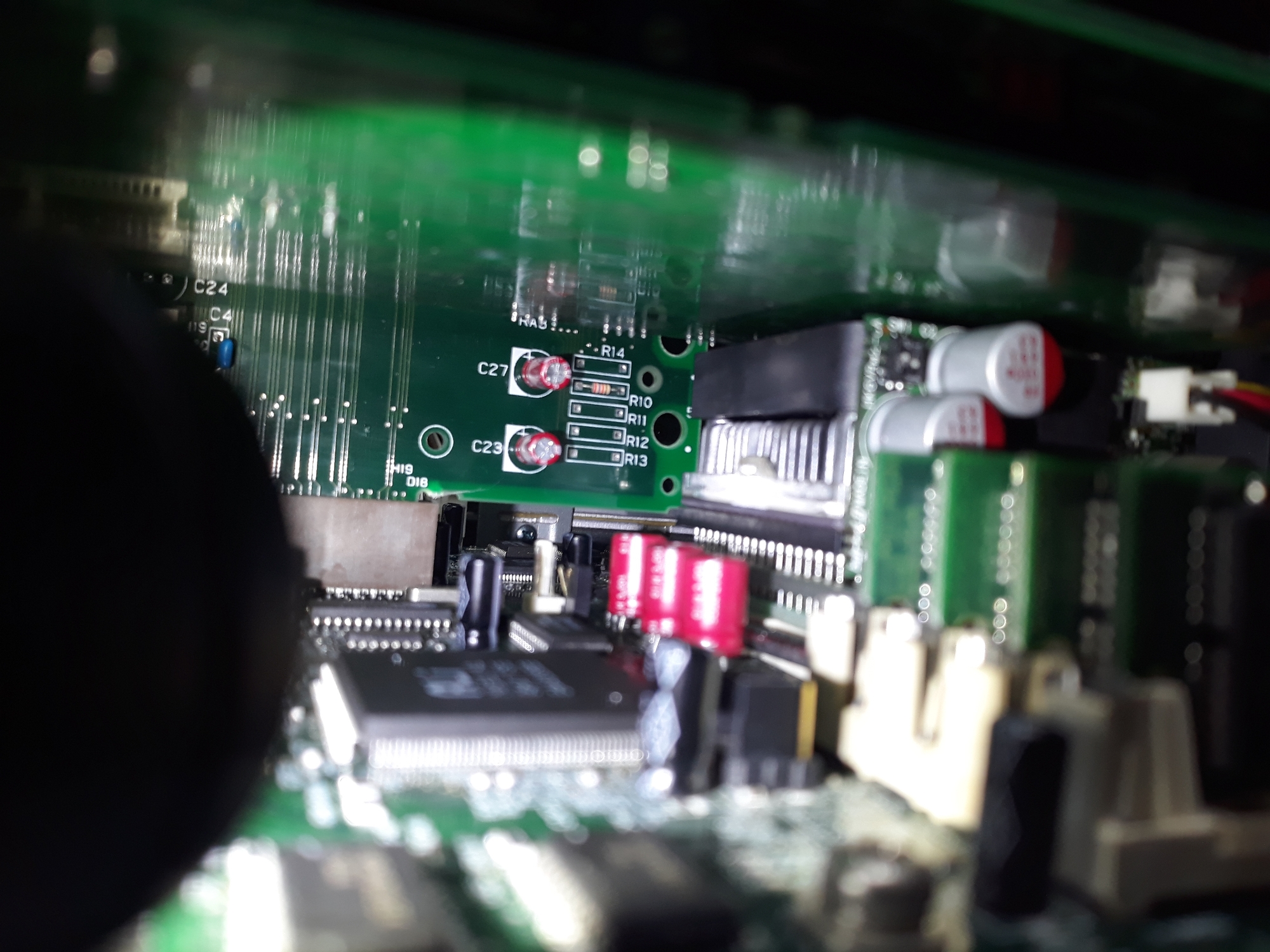

And 291 capacitors being replaced. I thought it would never end..
AT? what is this thing GiG?
Belongs to a customer of mine, it's an FMVTowns with an FMTowns compatibility board on it, which is basically a 386DX-40 SBC on a PCI card. It works a bit differently than a normal SBC though, the motherboard is custom and has a special ribbon cable that routes the IRQs and some CPU signals to the compatibility board so it can inject itself into the host motherboard and use its resources. In FMTowns mode, the SBC makes use of the ISA and PCI buses, as well as the hard disk controller. It has its own video output, which works very much like the 3dfx Voodoo1 and 2 with a VGA passthrough cable.
My customer obviously had decked it out with maxed out RAM and the CPU interposer, which allows use of an AMD K6/2 400 over the original board limit of a Pentium 166. The original PSU was grossly overloaded and causing system instability, hence the modifying an ATX PSU to work in its place. But it had to be that specific Antec PSU because the machine needs the -5v rail. I also had to recap <everything> except the motherboard because I ran into some weird problems with it. I did replace all of the important ones around the CPU socket though, hence why they're all red. They're all high quality polymer caps that can take the heat and will last for a long time. The three caps on the interposer VRM were also VERY bad and pissing out electrolyte everywhere, these were also replaced with polymer caps.
