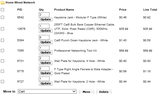

So here is what I am looking at purchasing... so that is a little over $100 including their professional toolkit which has some patch cable terminations, crimper, punchdown tool and wire cutters. Then another $20 from amazon for a small 5 port unmanaged gigabit switch..
Looks like you got everything you need. You're doing 3 runs, correct?
Correct.. plan is to do three runs from the office... two of which will go to the front room and the third will be run to the bedroom. Xbox One will have a dedicated line to itself in the front room with the other devices sharing via the switch mentioned. Same thing will more than likely happen in bedroom too (TiVo, AppleTv, etc.) and will share singular line via a switch. Hoping the doc gives me the OK to start weight bearing this coming week so I can crawl around under the house before the weather starts.
