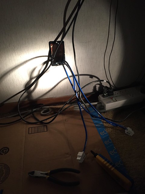

As promised here are some pics... drilling the exterior walls was more of a bitch than I anticipated...
Patch panel in office ended up being three different holes, one ended up going through subflooring, between siding and outside the foundation, another went into foundation and stopped, finally attacked from below with the flex bit and that was the money shot!!
Last night got the lines pulled from the office and only ended up doing a total of four lines as I was limited on space with the 9/16 bit. Ended up pulling the two lines to the living room, one to master and final is just and extra that can be routed if I ever feel necessary. At this point the wife said to get rid of the Wii in the room (unplug and store, not toss), so that only left the TiVO and AppleTV needing connectivity for the master. Doing this on my own with a still healing leg was interesting to say the least and probably took me a lot longer that it really should have. Doesn't help that all this stuff is at the middle or front of the house and crawlspace access is at the very rear.
For now the office is wired (have one last patch cable to finish and test), lines are run to where they need and living room has been patched, with its lines run. Tonight will be cutting the hole in the wall for the master and stringing the rest of the line there and then all will be done. I will get some more pics tonight from under the house. Decent amount of room, lots of cobwebs but nothing overly bad and luckily did not see any issues (mold, unknown water leakage, etc.) from the cursory look I did.
