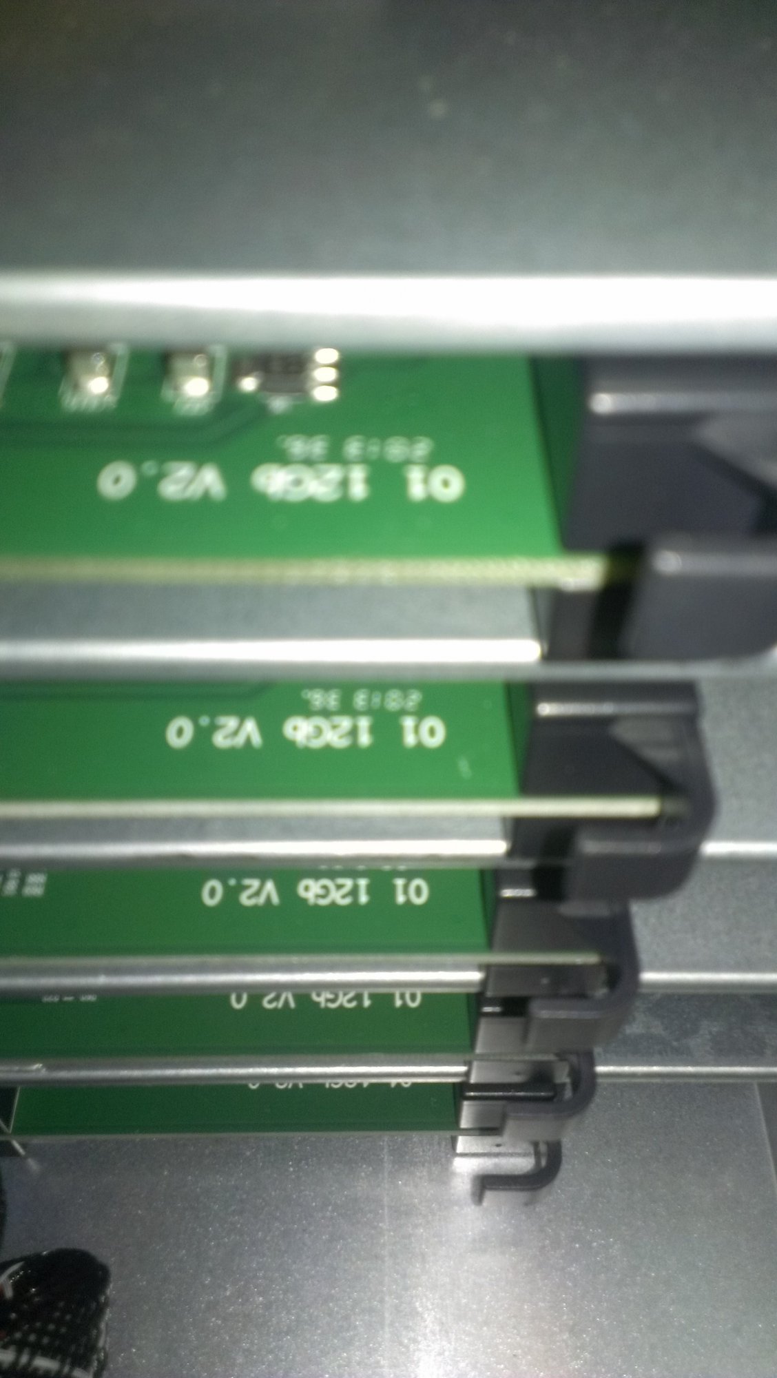

These are the trays that came inserted in mine: (please pardon the shoddy rushed pictures)
Maybe I am just having a moment of the stupids, but I don't see anything that can slide or fold to close off the airflow.
Oh well, nothing a little duct tape can't fix, through that looks kind of ghetto.
I am going to be using all the bays though. 12 5400rpm reds, and 4 SSD's in the backplane, and one 5400rpm green and an SSD mounted behind the 5.25" bays for a grand total of 13 hard drives and 5 SSD's
The backplane will be connected to two IBM M1015's flashed to IT mode and forwarded to my FreeNAS Guest. It has a single ZFS pool with two 6 x 4TB WD RED RAIDz2 vdev's, a mirrored pair of Samsung 850 Pro's as a SLOG for the ZIL's and (soon) another two Samsung 850 Pro's striped as L2ARC cache devices.
The SSD and 3TB Green behind the 5.25" bays will be connected directly to the on board controller and used for ESXi boot and datastore.
