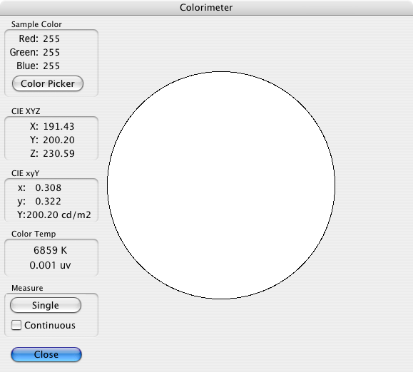

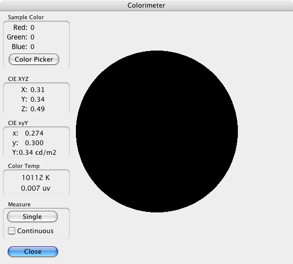

It can be seen visually, but I just did some manual measurements. The colorimeter was placed in the center of the screen and wasn't moved during any of these measurements. Click on the numbers for screen shots.
This is with ColorComp off and calibration on:
Gamma: PRG
Color Control: P
White: 200.26 cd/m²
Black: 0.34 cd/m²
Ratio: 589.0:1

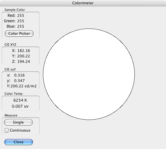

Then I turned off ColorComp and color correction and set the white level to 200 cd/m²:
Gamma: NON
Color Control: N
White: 200.22 cd/m²
Black: 0.29 cd/m²
Ratio: 690.4:1
As you can see, calibration also affects contrast. That's also pretty close to the advertised contrast ratio of 700:1.

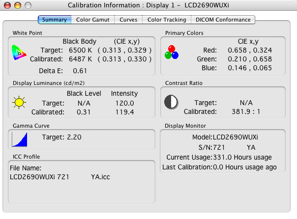

ColorComp level 5, calibrated to 120 cd/m²:
White: 119.4 cd/m²
Black: 0.31 cd/m²
Ratio: 381.9:1
Screen shot
The contrast ratio still suffers at 120 cd/m², but not nearly as badly. That's why Painman got similar results. There probably still was a difference, but the difference was probably less than 0.01 cd/m².

Interesting that the Delta E was much better for the brighter calibration
Delta E for the 200 cd/m2 = ~0.2
Delta E for the 120 cd/m2 = ~0.6
Is this typical?

The problem is the results are different every time I recalibrate, so I don't know if that's typical or not. I've gotten 0.6 at 200 cd/m² before. The black level seems to change as well. Sometimes I get 0.34 cd/m². Other times I get 0.37 cd/m². I'm not sure if it's the monitor fluctuating or if it's the calibration method used by the software or if it's the colorimeter fluctuating. When I do manual measurements, the results seem to be consistent enough during the time I test it, but when I come back later, the results change a little.
I'm also not sure why recalibrating brings back some of the lost contrast because the black level should already be as low as possible before recalibrating. Since hardware calibration also affects contrast, that can only mean the white level isn't lowered as much when calibrating with ColorComp on, so the contrast doesn't suffer as much. I don't know why it would do that unless ColorComp happens to make the area I'm measuring closer to the target color temperature. I guess that's possible.

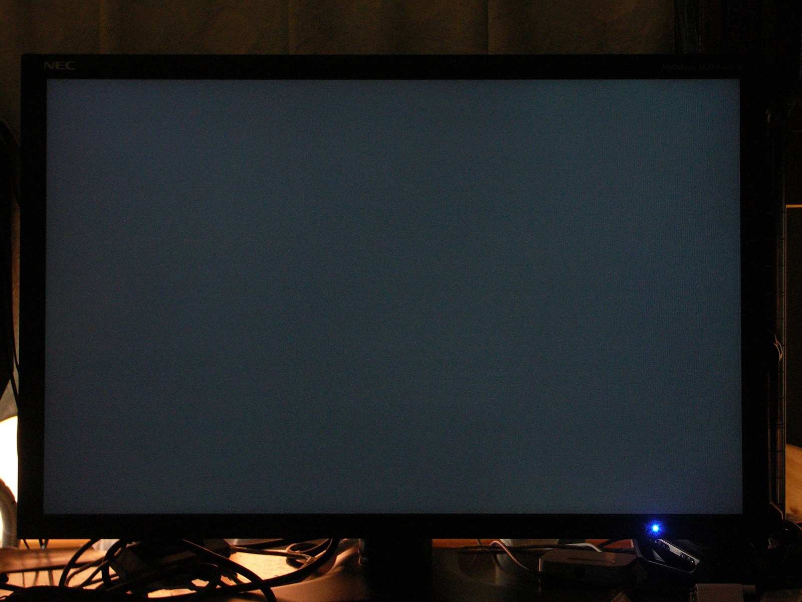

I received my 2690 yesterday. I noticed when doing the dead pixel test with the black screen that the backlight is not as uniform as the Dell 2407 I had last week for a few days.
Is this just the nature of the panel type or the backlight that NEC uses? Also the screen looked uniformly darker with the Dell.
I don't notice any backlight issues in regular use (although very limited use at this point). Is the backlight evenness more important in certain types of use? I won't be playing movies or many games.
My 2690 (US) is a rev. 4B. Has zero pixel issues as far as I can tell.
I can only hear a high pitched hum if I have my ear in the back of the monitor about 3 inches from the case, top right. From the front I can't hear it, and the sound from my computer and UPS is much louder. Same thing with a lower pitched noise that I hear in the back top middle of the monitor.

zoner3:
Congratulation with new screen! :D
I'll start with your questions:
1. new 2690 backlight uniformity question
Its very hard to answer this question, since there is little detail about what kind of backlight uniformity issues you have.
Take a picture if you can and also try to use colorcomp to see if the uniformity changes.
Check out also this link about the 2690WUXi and backlight.
Only on colorcritical tasks does backlight eveness matter. Even there there is a level of tolerance, but very small. The rest is based upon how intrusive they are.
My screen is uniform (even with colorcomp off) and so is many others in this thread, so I can safely say they can be.
The NEC with its colorcomp should bring you within the level of tolerance, providing that this is true:
ColorComp automatically optimises uniformity of colour, brightness and gamma distribution over the whole area of the display. To achieve this, every single panel is subjected to highly precise measurements during manufacture, and optimised within the hardware of the unit. The operating time of the unit, the temperature and the alignment of the display (horizontal or vertical) are taken into account for active optimisation. NEC Display Solutions has expanded the colour space of the new SpectraView® 2690 to provide ideal conditions when working in the pre-press, DTP, soft proofing or general colour-critical image processing fields. 91 percent of the NTSC colour space and 95 percent of the Adobe RGB colour space (size comparison) can now be accurately displayed.
link
I'd very much would like a comment from Travbomb on this one, especially regarding the cases of backlight issues in this thread.
I'll stop ranting now about this. Test colorcomp and provide a picture, and I'll see what I (and us others) can make out of that picture. :)
The CD contains: Drivers, manual and programs (gammacomp, naviset and long cable program). I don't know if they ship units with it outside of Europe.
Try the screen with movies and games too. You'll be positively suprised! :D
There is something wrong with NEC clams that they use "Grade A" panels.
2690 is the only display with this LG.Philips panel and I wonder where they send "Grade B" panels !
Maybe they use "Grade B" panels for MITSUBISHI Diamondcrysta RDT261WH.
After I posted that I talked to NEC tech support and tried Colorcomp. It did even out the backlight. It seems with Colorcomp on the Delta E goes up about .4 - .5 .
I will try to take a picture of the backlight tonight. It is too bright now in the room. Also, I need to try it with the Spectraview black test screen. In a passing look last night it seemed that that black screen may be darker than the Dead Pixel Buddy black screen. It shouldn't be (I think), so maybe it was just my imagination. I am also now doing testing on my main photographic editing computer. The first day I received it, before I made the decision to keep it, I installed it on my other computer which has the AGP version of the video card I am using on my photo editing machine, which was just rebuilt, and has a PCI express video card.

I looked at the new post with the link to a new Japanese review and the front backlight pic of the 2690 in that pic is similar to my 2690 (with colorcomp on) if you flip the right and left sides.
Tamlin_WSGF said:
backlight uniformity issues can happen to all types of panels and also brand. Its not a panel issue
You make it seem like backlight bleeding isn't more common with certain types of panels, which directly contradicts my experience and the experiences of others.
Explain to me why every 23+" IPS monitor I've tried had the same kind of cloudy backlight bleeding. On every one of those monitors, I noticed the panel was secured unevenly in the same manner. Some areas were loose while other areas were tight, which caused warping. I could move the uneven areas around, but I couldn't get rid of them. Painman noticed the same thing on all three of his displays. I've only seen that happen on monitors with IPS panels. I've never seen that happen on monitors with PVA panels. Are you implying this is all one big coincidence?
Explain to me why so many people complained about the same kind of cloudy backlight bleeding on the Dell 2005FPW, which has an S-IPS panel, yet hardly anyone complained about any kind of backlight bleeding on the Dell 2405FPW, which has a PVA panel. Here's an old picture of my 2405FPW in the dark with no backlight bleeding: http://www.toastyx.net/2405fpw-dark.jpg
Explain to me why many people have complained about backlight bleeding along the top and bottom edges of monitors with 22" TN panels, regardless of brand.
Based on these and other experiences, I can only conclude that backlight bleeding is more common with certain types of panels than others.
I'm also tired of people blaming the problems on bad luck. The problems are common enough that people have received replacements with the same problems. That's not bad luck. That's bad manufacturing.

ColorComp does not affect backlight bleeding, at least on mine.
You also make it seem like this problem isn't common even though several people in this thread have seen the same kind of backlight bleeding on this monitor.
sosrah said:
Even the first picture in this review shows what I'm talking about. Both monitors have IPS panels, and both have that cloudy backlight bleeding, although their 2690 seems to be much better than the ones I received. There's still some backlight bleeding though, especially in the top right.
I also recommended a 23" Apple Cinema Display to someone on this forum, and his also had the same kind of cloudy backlight bleeding. Then he got a replacement, and the replacement wouldn't even turn on. I hesitate to recommend any monitor now.
