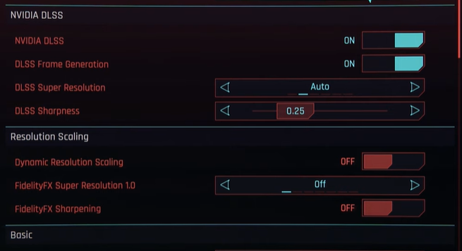

Shown here (from Spider-Man Cyberpunk)
Shown here (from Spider-Man)
cool, I didn't realize that disabling Frame Generation meant you are reverting back to DLSS 2...so Nvidia seemed to realize that DLSS 3 was not this amazing new tech and put that in as a backup...otherwise why put Frame Generation as a separate toggle?...usually DLSS is just enabled or disabled universally and you aren't able to revert back to previous versions

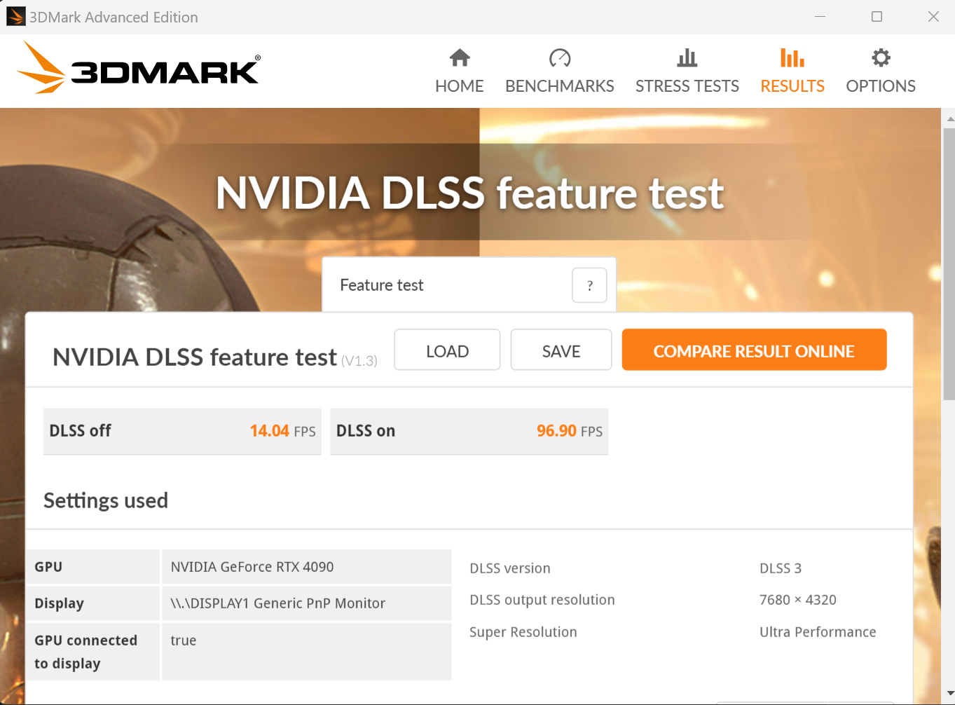

Looks like it injected a bunch of fake frames, which it should not be counting. 14.04 frames with no DLSS to 96.90 frames with DLSS 3, I would suspect with DLSS 2 would be around 30 frames. Can you run it with DLSS 2? Would be interesting because then you will see how frames were injected to hit 96.9.
What exactly is a "fake frame" to you?
It's the static frame being generated not by the game or program but by the DLSS software itself, the whole gain of DLSS 3 is frame injection on top of the normal DLSS gains. Or do you guys just not pay any attention to the software and hardware you keep telling everyone is so great?
So anything not rendered traditionally is "fake'? Yeah, maybe you should look at your last sentence again ;).
It won't be fake frames once FSR 3.0 is released.
I dont even use FSR on my 6900xt, I wont degrade image quality for FPS I don't need. At 1440p it does everything I need, but keep on trolling.
FPS you don't need? I too love raytracing at 17fps on my Radeon! Don't be coy. We all know you'll be extolling the virtues of frame generation when amd can do it too.
Show 1 post of me extolling anything FSR or DLSS, I can find 1000's of your only extolling 1 side of the GPU world.
Eventually, sometime in the future, fake frames are perceptually lossless relative to real frames.
Once that happens, it doesn't really matter if fake frame versus real frame.
