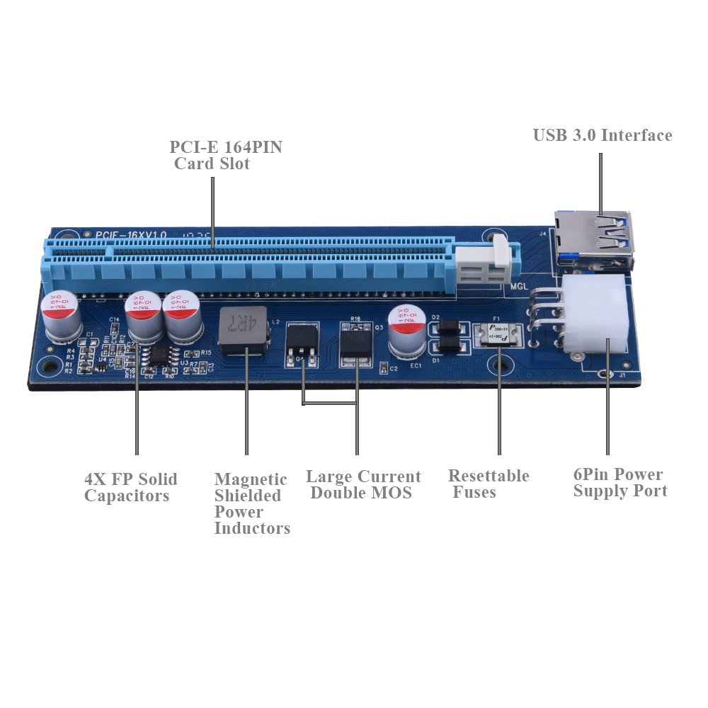

Seen pics of some 2017 risers that appear to have an extra pair of MOSFETs, maybe to deal
with the regulator overload. Don't own one like that yet, so can't confirm or deny.
I probably ought to put little heatsinks on mine that havn't cratered already. Spend for a card
with real power from above may be cheaper than trying to bandaid this problem from below.

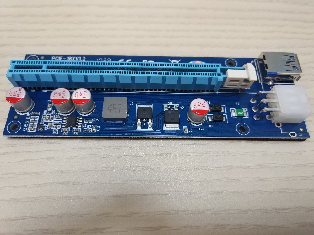

Most have lil 8pin buck chip on the 6pin end of the riser. w 1050ti, a crater wating to happen.
I've blown out two, and maybe thas just bad luck or bad quality, or maybe not made for 75W.
The one I'm talking about has Q3 Q4 helping, again thats not owning one yet to say for sure.
Older MOLEX risers omit this buck converter and may not be a problem. But you still should
never connect more than two 1050ti a peripheral cable, and probably not more than one.
Your 850W supply is a good size for qty8 of 1050ti, my rig draws 550W from the wall.
But careful how you distribute the GPU load, or modular peripheral connectors will burn.
That does seem to be what they're claiming. Looks like it's the version 007C of the riser...

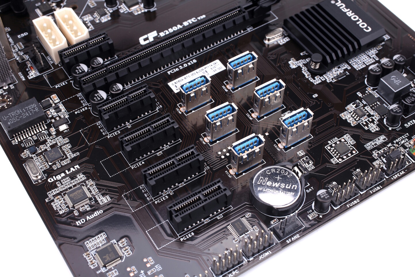

One Onda D1800 BTC
One 4way PCIe switch (probably ASMedia under that sink) styled 4 upcie cables to one mobo slot.
Qty5 SIPOLAR ver007C risers (thinking with six GPUs, one could go directly on my B350+ mobo)

And maybe I junped the gun a little, as it appears that an 8GPU Onda definately exists. Can find no
link to actually buy one yet, but philipma1957 over there showed off a brand new shipment of ten...
Upon viewing a better angle, I now see four additional 1X slots (for risers probably) across the front edge.
And something about support for 16GB, maybe DDR4? The Celeried six slotter maxes at 8GB DDR3.
Found the manufacturer link by increment of existing product number.
http://www.onda.cn/MotherBoard_Specifications.aspx?id=373
http://www.onda.cn/Shopbuy_MotherBoard.aspx?id=373
At time of this post, ¥1099Yuan figures to about $165USD.
What I'm assuming maybe a buy button, google translates [Sold Out].
Sais there 8GB DDR3L? Don't match what was quoted on bitcointalk.
Page could be work in progress with obsolete copy/paste from D1800.
Much clearer photos anyway. Can someone who knows laptop DDR4
zoom in and tell us if that SODIMM is DDR4???
I see an HDMI connector, and button labeled CMOS_BT in the same
corner location the previous board hosted a power button...

What do you guys like that's MicroATX, has 4 PCIe slots and between $50-$75?
I'm looking at Biostar H110M-BTC - it's $75
Need to do away with 1x slots on small mining boards.
A cluster of USBPCIE with bright orange warning plugs
would use up a lot less space, and improve reliability by
bypassing the adaptors.
One Biostar already did this, but only for the 2nd row.
Don't appear to be an option they actually sell though.
They do occasionally tease impractical prototypes.
Each PCIEUSB standing vertically with little support to
accidental bend-over. For strength, they probably ought
to be in pairs with some finger space between pairs, if
not flat off the front edge in stacked pairs.
So obvious, amazed its not already standard practice.
All I can think, they must worry some idiot will plug USB.
No slot is going to stop an idiot, they always find a way.
----------------edit---------------
My bad. It was a Colorful, and they do sell it.
http://www.colorfly.eu/iGame/C.B250A-BTC PLUS V20.html
At very least they might consider dropping a plastic shroud
over that PCIEUSB cluster to prevent a bending accident.
Or could it be stronger than it looks?
Notice in the photo "UPCIE", is that the official abbreviation?
I havn't been consistant in what I've been calling it up till now.
Wasn't even sure it had a name.
