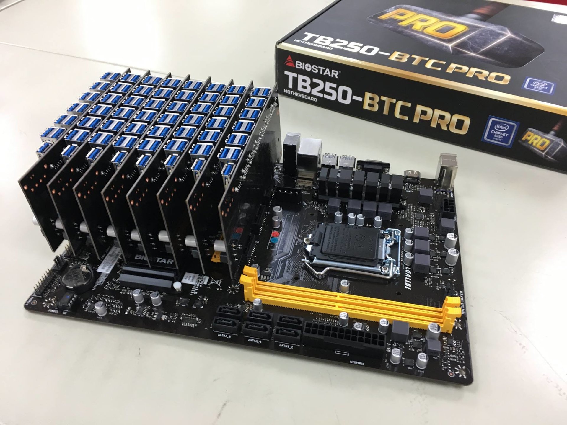

Well, lets forget about ATX form factor and talk about real mining motherboards for a second:
My next puchase would first depend on choice of power supply.
For PC supply: The six slot Onda D1800 BTC at $135 with embedded celery looks to be a steal.
For Ant Supply: Eight slot Colorful C.B250A-BTC PLUS V20 for $190 seems well thought out.
The Colorful board is Ant powered from one side, and a 4pin near the CPU that never seems
to have anything attached in any build photo. Another row of 6pin powers across the front are
not inputs, but convenience outlets for routing to the top of individual GPUs.
Its less clear wether the Onda's front power headers are ins or outs. I'm thinking ins...
Both these suffer from fixed 3slot spacing. Which seems a little tight for optimal ventilation.
Certainly anything dual fan RX580ish isn't going to enjoy being packed quite that closely.
But low power 1060s would probably do just fine. DIY Pandabox...

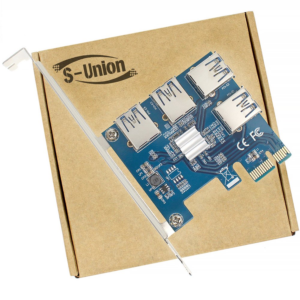

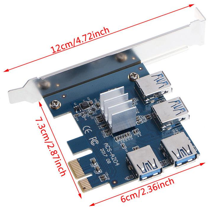

Or for $30, an ASMedia switch can expand almost anything to become a mining platform...
Again with the three slot spacing, but you can buy a switch and individual risers separately.
Switch cards come in many shapes, not all make sense...

The slots on the Onda and Colorfull motherboards are close enough together to make thermal management a pain - both get a workout in the "phillipma1957" 6'th thread on bitcointalk.
Post #443 of that thread clearly illustrates the crowding problem.
https://bitcointalk.org/index.php?topic=2138550.443
Reference blower cards might be less trouble for this packing.
Otherwise populate every alt mobo slot, + maybe three risers.
I've got 8x 1050ti's thermalling fine while all crammed together.
Not on Onda mobo, on risers. Be extra careful how you must
deliver power to multiple "Low Power" GPUs from below. The
peripheral power cables and modular supply connects smoke.
I imagine you could smoke a motherboard just as quick...
When I had five non-reference AMD RX packed at threeslot
spacing, there was no keeping any GPU (except one that was
watercooled) from overheat. Its just too tight and not practical.
The Onda is $104 on Ali right now. Which is excellent if you like
embedded Celery. But the price of four way ASMedia switches
is down to $13. Any junker motherboard with such a switch can
space risers to your preference. Maybe the better deal.
Few $ more on the egg, ebay, amazon. Easy to find though.
Easy to find? I just hit ebay, newegg and amazon for ASmedia Risers and ASmedia switches with nothing like that coming up. I found them on ebay with the cheapest US person at $17 but in CA so it'll take a week to get to me. Some of the chinese vendors get me stuff in about that timeframe.
I have three Biostar tb250-tbc pro boards
12 GPU each
They work fine but when a riser dies it’s a pain to figure out which one.
I end up unplugging everything and plugging them back in one at a time for 24 hours to test. Is there a better way?
12 GPU each
