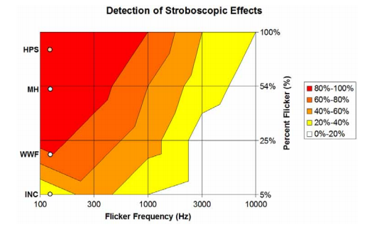

https://forums.blurbusters.com/posting.php?mode=quote&f=4&p=24880
Direct detection of flicker does diminish fairly early (e.g. usually below 120Hz).
However human indirect detection of flicker can approach 10KHz (ish) via stroboscopic side effects.
So, humans, can indeed see side effects from PWM even well into thousands of Hz, through various stroboscopic stepping edges. Here's an example of what happens when you combine PWM + motion.
Moderate-speed head-turning on 4K VR can yield 8000 pixels/second. Plenty of opportunity for stroboscopic stepping effects to still be visible. Due to the difficulty of lowering persistence while avoiding strobing (1ms persistence without strobing = 1000fps). We'll be stuck with stroboscopic stepping effects for a very long time to come (during stationary gaze with motion going past). Artificial GPU motion blur can be added to avoid stroboscopic stepping effects -- but that's additional motion blur above-and-beyond natural motion blur in the human brain. Lots of fascinating reading in this thread.
