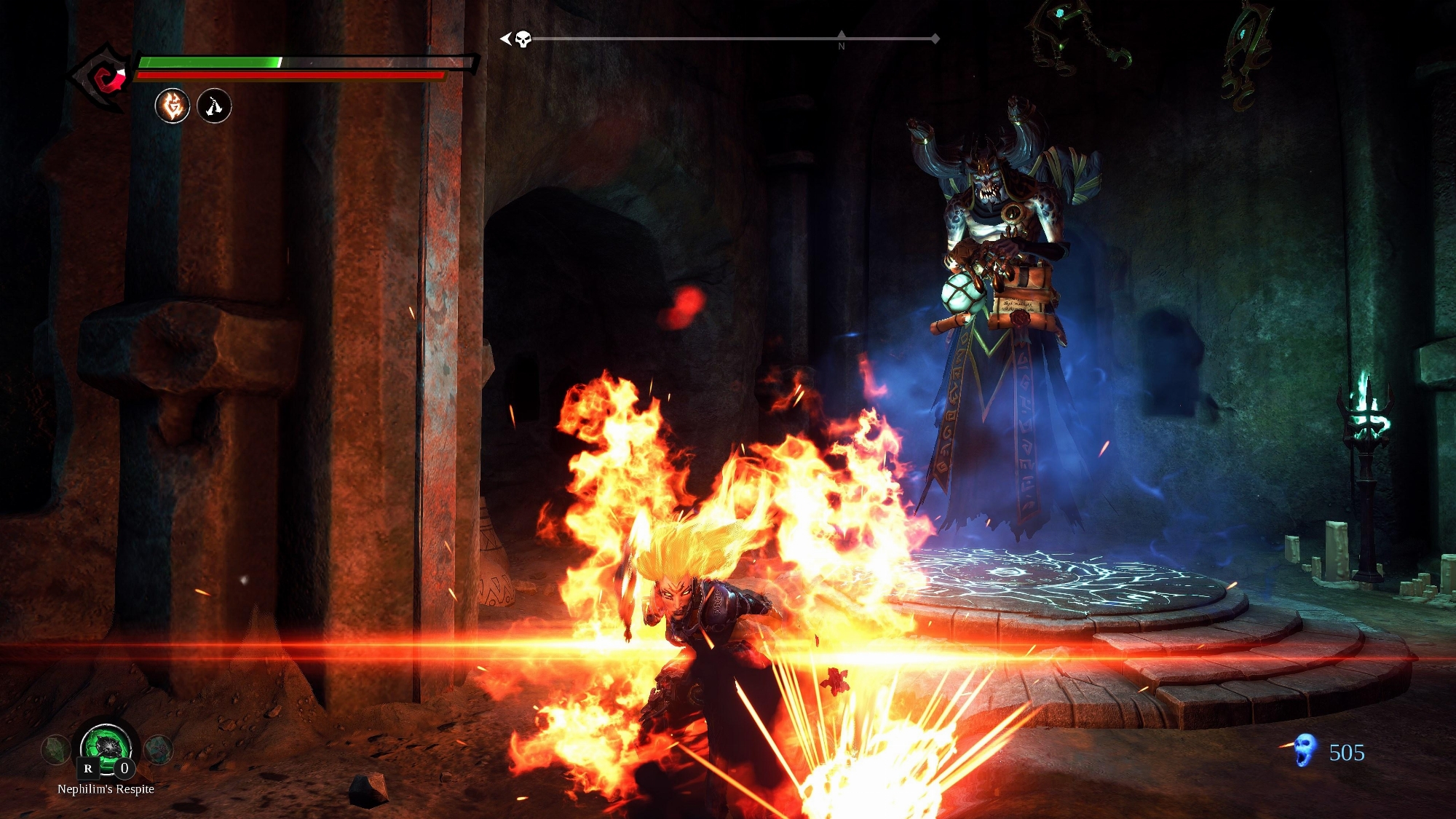

Screenshot of darksiders 3 with normal play settings I timed. It was tricky to get the timing on it.
Another screenshot I timed here. You'd need an oled with same osd settings to see it like I do when I'm playing but I still thought the screenshots looked good on the 4k va tv next to my LG CX. That is with in game "performance" settings I use with only a few things not maxed (shadows on medium ,etc). Nothing amped up differently than I play the game with just for screenshot's sake that is.

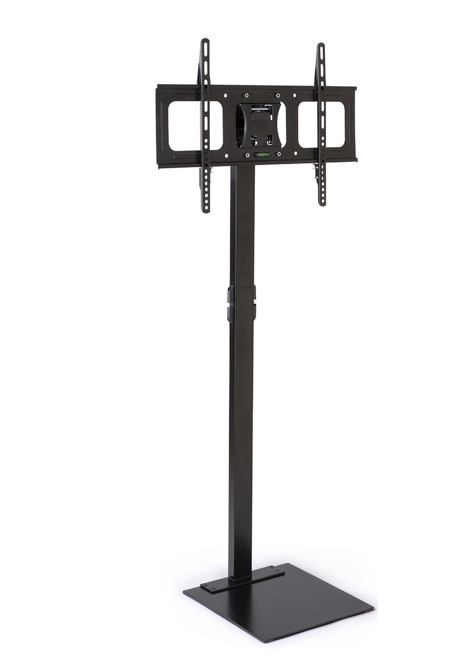

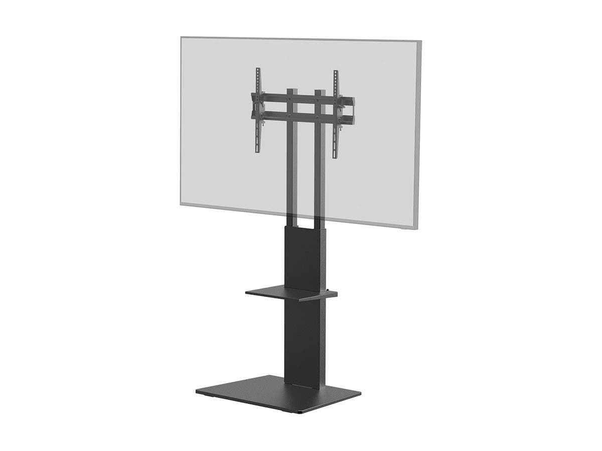

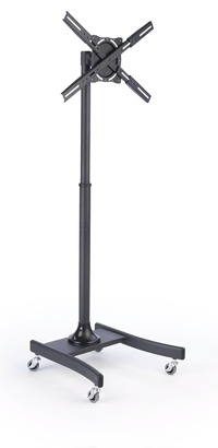

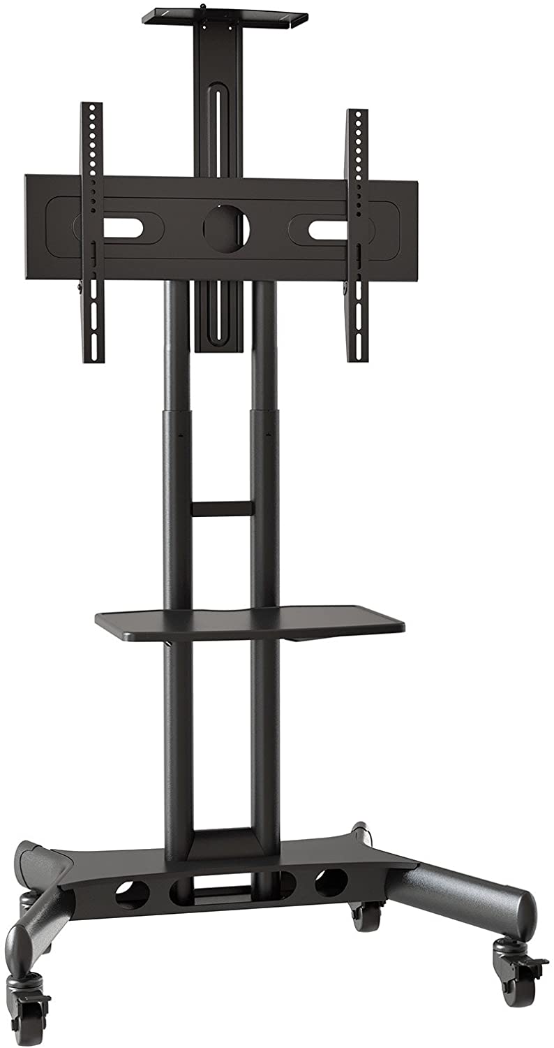

Picked a CX up from Costco, scheduled to be delivered today- hopefully not too beat up (please be kind, UPS). I had the option and considered a microcenter refurb, but knowing my luck I'd get a dud with 2000 hours on it already and have to drive it back; time is money. Much easier to test drive with Costco's 90 day return window.
Very excited, but not sure if it is going to work with my setup of a motorized desk with only a depth of 27.5". Looking through the thread though, some people have made similar desks work. Might take some experimentation with stands/arms to fine tune the viewing distance. Or I guess installing a sliding keyboard tray could be an option too. Going to be the only monitor so it needs to work for productivity and gaming (PC and Series X). Definitely appreciate all the information hiding in this thread- getting the CX48 set up and dialed in sounds very daunting, but nice to know others have done the heavy lifting already.
