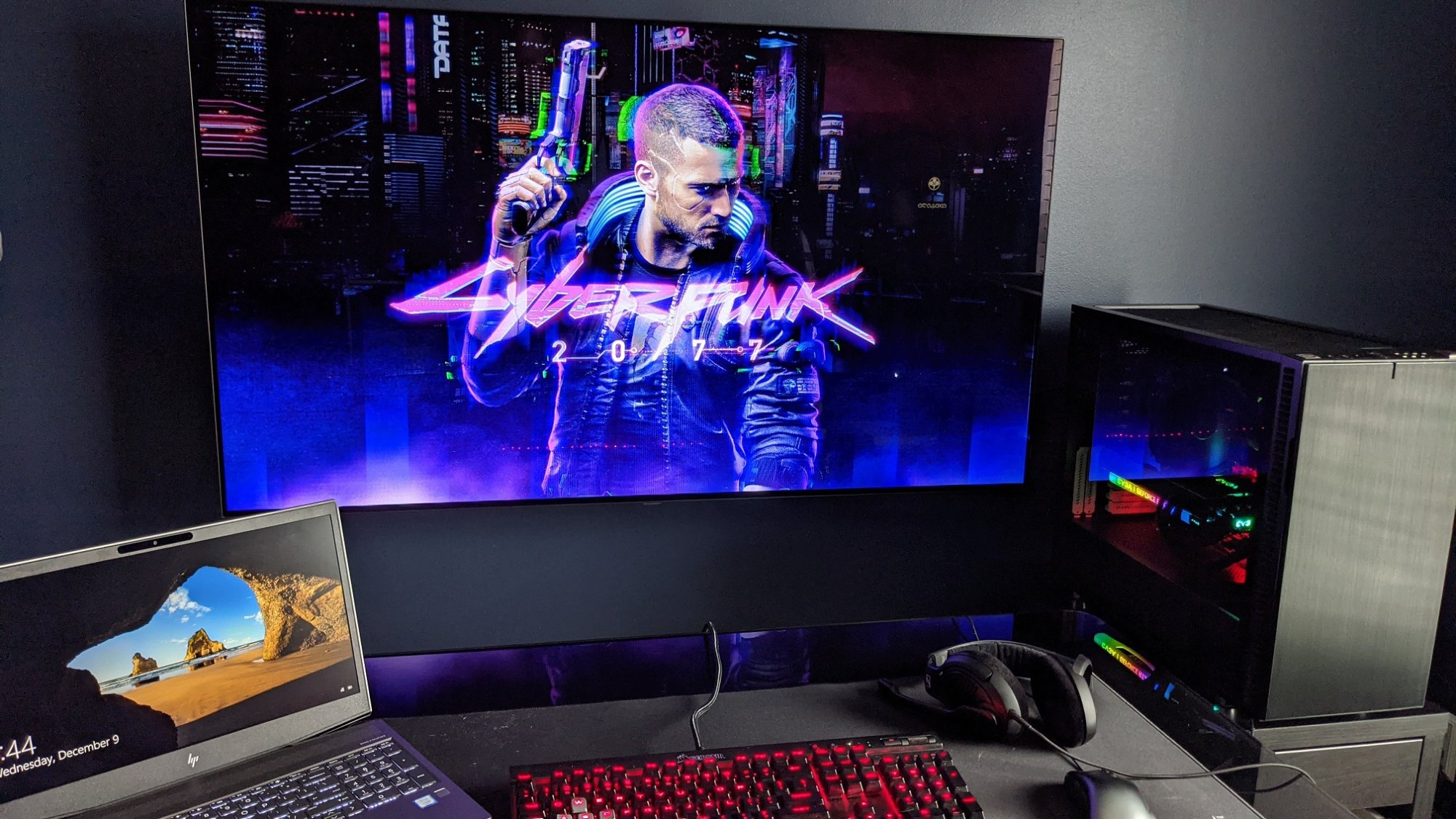

I fired up some Cyberpunk 2077 on my 3080 + CX 55. This display has never looked better.... unreal.

Have you tried HDR with CP and the CX?
CDPR did such a good job on Cyberpunk 2077 graphics that it really doesn't "need" RT. Honestly, on a 3080, setting RT off, DLSS to "balanced", and everything else to Max @ 4K makes this game a treat, both visually and in terms of performance.
I heard HDR is disappointing, pseudo-HDR, with settings leading to either brightened blacks or poor color treatment
I notice raised blacks in both HDR and SDR in it. I also have no idea what that "tone map midpoint" setting should be... I also don't know which of the HDR modes is "correct". I'm doing scRGB.
