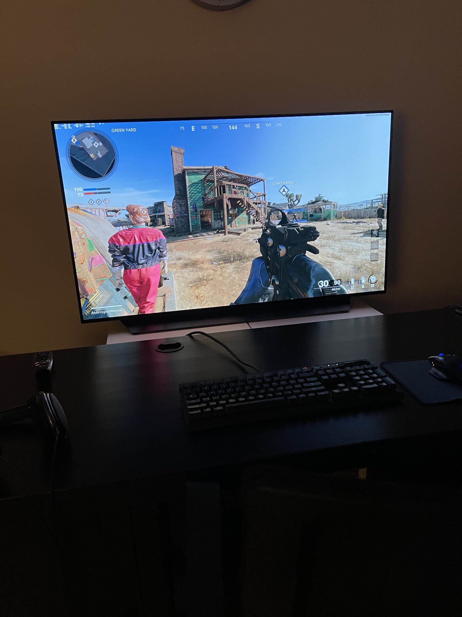

Whats that desk you have behind your desk to support the oled? Is that buyable somewhere?View attachment 304546View attachment 304547
All setup and I’m really liking it. One thing that’s bothering me, using my 2080Ti - the image improvement going from 60hz to 100+hz is huge (I felt the same way back when I had the first gen ASUS ROG Swift). So that means I have to run in YCbCr 4:2:0. I only care about gaming and while gaming i don’t notice a difference. But I do notice little things like the RTSS overlay isn’t quite as saturated of a yellow color compared to RGB 4:4:4. And the Lagom LCD test black level and white saturation images clip at the low/high end when using YCbCr 4:2:0. So this leads me to wonder what image quality sacrifices I’m making while gaming, if any. I’m sure there are others here struggling between the lesser of two evils, what are people choosing?
It’s two ikea nightstands that we bought but ended up not having a use for. I started using them about a year ago with my 43” Samsung as a temporary solution that ended up being more permanent than I expected. It’s a bit of a janky setup but it works.Whats that desk you have behind your desk to support the oled? Is that buyable somewhere?

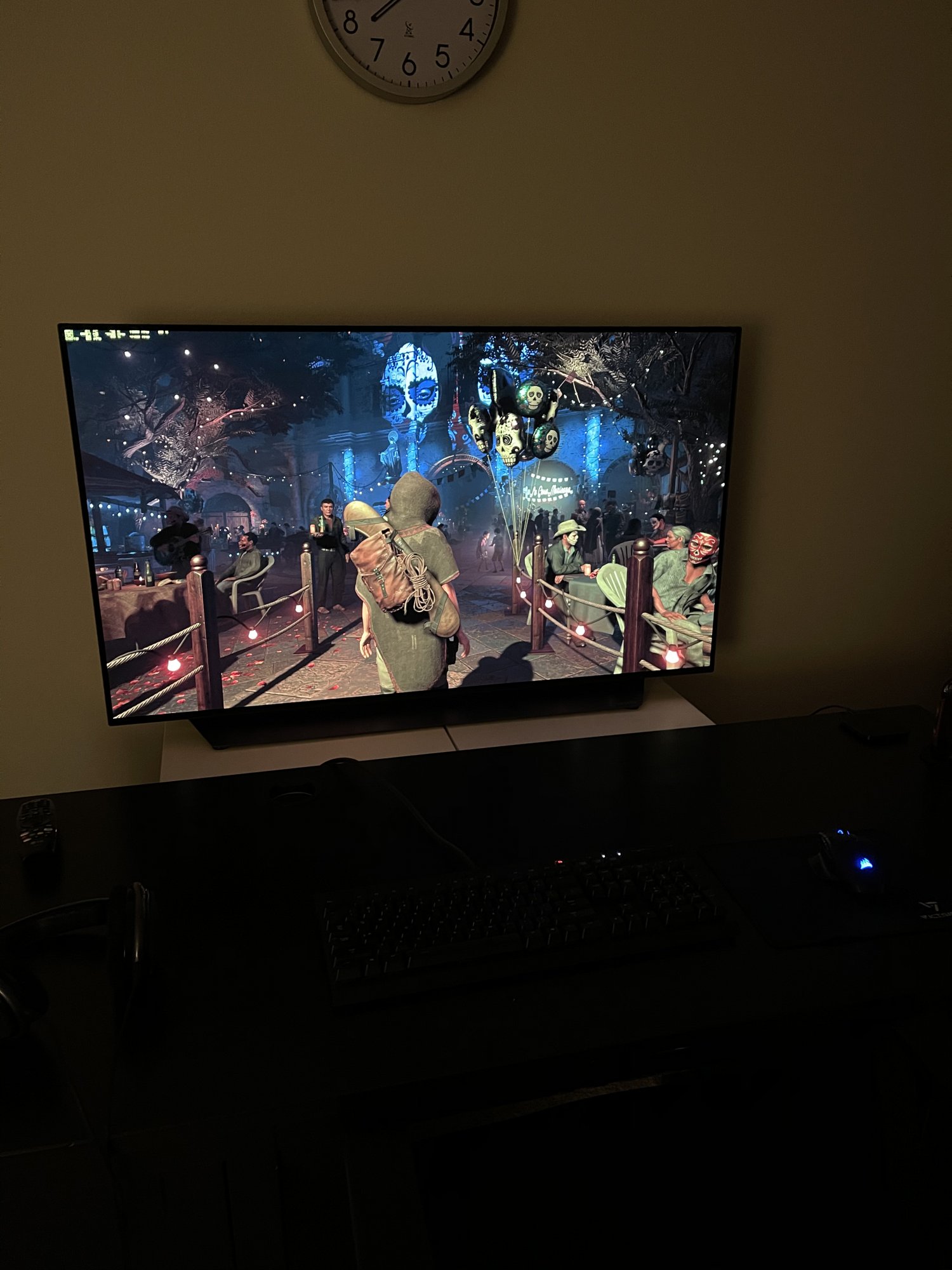

Not to go off topic, but what is the second picView attachment 304546View attachment 304547

Shadow of the Tomb Raider, I picked it up during the Steam autumn sale.Not to go off topic, but what is the second pic
Hey,
Not to derail, but what's the second game?
