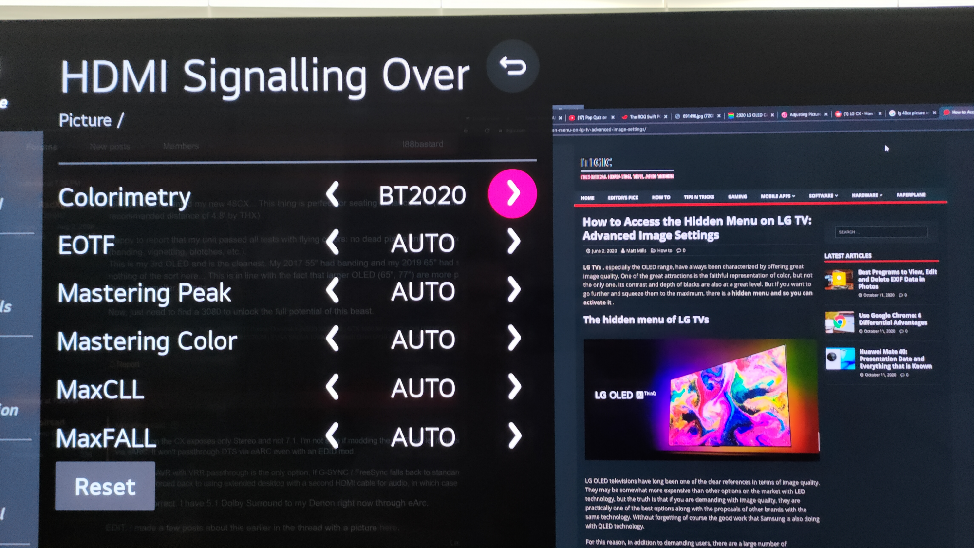

PSA TO Y'ALL......(except Elvn lmao)
Make sure you set Colorimetry in the hidden menu to BT2020, otherwise colors are washed out ass!
If you don't know how to get to hidden menu see post 4734 above
Didn't make much of a diff here, if at all.
Must've had it set to BT2020 manually without hardsettingthe flag.
You do not need to do this. The display detects changing to BT2020 just fine. If it doesn't, try going to 4K 60 Hz and back to 4K 120 Hz again. BT2020 should not be forced for anything but HDR mode and not even there.

The only issue that still remains is when enabling HDR at 4K 120 Hz it might output the wrong color space instead of BT2020. This causes washed out colors. This seems to be an issue with the adapter as this happened with both C9 and CX. The solution is to simply toggle back to 4K 60 Hz and then back to 4K 120 Hz. A few times if it doesn't stick on the first try. I use the ColorControl app for this to do it with a few clicks. I haven't seen this issue occur in games, only on the desktop.
