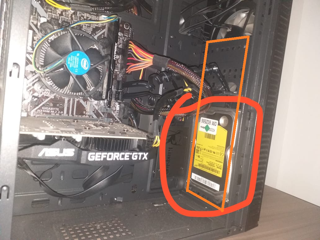

Okay, so your case is crap.
You have 3 intake fans sandwiched between a sheet of glass/acrylic on the front, and a large sheet of metal behind them. What are they exactly supposed to do?
Step 1: Remove the acrylic from the front if you can. (Does it pop out or something? That'd be best)
Step 2: Remove the Hard Drive from the front, foam tape it to the case bottom or something, that's NBD.
Step 3: Dremel the fuck out of that sheet of metal. Remove the entire section I drew on in orange.
After you do that, your fans might actually be able to blow some air somewhere.
Yeah, the case is bad. Inexperience got me here. I trusted the guy at the shop to pick it for me, since 90% of the cases looked the same.
All right then, I'll start by installing the fan on the rear and removing the acrylic on the front. Then I'll carry out the more drastic changes. Thanks again.
