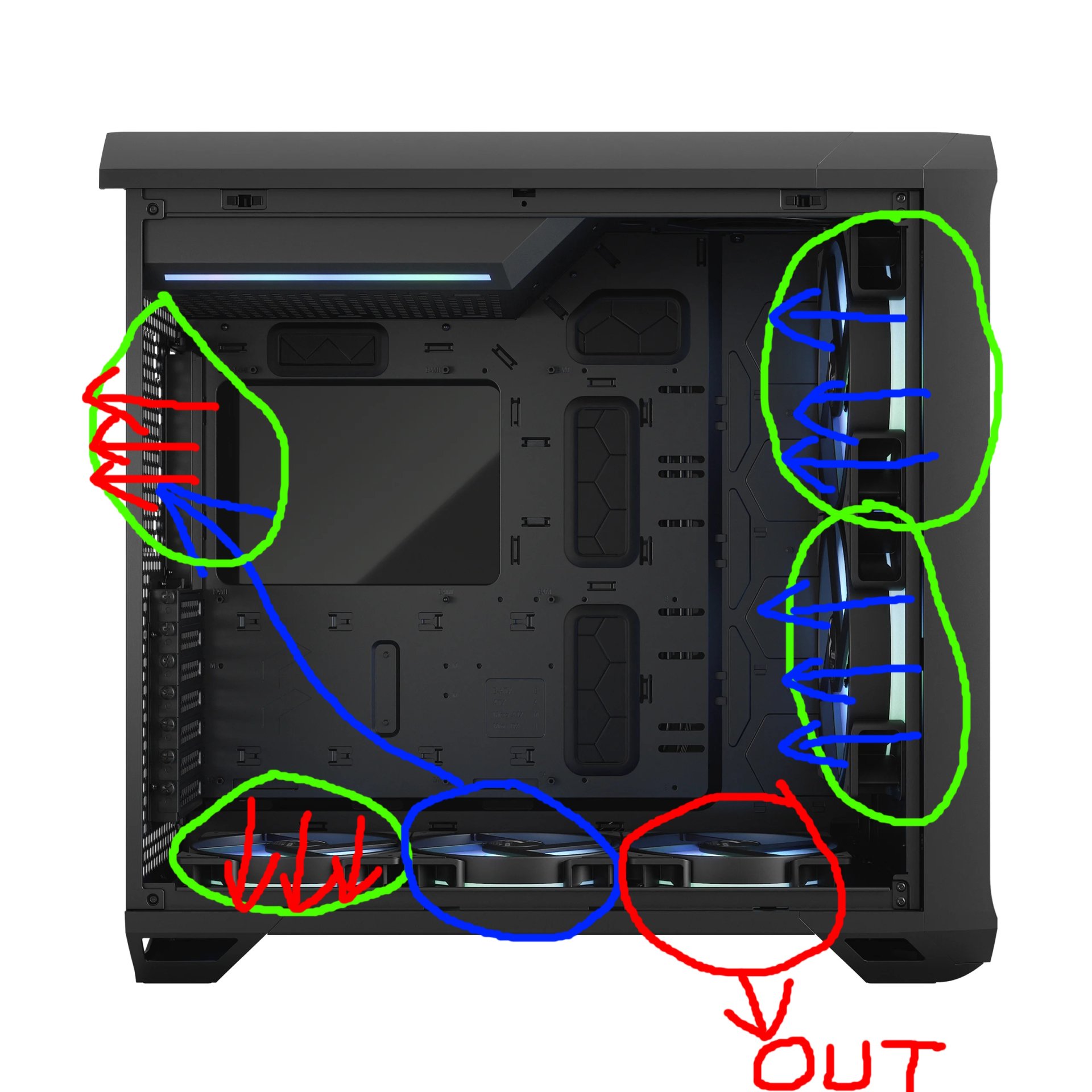

Everything I drew is better than the default fans fractal torrent configuration.
What the heck is this.Everything I drew is better than the default fans fractal torrent configuration.

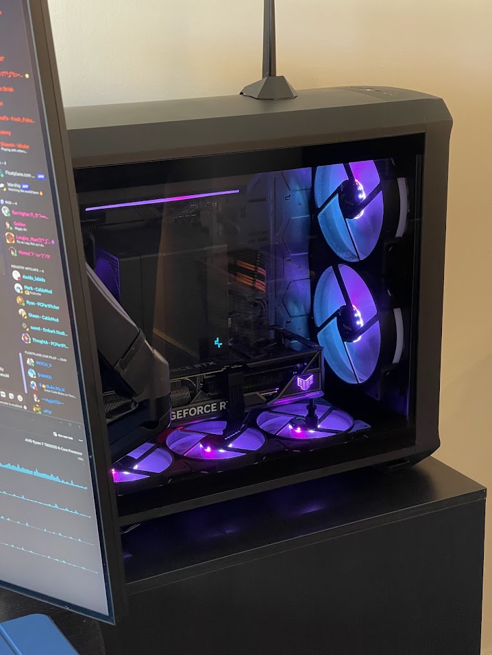

The window is good when you put it outside,at least for me,I have an inwin 303 next to the table on the floor.The case is great from the outside, I can even buy an additional hard side without glass, solid, I even contacted inwin, but I gave up on the purchase.It was quite expensive with shipping from the Netherlands.I guess I'm one of the few who hates windowed cases...I always prefer solid side panels and little to no RGB bling...which is why I went with the full sized Torrent with solid side panel
The potato pc is in my desk so it can't even be seen from the side,only the front and back have access.

No thanks, I prefer cool air being directed at my GPU. Without them it suffers.You people with torrent "should" remove these fans at the bottom, possibly leave one and put one on the rear.
That diagonal makes no sense if there's a GPU in the way. This is a recipe as a dust-magnet. The Torrent is inherently a positive airflow case. If you think this a better way, at least provide some temp measurements for convincing.Everything I drew is better than the default fans fractal torrent configuration.
I knew you would put that, that's why I put you people on purpose.
You're giving advice on a case you do not own?You "should" try it, I don't have that case.

Without data to show of your own, “should try it” is not enough for me to take time to do it. Especially if it’s only a curiosity exercise for you who does not even have the case. However, I’m genuinely confused as to why you think this config would make any improvement to the default.You "should" try it, I don't have that case.

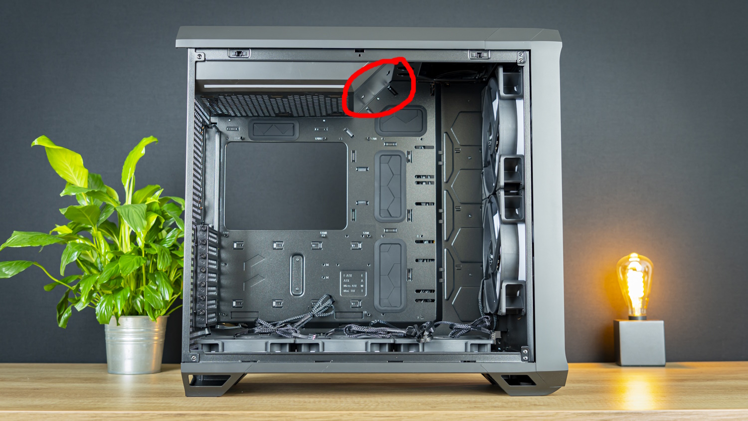

How would that help? The power supply pulls in air from below, and there'll be a ton of power cables right there in most configurations. Unless your case is saturated with hot air due to poor airflow configuration, the air it gets shouldn't be hotter than 80-90f, which is well below safe operating temperature of a PSU.How do your power supplies behave, I guess they can withstand higher temperatures unlike other components?
It would be a little better if this part was also perforated.
That would just lead to the cable area.How do your power supplies behave, I guess they can withstand higher temperatures unlike other components?
completely fine since it has a big ass (visible) grill to breath through....How do your power supplies behave, I guess they can withstand higher temperatures unlike other components?
