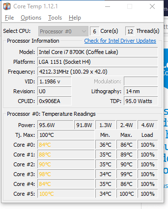

Hello,
I have recently completed my first mini-ITX build:
Fractal Design Node 202, Asus Rog Strix Gaming Z370-I, i8700K, CPU cooler Cooltek LP53 with Noctua NF-A9x14 fan, no GPU, Corsair Vengeance LPX 3200MHz 2 x 16 GB, Samsung EVO 970 500GB M.2 SSD. The CPU has been delidded by another guy, I have polished the CPU's lid and have used Thermal Grizzly Kryonaut between the cooler and the CPU. Yes, there's no external GPU because this computer has been built for musical purposes and the hope of lower noise, power consumption and weight in comparison with a similar build with an external GPU. If I can run my programs smoothly with this configuration, I 'll probably put everything into a smaller device to make it easier to move.
I want to overclock this computer. First, I have tried to see to see how it behaves when pushed to its limits. So, I have just run Prime95 and a Torture/Blend test along with Core Temp, and the temperatures haven't really stabilized after 5 minutes. One core has even reached 100°C (see screen caption).
This raises many questions:
- Is it normal to reach such high temperatures?
- Should I run the test longer until the temperatures really stabilize or is it too risky for my CPU?
- Should I disassemble my CPU and my cooler and check the thermal paste spreading?
- Should I add some case cooling (I have 2 120mm SilentWings 3 fans at disposal) ?
Any advice?
Thank you in advance.
That's a very small CPU cooler in a small case. Try testing again with the case open and a small house fan blowing at the desktop, see what your temps are then. If they're still bad I'd try a larger heatsink to see if that's the issue, otherwise it's probably a bad delid job.
I had similar temp issues with my last small form factor build, getting enough air circulation can be a challenge.
Your 8700K has a TDP of 95w.
That Cooltek heatsink you're using is rated for a TDP of 100w.
You have zero thermal headroom to overclock. I'd investigate a better-rated cooler, or if you're feeling particularly daring and have a Dremel, look at installing a 240mm AIO with the radiator in the GPU compartment.
try undervolting the CPU to see how it behave regarding power and temps.. at stock it should be no issue depending on how hard will that CPU pushed..
the good things about intel chips since ivy bridge it's that they can really undervolt and still be able to sustain same stock clocks and even in some scenarios handle some overclock undervolted... (i know for experience with my old 3770K and 6700K). so I think that unless you are planing to change that cooler the best bet would be undervolting.
Hello everyone,
Thank you for all the answers.
In between I have tightened a bit the screws attaching the cooler to the CPU but I've been careful not to overtight in order to avoid crackling the motherboard. I have also installed the two 120mm case fans (Silent Wings 3). By the way, my IHS is already a full copper one and I have lapped it from start. I don't know how well/bad my CPU has been delidded. It was done by this guy.
Now the figures are better. The max temperatures are reached only during short spikes.There is no throttling.

The fact that it's a replacement IHS may also be an issue. If it's not machined properly it may not be making proper contact with the die. The fact that core #5 was getting so hot before makes it seem like that could be a possibility. After tightening down the heatsink a bit more, did you notice core 5 doing the same thing? It looks like from the second graph that it seemed to even out a bit after you tightened the heatsink a bit more. As already stated, with a 100w TDP cooler, the overclock headroom is likely just not there and under-volting at stock speeds is your best option unless you upgrade to a better cooler.
Personally I like using adaptive voltage settings in the BIOS when under-volting. I'd start with something like 1.050v, run stress tests for at least 5-6 hours (per test) under normal operating circumstances/temperatures; one thing I've really noticed is that you'll want to run not only the high heat AVX tests, but also some balanced tests, I have so very often run into the issue where a CPU will pass AVX stress testing, but not a regular balanced test, especially with the 7th and 8th gen Intel processors. If it passes and doesn't have any issues, use it like you normally would for a day, then move down the voltage from there in small steps until you run into instability or crashes, then move back up in voltage a bit until you find a good spot that is stable. I'll move in .010v increments when I'm doing my initial testing for under-volting, so 1.050v down to 1.040v and so on; when I find the point of instability I'll go back up .015 or .020v to ensure it stays stable if ambient temps get higher and to account for dust or other air flow issues. So if I have a system that is stable at 1.0v, but not stable at 0.990v, I'll bump it to 1.015 or 1.020v to account for outside circumstances. All of these values are just examples, but 1.050v is a good starting point from my experience.

Using a small case is just not good for top-level overclocking. Lot of heat build up. You've limited yourself with being able to remove heat due to the small size of the case. While you have fans no doubt, you don't have that many. The biggest hurdle is you can't put in large coolers that you really need to remove the heat at levels that would bring with it a nice overclock.
Shoot for a 4.5ghz OC on the 8700K ... I'm guessing that's doable. Don't worry about the long term. You should be selling that system near the end of 2020 anyways to capitalize on what value remains. So long term higher temps should not be that big of deal.

Just chiming in here: You're going to be limited no matter what you do, really. The combination of case, cooler and CPU combined just aren't right for what you're trying to accomplish. I mean, the case is a fine case, but I wouldn't overclock with it. The cooler is, to be blunt, not something I would use at all with a modern CPU, and obviously the CPU is a beast, but needs adequate cooling.
What you've done is the equivalent of putting a Ferrari engine into a 1960s Beetle, and then used a drinking straw for your air intake. Now you're wondering why you can't go 150 MPH.
Either replace the case/cooler and OC the hell out of it, or keep the 8700K at stock speed and try undervolting it to keep it cool enough for that heatsink to do... something.
Gonna suggest it again just because it's cool and Bitwit managed it in this case: see if you can stick a 240mm AIO in there. With no GPU you have that whole compartment got the radiator and fans, the only slightly tricky part is routing the tubes down there. Bitwit managed it with a little Dremel work.
I've got better temperatures with a vertical positioning of the case (< 90°in stress test).
