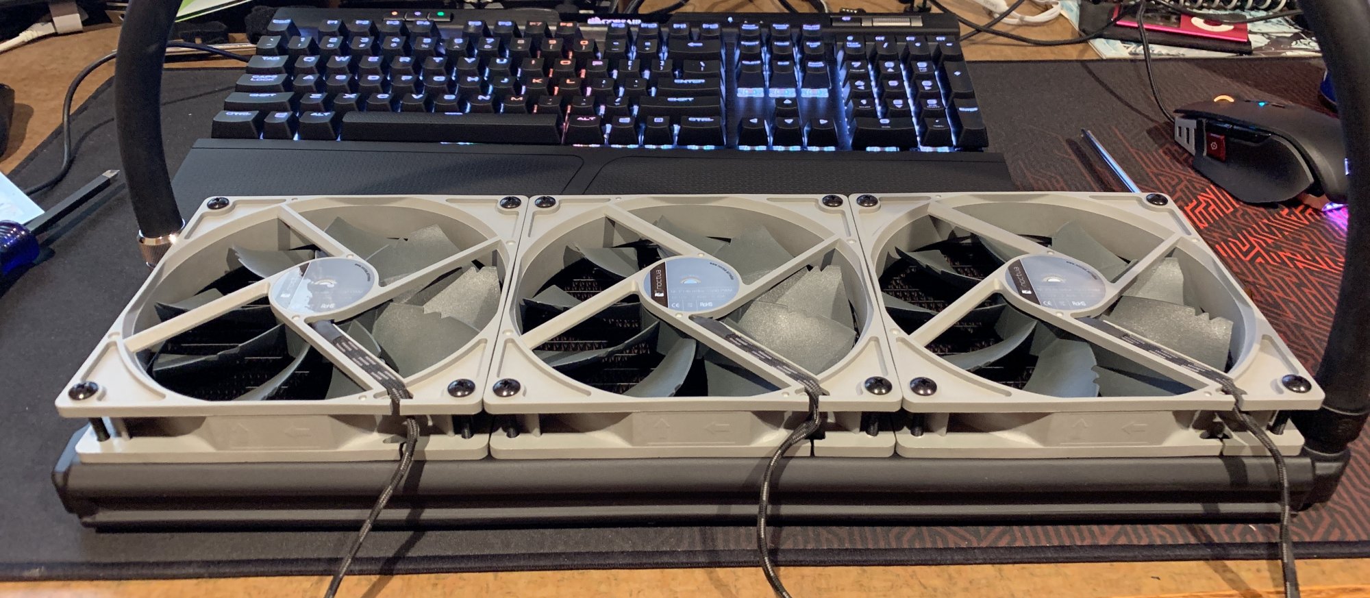

I'm in the process of fitting out my case fans. I wanted to go with 6 Noctua 140mm grey fans (no RGB) in the Crustal 280 mATX/ITX case below, which takes two 140s in the bottom, two in the front, and two in the top. It would be nice to have white fans, but I couldn't find any quality, silent white fans. So, the next best thing was this lighter grey Noc fans.
Corsair Crystal 280:
Corsair Page - mine is the NON RGB moel shown above.
Here is the Noctua fann x6 I want to use:
The picture doesn't do them justice. They are very nice colored fans, very "in the background" and built like tanks, sleek, and the fan and carriage are -when viewing them in person - more offset in their grey/dark grey color (dark grey fan, light grey carriage) Anyway, they look better live.

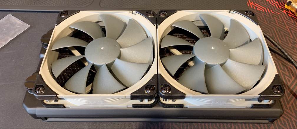

So the problem is for the bottom I have to flip the fan over because the airflow is from the picture to the rear. In front, no problem. In top, perfect because you can see them from the top as they are pictured above. But in the bottom, I have to flip the nice side down and then then the fan's wires and back fan area is exposed, which is so not hot. Other than leaving the fans out of the bottom, what is the alternative?
BTW, that case is beatiful in person. When I got it, I thought the front was a little busy, but not I don't think that at all. It's a really sexy case. I would liekto get some white thumb screws for it, so if anyone has any links. . . .
Fan direction is fan direction unfortunately there is no way around it. I used the same fans in my build and I opted to sleeve the fan cables all the way to the motor. Another option would be to put fan grills on there to direct your eye away from the back.
Here's some examples:

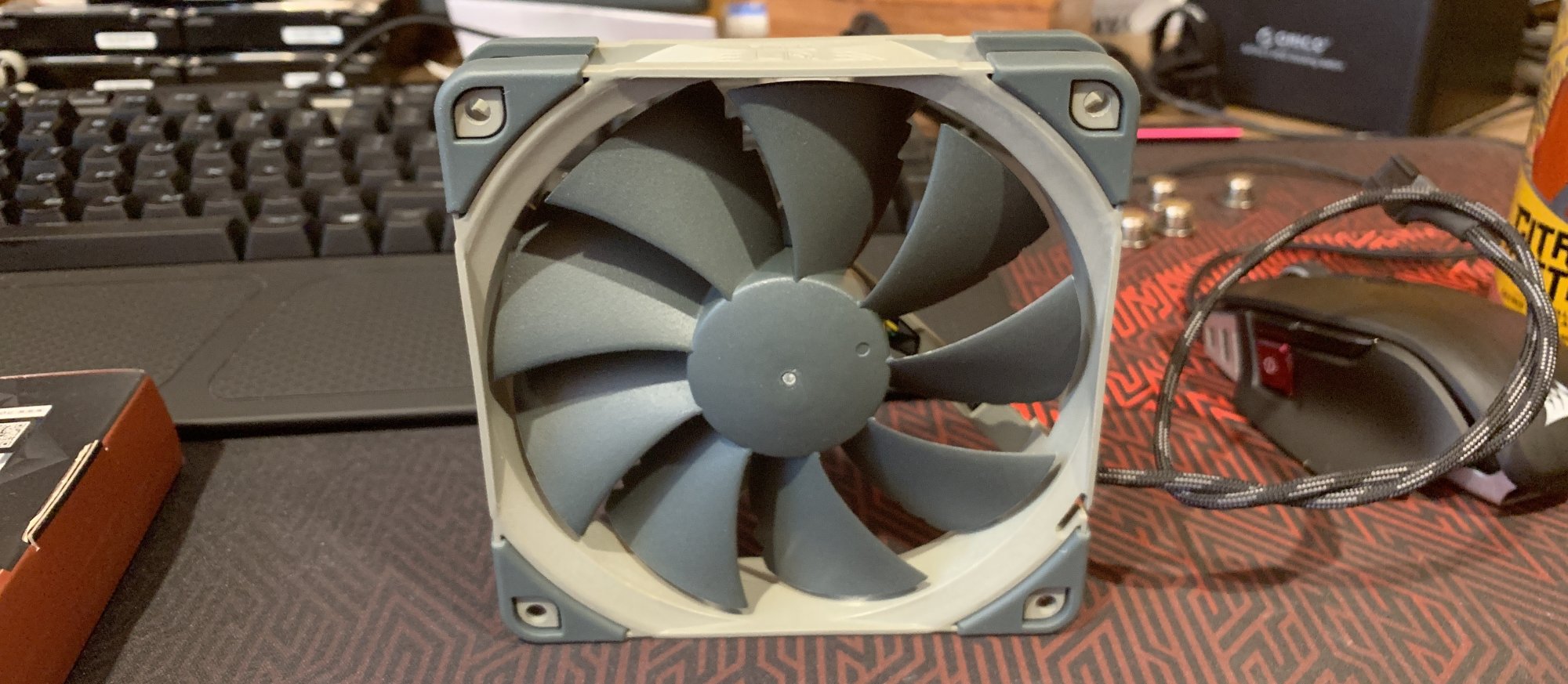

I also went with the grey corners over the black, here's a shot of each:
View attachment 226434View attachment 226435

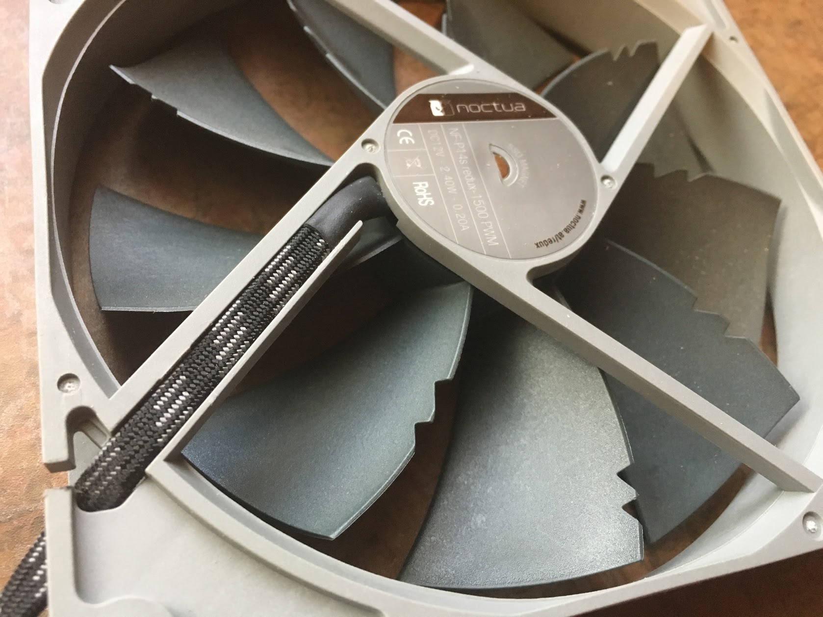

How did you sleeve those wires going into the back of the fan?
I pulled the stock sleeving off the wires and then just pulled the wires up out of the frame. Then I cut my paracord to the needed length, applied some super glue to the wires close to the motor, slid the paracord down over the glue and waited for it to set. The shrink wrap is there mostly for a visual it doesn't actually hold the paracord in place, hence the need for the super glue. I removed the one tab that holds the wires down and opened up the opening a bit to allow the now thicker wire with paracord to pass through the frame. Dropped a little more glue in the wire channel and pulled everything tight.

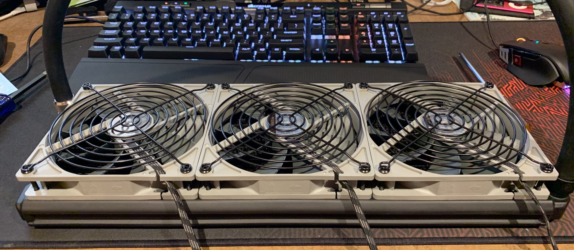

You might want to consider 3D printing some fan shrouds. (What I plan to do when I next upgrade). Would be relatively easy to design/print if you have access to a 3D printer. (If not, get one - they aren't all that expensive these days and are great for stuff like this. (Example)
I'm still a massive fan (no pun intended) of Nidec Servo GT 1850s when it comes to radiator fans. They simply are one of the best fans out there for pulling/pushing air through a rad. (I've got quite a few 1850s in a push/pull config in my PC that are going on almost 9 years now and are still running solid without any issues - they've carried over through 3 major motherboard and 4 GPU upgrades.) The 1850's simply have a great low noise profile and fantastic static pressure which is what you want in a good radiator fan.
Anyway, some added benefits of using shrouds is that they help eliminate dead air spots on your rad (around motor hubs), reduces air turbulence/noise a bit, and help maximize airflow through your radiator.
I'm still a massive fan (no pun intended) of Nidec Serve GT 1850s when it comes to radiator fans. They simply are one of the best fans out there for pulling/pushing air through a rad. (I've got quite a few 1850s in a push/pull config in my PC that are going on almost 9 years now and are still running solid without any issues - they've carried over through 3 major motherboard and 4 GPU upgrades.) The 1850's simply have a great low noise profile and fantastic static pressure which is what you want in a good radiator fan.
LOL, Nidec Servo GTs! I have 4 of those 120mm 3 pin versions back when they were sold by Sycth. Those are absolutely amazing fans. The blade design was new to computer fans back then, but now many fans looks like the GTs, with their extremely close frame tolerances and cured, scimitar like blades. If you spin one of the GT 120mm 1850s full speed, you can surely hear it, but it is a low pitched, almost bass like brrrrrrrr, instead of a whine. As far as a shroud goes, sure. Back with my old x58 OCed system, I took a Cogage tower cooler and modified it with alimunin tape to make a shroud so no air would leak around the fan or out of the fins, and would have to exit through the fins all the way back through the cooler.
That being said, the Noctua fans are pretty comparable, and maybe a little quieter.

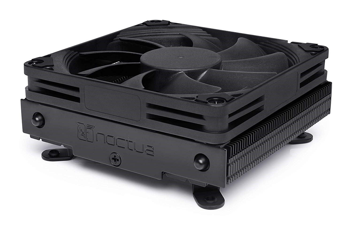

Noctua NH-L12S
Ok, so that case I'm using has a limit of 150mm on a cooler. My RAM is the Gskill Trident RGB, which is 44 mm / 1.73 inch. The clearance under that Noc cooler is 48mm. It's actually 45mm but I guess once you put in on the CPU, it raises it 3mm.
"Run with the NF-A12x15 fan installed on top, the NH-L12S provides extended clearance underneath the fin stack. This way, it is fully compatible with chip-set coolers and RAM modules with heat-spreaders of up to 48mm in height."
So, yeah, after spending more than a week looking fro compatible cooler that will fit, is efficient, and aesthetically pleasing, I think I am going with this one. I want to mount the white beQuit 120mm fan on it, even though that particular model is a case fan. With the speed reducer, the included Noc fan is about equal to the beQuite fan as far as pressure and moving air. So, it's not going to cool any better, just look better. It's not a great cooler,but it's decent. I'd like it in black, but it is what it is. It should cool the stock 3600 better than decently, and with teh beQuite white 120mm fan on top, it should look decent too. I'd probably rather go with a 150mm tower, but they are hard to find.
Now, this one is a good cooler, but they want 70 bucks for it, and then I have to buy another fan to get away from the Noctua dental office brown. It could fit in my case too.
NH C14S
I have it narrowed down to one of two choices, the Cryorig M9 92mm tower or the Noctua 120mm downdraft, unless there are any other ideas.
Cryorig M9 92mm, $35.00 free shipping on Amazon Prime and have it Tuesday.
Link
Noctua NH-L12S $50.00 have it tomorrow free Prime
The Cryorig will be a lot cheaper because I will have to replace the ugly Noc fan, and that will increase price another 20.00. So it becomes a rather expensive cooler. However, with the new fan on top looking into the side glass panel, it will look very nice. The Cryorig is pretty much ready to go. The fan is decent, although I'd like a white option. The top cooler plate is nice, and I can paint that white with absolutely no problem.
I've been seeing mixed reviews about how it cools. Some say it doesn't do any better than the Stealth stock cooler and some much worse than the Prism. The Noc cooler is much more quite. I'm still thinking about it. :) It is their best looking cooler.
I just know that either that Cryorg or the Noc L12S will cool better and with a nicer looking fan sitting on the LS12, it should look pretty decent. The Cryorg mini tower is lso quite and cools very well. I'd probably paint the top cooler cover white, and be done with it. If that Cryorig was a black tower option, or even better, a white option, it would be a done deal.

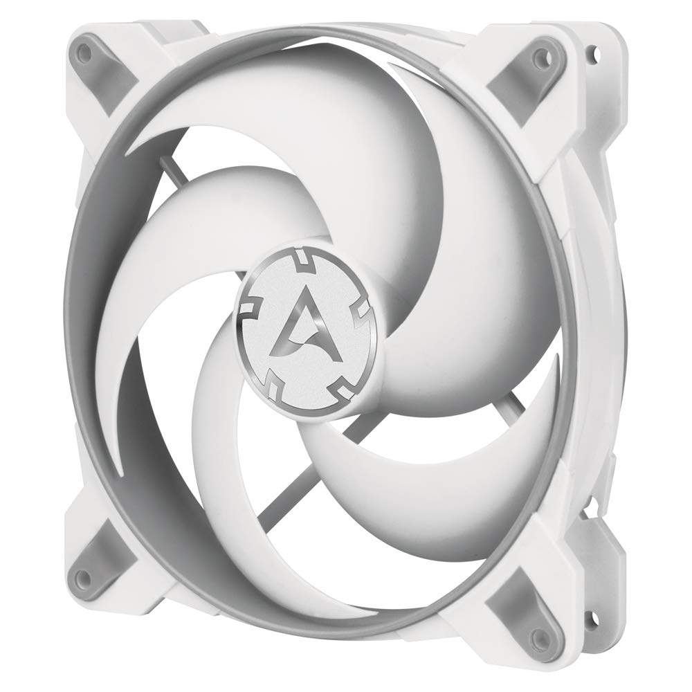

Is this the same fan? It moves a lot of air, due to it's max RPM, which is 1950. How's the noise on it?
Arctic Bionix P140
I wanted to ask pendragon a question about that Artic fan he posted, as they are good air moveres for vcase fans, and they have some nice looking fans. Not built like the Noc fans, but okay. Pricey, again, though. (I'm going to be looking at my rig for a very long time, so I want to get the aesthetics right.
yeah they move a good amount of air, the 120s push ~56cfm and the 140s push ~73, both at ~23db.
Arctic Bionix P140
thats the same base fan tech but a little higher cfm(and rpm) at ~78cfm and and a bit higher noise at ~24db.
edit: the noc redux 140mm is ~78cfm at 1500rpm and ~26db. since it looks like youre looking at 140s. oh and theyre $30CAN a piece! thats an expensive fan.
i found a side by side, just picture white and grey. looks like the cable is sleeved too on the bionix.

I use Noctua fan in my case, could they be prettier? Sure but they make up for it and price per performance plus in a retro case they don't look half bad.
It's true. You can't beat them for efficiency all around and long MTBF, which is 150,000 hrs! However, Arctic's Bionix new P and F series fans now have a better warranty than Noctua at 10 years!
After researching this fan, it may be better than the Noctua, or at least mechanically, electrically equivalent.
Fan: P140
140 mm, 200 - 1.950 RPM (Controlled by PWM)
Air Flow:
77.6 CFM / 131.92 m³/h (@ 1.950 RPM)
Noise Level:
0.45 Sone (@ 1.950 RPM)
Static Pressure:
2.85 mm H2O (@ 1.950 RPM)
Just bought the Arctic P140 for the L12S cooler.
Should go really well with my all white case. Nor cheap: $16.20 includes shipping. This is what they call their pressure optimized fan, which puts out lower CFM than the F model, which is for cases.

My 120mm Noctuas are butt-ugly so I made covers for them to hide their hideousness. I have some of their black Chromax fans and I like them
When someone calls my Noctuas ugly I respond with"they just got character" 😂
